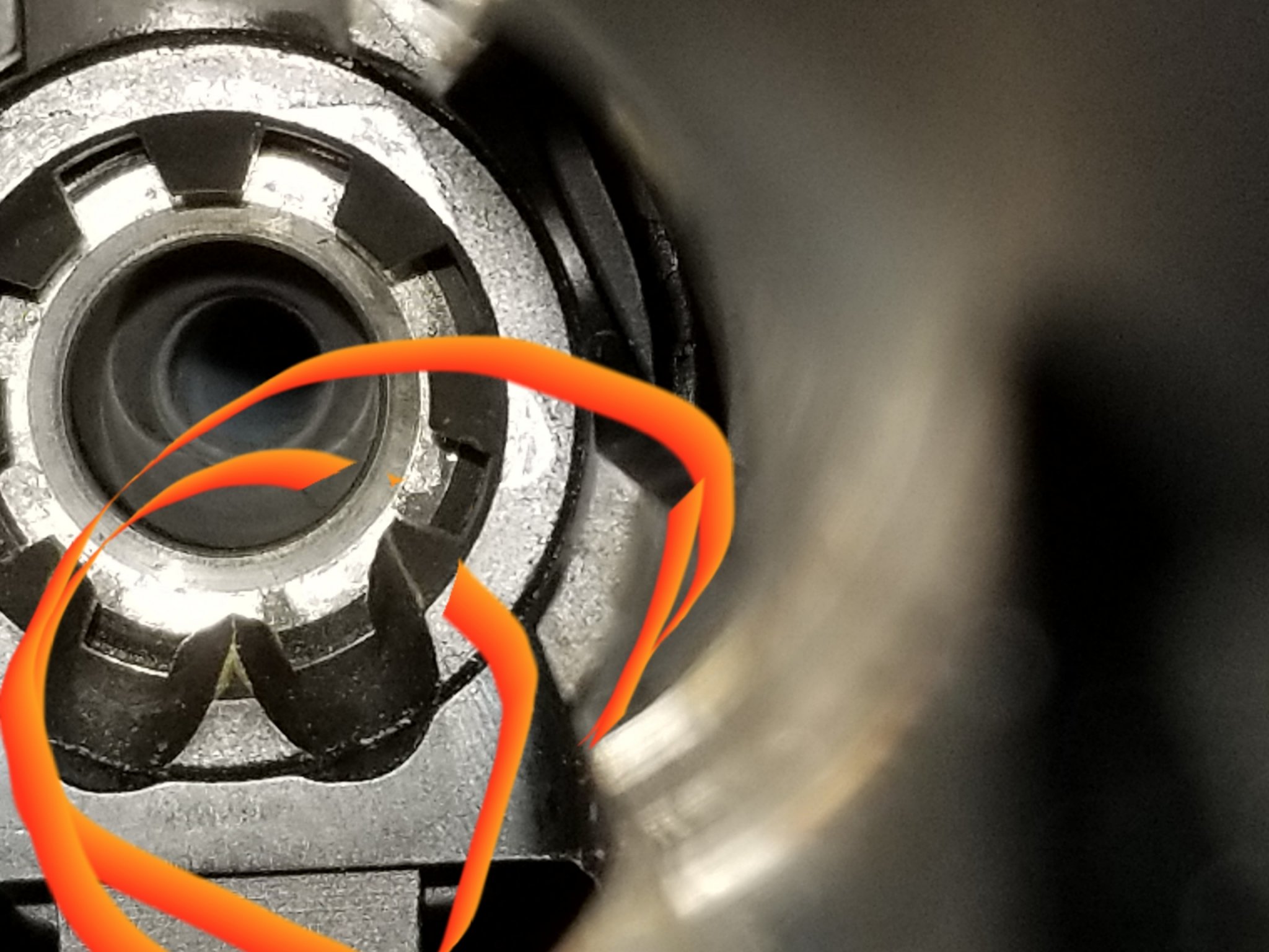

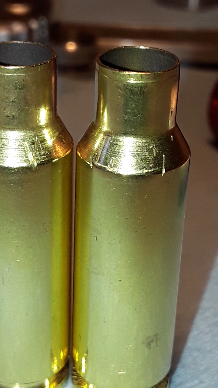

This is what I got from midway's stoner barrel.
Was just under 1 moa with hornady 123 sst and was happy until I looked at brass.
Deep cuts.
Like a razor.
It's the feed ramp on the barrel extension going to try and smooth it without disassembly.
Deep cuts.
Like a razor.
That is really a builder fix. Most barrel extensions are made by the same 3-4 companies and they are all sharp. Some scratches on the necks and shoulders happen when the ejector pushes the case to the right so they flip out of the port door. Take a dremel with a 3/16" chainsaw sharpening stone and run between the extension lugs at 2:00 when you do the ones at the bottom.
