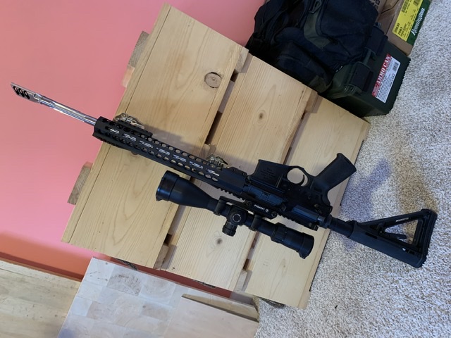

    Rainier Arms fluted ultramatch is what I have on my grendel, shoot lights the fuck out but it's heavy. Any chance I get to give RA my money I jump on, but it is a pricey barrel for just hunting. Worth considering all the same perhaps.
    Love RA! what length is your barrel? They only have 18" on the site. I have an 11 pound ar15 stag varminter that I lug around to coyote hunt. weight is not a problem lol. If ammo ever comes back to pre pandemic levels Ill be plinking targets with it like crazy.

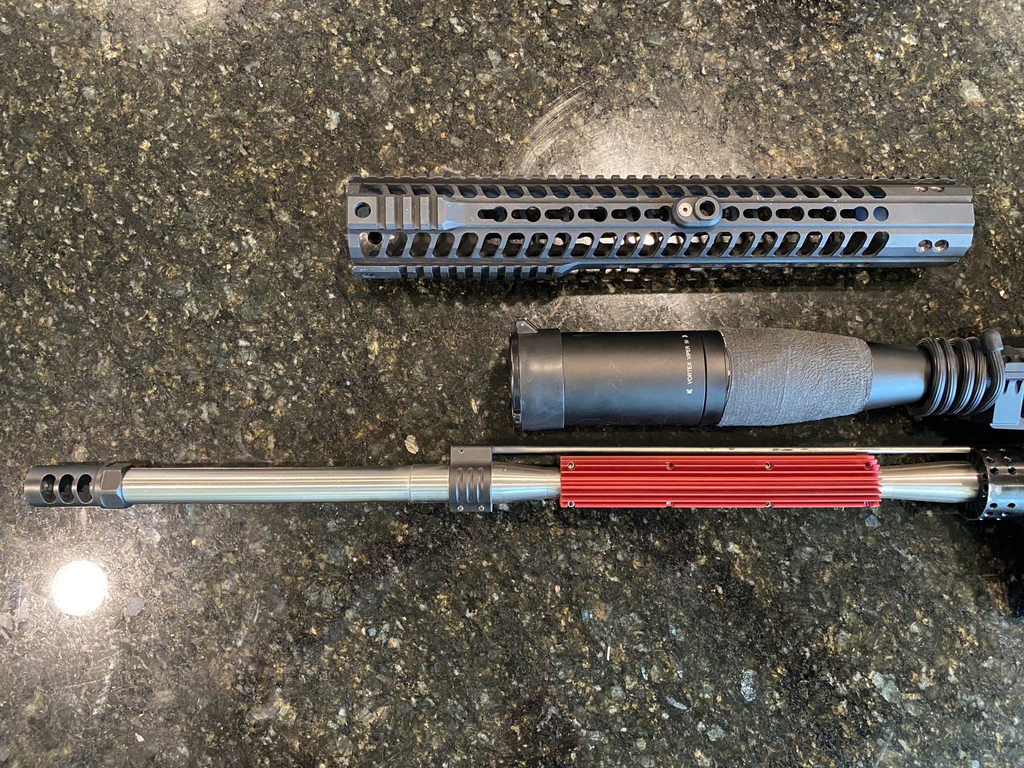

    I’m a fan of JP 6.5 Grendel barrels. I’ve got an odin works that is on my deer gun. The JP is on my match rifle. Both are sub moa. The JP is more sub moa-er. I get 2450 fps from Hornady black 123 gr ammo from the 18” odin. The 22” JP is right at 100 fps faster. Both will smack deer, but the odin is lighter and handier...
    Do you have a pic of the JP without the Handguard? JP makes nice stuff but it seems like all their barrel contours are made to use the heat sink.. does yours have the heat sink?
