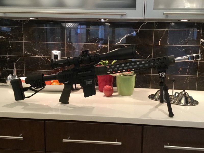

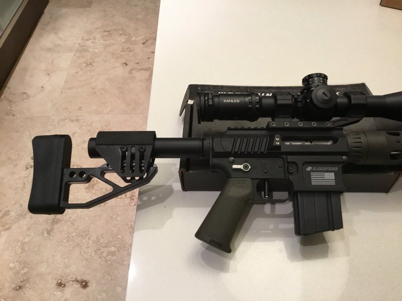

    Here's my JP - FMOS bolt, medium contour barrel, roller trigger and an XLR stock. I also have a 5th shot flier issue - I think it has something to do an empty magazine - it's always on my last shot. I only shoot factory - Hornaday AMAX and ELD M.

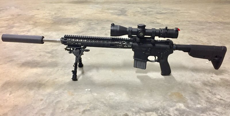

    She is done for now. I am waiting for the E-Lander mags to come back in stock. I still need to pick up a dead air muzzle break/flash hider and keymo adapter. She is a constant 0.5-0.75moa shooter.
    Upper:
    BCM M4 complete but stripped upper
    Ballistic Advantage Nickle Boron BCG
    JP 6.5 Grendel Bolt
    Raptor Charging handle
    BCM 13" KMR
    Superlative Arms .750" Adjustable Gas Block, Bleed Off - Solid, Melonited
    JP Supermatch cyro 18"
    SilencerCo Hybrid
    Ergo Keymod Bipod adapter
    Harris Bipod with DSG arms lever
    Seekins Melonited Rifle Length Gas tube

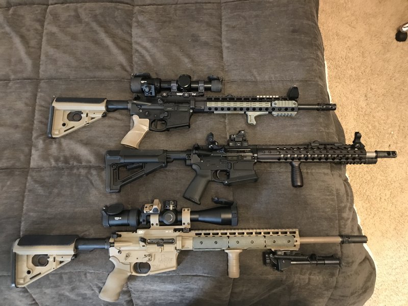

    I wish mine was done, I'll post it up if this thread is still running when I finish it. The rifle is complete, I've been shooting it for a year, but I sent it off to my gunsmith to get cerakoted..
    Nice looking rifles fellas..

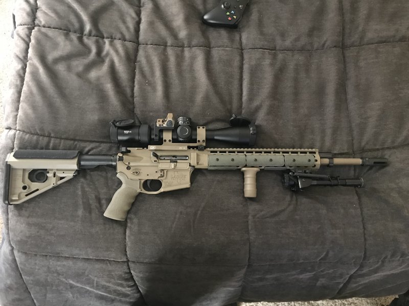

    Started as a Larue Grendel
    18" Craddock Precision Bartlein Barrel
    Surefire Warcomp
    Now has a POF Dictator gas Block
    Geissele DMR Trigger
    PST Gen 2 3-15
    JP Full Mass

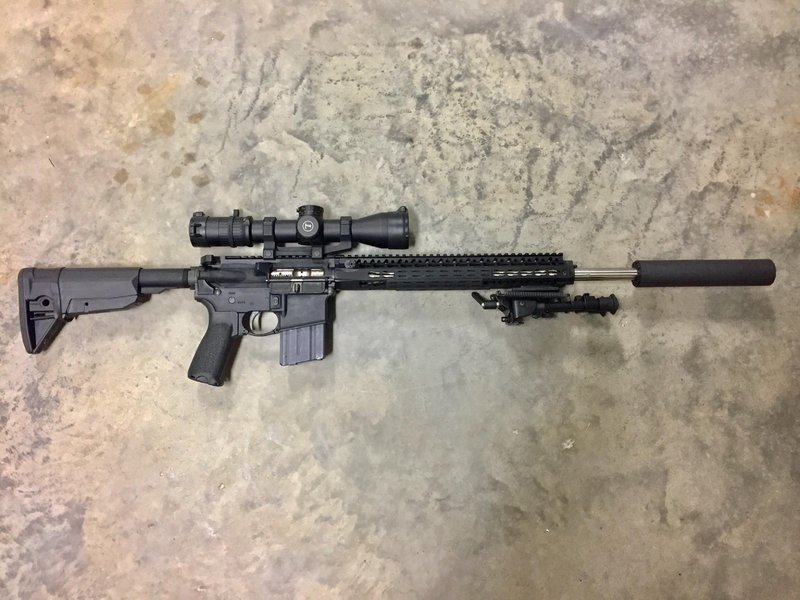

    Noveske Gen I lower with BCM LPK
    Geissele SSA-E trigger
    PRS stock with monopod
    Elander mags
    Noveske marked Vltor MUR upper
    Noveske marked Geissele super charging handle
    Sionics NP3 coated BC with monster bolt
    16.7 Noveske NSR handguard
    SLR sentry 7 adjustable gas block with black gas tube
    Faxon 20" 6.5 Grendel barrel
    VG6 Gamma 65 muzzle device
    ADM 20 MOA QD scope mount.
    Atlas Bipod BT46-LW17 PSR
    Vortex Viper PST gen II 5-25X50 FFP scope
