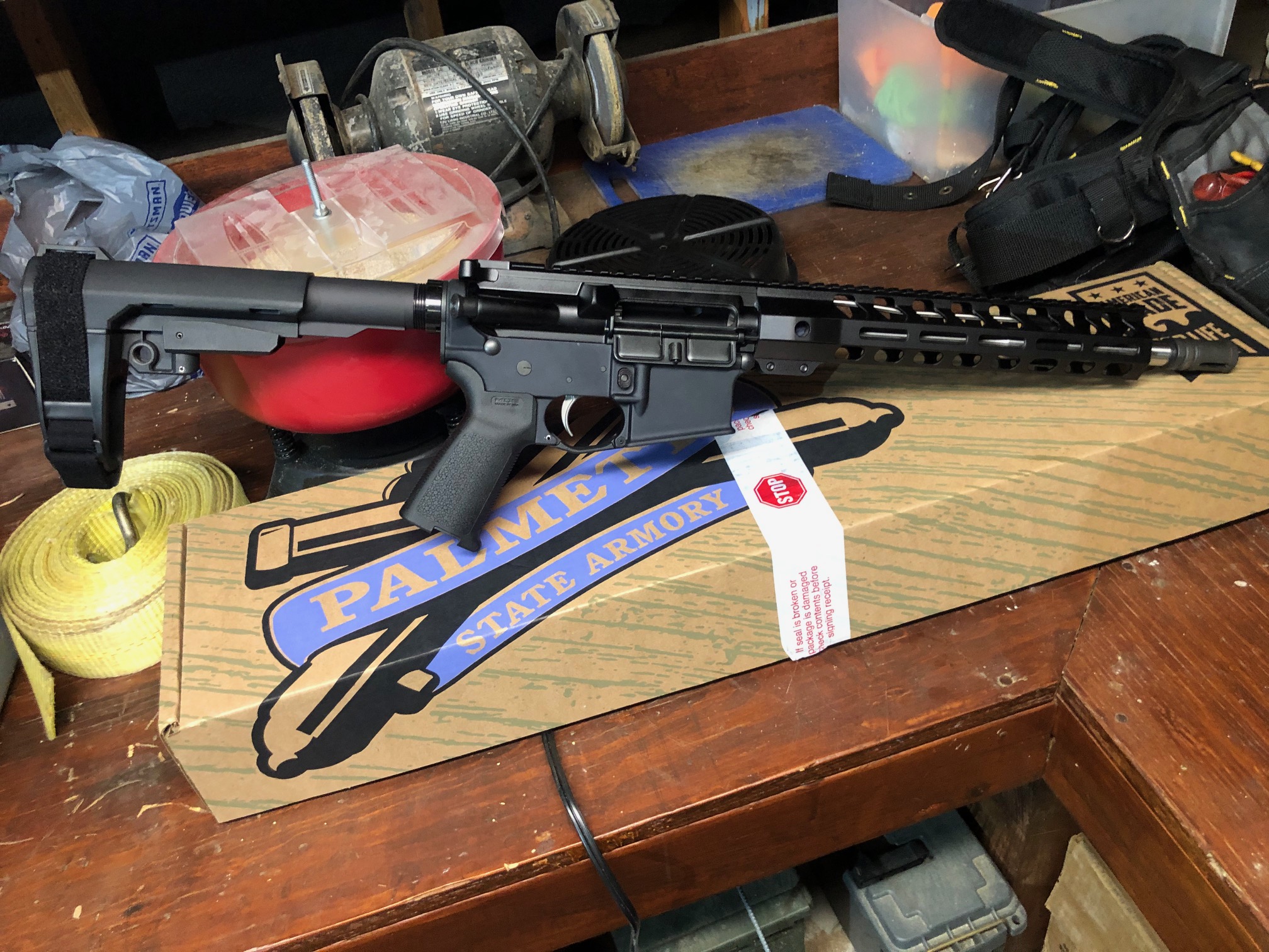

About two years ago, a good friend of mine introduced me to the world of custom rifles, suppressors, scopes that cost more than $200, reloading, and all of the other stuff that goes along with this hobby. I now reload for my bolt guns, own a can (two more in jail), nice glass, a full custom bolt gun, etc. I haven't really dove into the gas gun world other than a M&P sport I've owned for about 5 years.
I have another group of friends that I hunt with on a regular basis in south texas. Our hunting trips consist of lots of debauchery (drinking, tannerite, drinking, gambling) and a little bit of hunting. Several of them own factory 6.5 creedmores and I have taught them how to shoot out to about 400 yards. They do not think it is fair when I constantly win our shooting competitions with my 16" .308 rem700 5R, and especially not with my full custom 300 winmag built by Roberts Precision. They do have a point so I decided to go off and find a cheap, compact, relatively shitty gun that I can still show them up with ease.
Along with the aforementioned criteria, it also had to shoot good with factory ammo, be more capable at handling wind than a .223, and be used for shooting pigs and the occasional whitetail.
I went down a rabbit hole one evening a few months ago reading about a 6.5 grendel pistol and the ballistics/capability of the caliber, even in a 12" platform. I scrounged up my pennies and purchased a PSA 12" grendel pistol kit to go with a cheap anderson lower I had laying around.

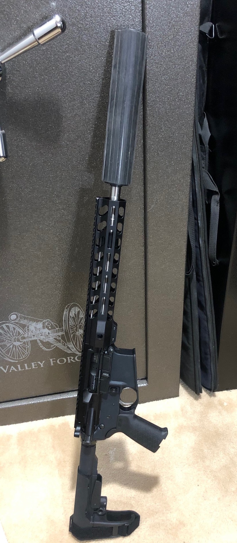

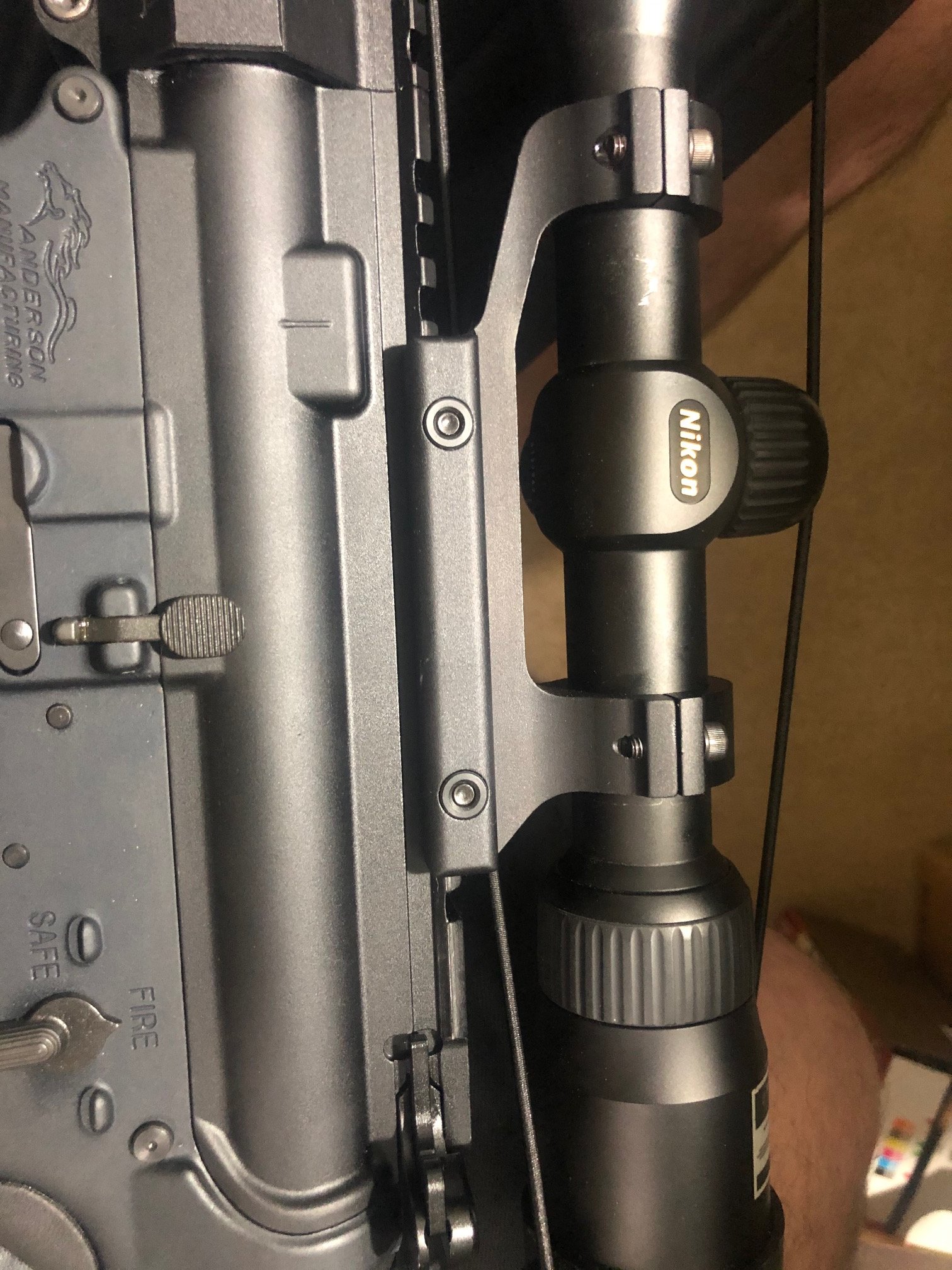

Here are some pics of the gun assembled with my high dollar Nikon scope and a pic with a can on it:

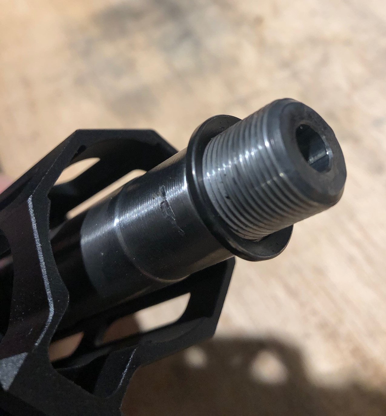

My buddy, who know a heck of a lot more about gas guns than i do, suggested that maybe the barrel nut was loose or something was wrong with it. He owned the tools and offered to help so I sent it home with him one day after work. After further examining the gun, he found where there were burrs at the end of the barrel, where it had been cut, crowned, and threaded from PSA.
Might be hard to see in the picture, but sure as shit he was right! I called PSA and they were awesome and sent me a shipping label to fix the problem. But, they did say it may take 2 weeks to get it back to me. Welp, my impatience took over and I wasn't going to wait two weeks. I had a miniature file thing laying in my tool box that I inherited from my dad (he was a machinist by trade) and I was going to fix the problem myself.

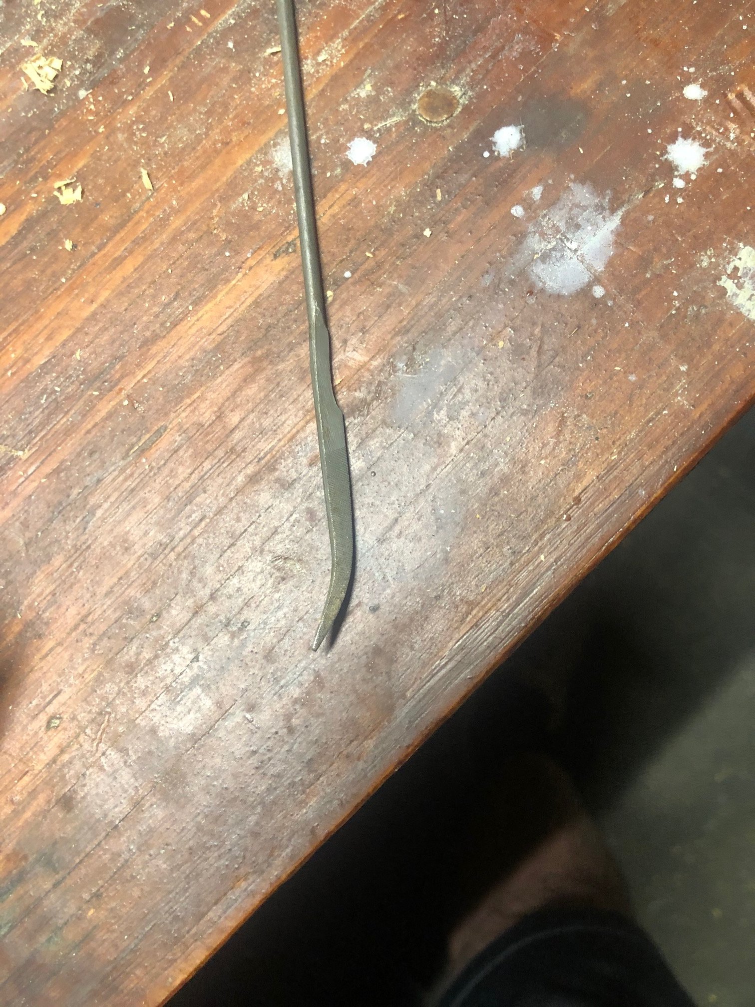

File thing:
I ended up performing my DIY hillbilly fix without having to waste two weeks of my life, wondering what to do with myself because I could not shoot my grendel.

Even though I've been preaching cheapness, I hate factory triggers so I splurged and ordered a La Rue trigger for this badboy. Future plans include a camo spraypaint job, and a sub $200 exposed elevation turret scope. Stay tuned for the barrel filing results.....
WARNING: Do not attempt any of the DIY gun smith work that I have performed or will perform in subsequent posts. It is extremely dangerous and caries the risk of damage to the weapon, yourself, others or potentially death.

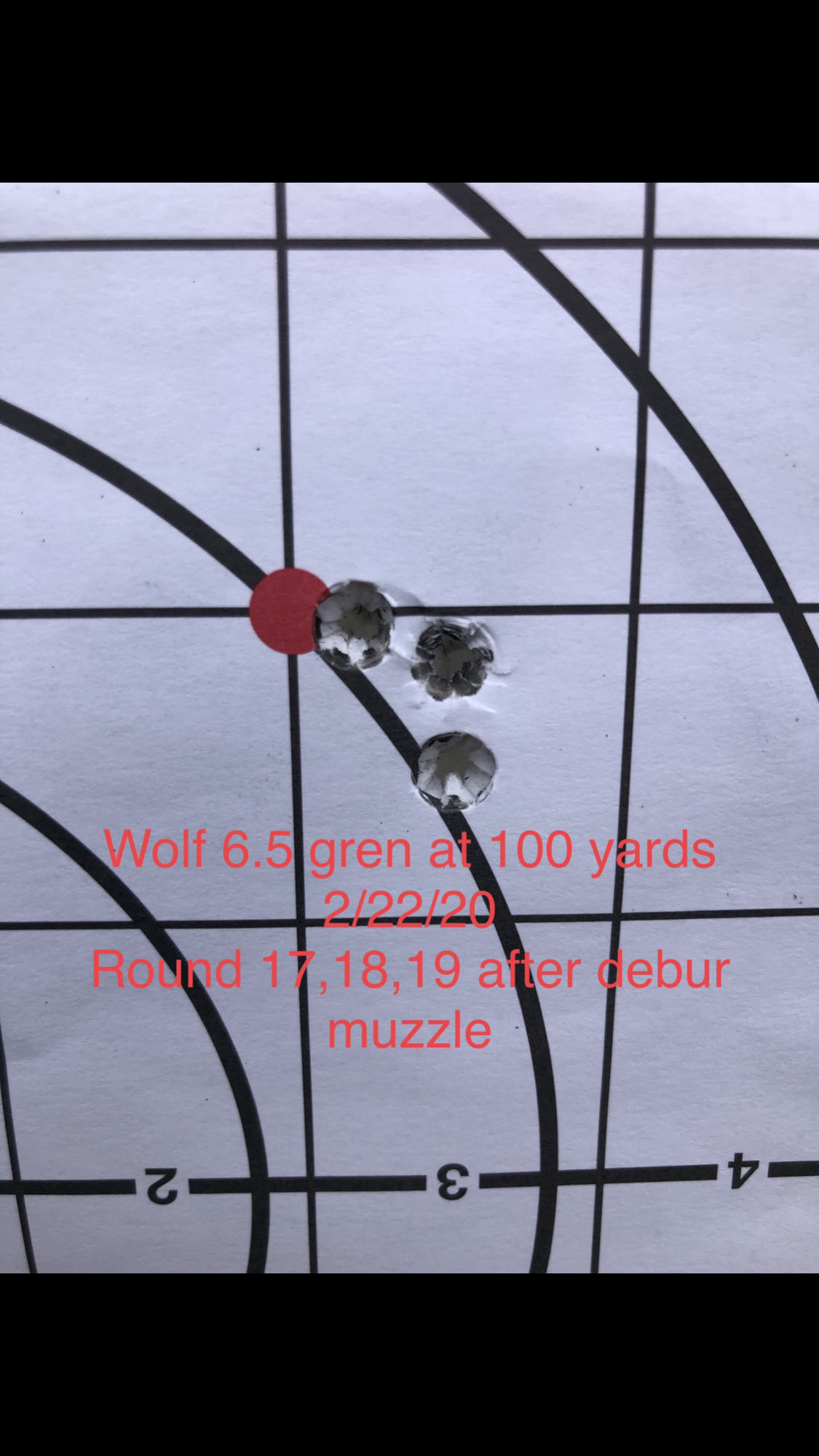

It was getting late when I wrote the first post last night. But here are the results from using the file to debur the muzzle. I used Wolf shitty ammo to go with my shitty build, and I bought some high dollar hornady black ammo too. These groups were at 100 yards.
what’s really cool is that group is with steel cased ammo and I would say it’s close to .5”.

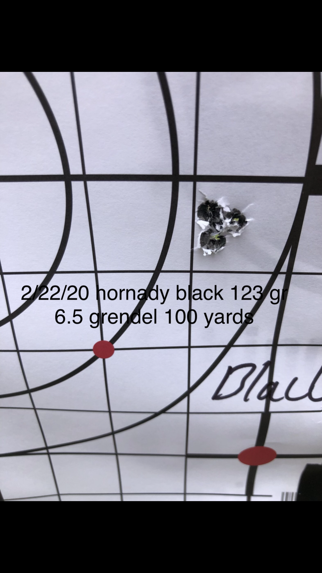

with the high dollar hornady black ammo, I had a group that looked even better:
I’m shocked with the results considering the length of the barrel, the cost of the rig, and my overall marksmanship or lack there of. It looks like I’m well on my way to schooling my buddies with my shitty gun.
