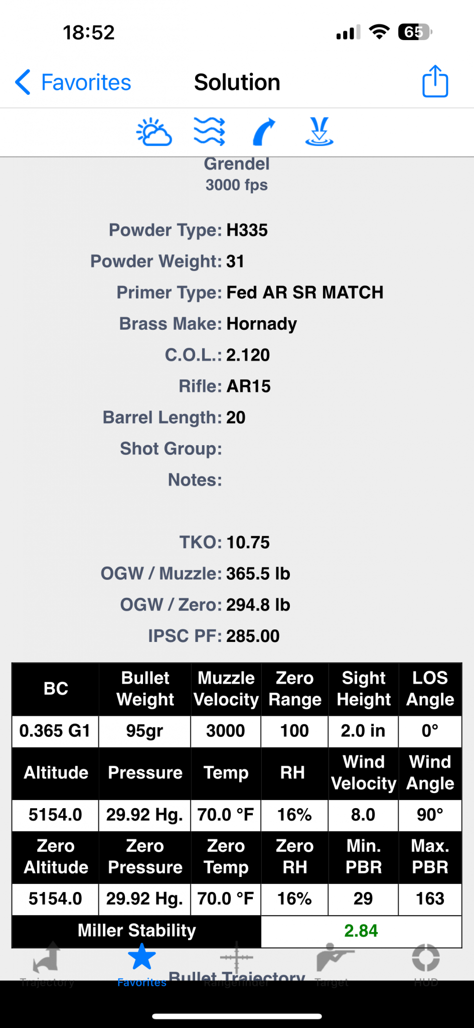

Thought I would share (brag) a bit about this in the reloading section. You might not believe it but it is true. My wife’s father (who was my reloading mentor) didn’t believe me either. He said there was something wrong with my chrono so he put his magnetospeed on my barrel and my chrono up and it reached 3004 fps multiple shots.
This was from my bear creek arsenal 6.5 G upper. 6.5 Grendel, 20" Black Nitride Heavy Barrel, 1:8 Twist, Rifle Length Gas System the bullet is a 95 gr Hornady vmax
