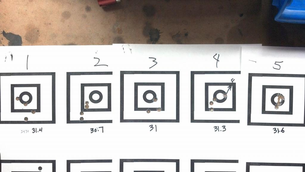

I finally got out to the range and do some chrono and OCW load development..Hopefully the reloading gurus can give me some insights..
The rifle is a newly built Lilja 319 (19") barrel
Loads are:
123gr. scenar
hornady brass
Leverevolution powder
CCI 450
Loads were 30.4gr.,30.7gr,31gr,31.3gr,31.6gr.
no crimps
2.255coal
sunny day at 70deg and the chrono is the Magnetospeed V3
Point of aim is dead center of the circle......All rounds were done round robin..left to the right then right to left ...back and forth 4 times
30.4gr,.
2464
2472
2475
2470
Ave 2470fps
30.7gr.
2496
2495
2475
2502
Ave 2492
31gr.
2506
2491
2503
2516
Ave 2504
31.3
2538
2514
2512
2526
Ave 2522
31.6
2538
2524
2553
2544
Ave 2539
I'm kinda new to the OCW..I have been doing ladder for years..I don't know whats the deal with the velocities on 31.3gr.
Loads were compressed on 31.3 and 31.6 but no signs of pressure.
I am thinking about just sticking with 31.6 and load it out to 2.260 and call it a day...
The verticle stringing is alittle issue buggin me
