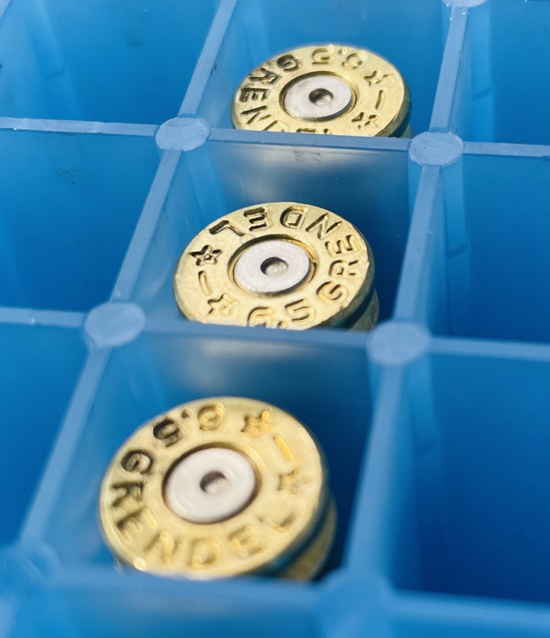

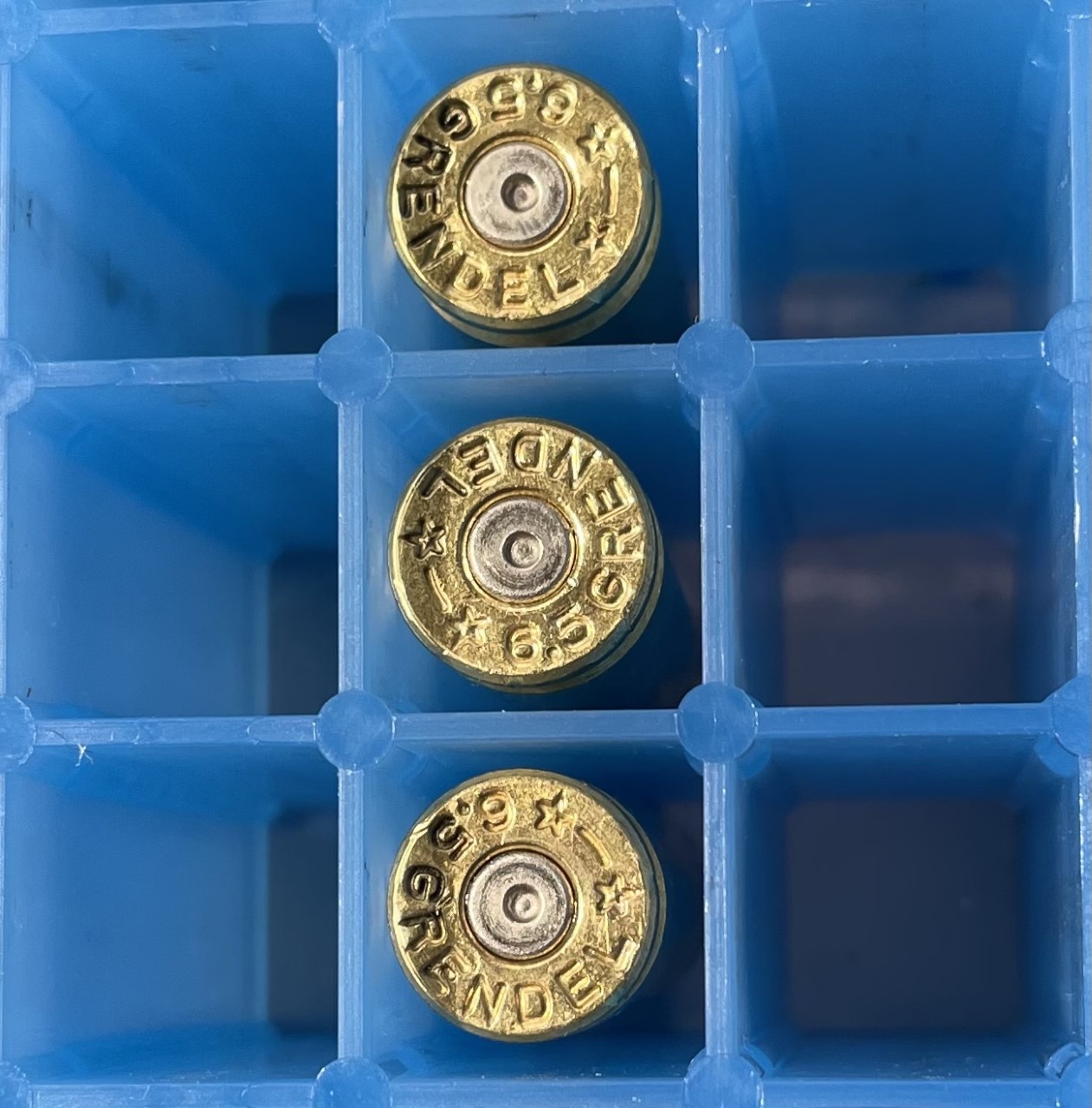

Looking for a little feedback on a few reloads I worked up for my 6.5 Grendel:
In the overhead shot are those rims bent or is that an optical illusion? They look seriously bent, which would mean it is extracting with significant pressure still in the chamber.
Rims are not bent, that is a shadow that is cast from the edge of the shell container.
Load was as follows: 129gr Hornady Interlock over 28.8grs of Power Pro Varmint.
Hmmm, I haven't used Power Pro Varmint, so I don't have any direct experience. Quickload doesn't list it, so I can't give you that data. Looking at what load data I do see for it, 28.8 sounds like it is hot (like around or just over max recommended pressure), but not outrageously hot. If it shoots well and you aren't seeing any other issues, you are probably o.k. I would be careful if you go to a much warmer environment, or do anything else that might push the pressure higher. And if you in fact are bending rims, something is wrong.
If it is an AR, you are just above max load of 28.4grs that Sierra lists. If it is a bolt, you could probably push it a bit more. Your primers look good and the rims look fine to me with no flat spots from the ejector.
Excessive pressures in a factory 6.5 Grendel AR will happen quite a bit before reaching the point where the pressure is evident from reading signs on fired cases.
