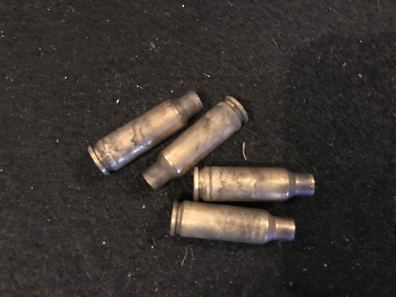

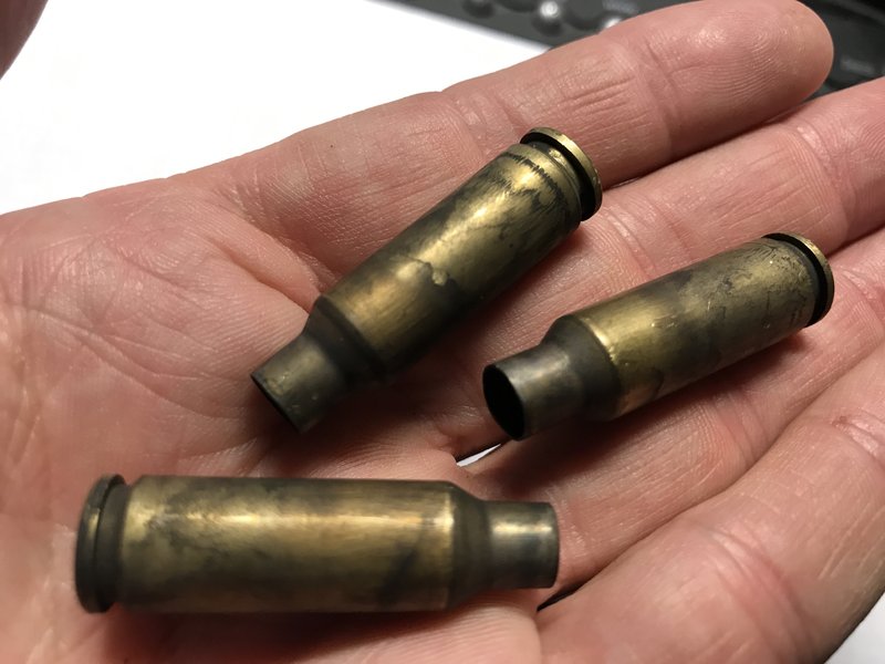

Hey guys looking for AR advice, so I cut my 6.5 Grendel's Lothar Walter barrel down to 18 inches (to be legal for team safari last year), it has rifle length gas, I've altered the pressure. It won't cycle unsuppressed even after John Paul told me at the match to try the lightest spring for the silent capture buffer spring, but it still doesn't work. Now with my thunderbeast ultra 7 on it, it will cycle but it's not pretty. I got an slr adjustable block and I've got it tuned to eject about right at 4, but man the brass is beyond dirty like caked on so I think it's overgassed not sure. I've tried both the light and heavy jp buffers and springs, have both. I'm shooting factory hornadys (til I figure this out), running a prs stock and a vltor upper/hand guard, kind of a pita taking off and on trying to figure this out before I just rebarrel it. I've been told to drill the gas port larger among other suggestions, and also something about plugging the hole and re drilling location? Not sure what that would cost (sounds sketchy) or if I should just re barrel. It's an accurate barrel so I'd like to run it suppressed but something's not right with the brass, my blackout brass comes out way cleaner with a can and I'm running pistol powder there. Any advice appreciated thks.
Could you post pictures of the brass? My Grendel brass comes out absolutely filthy when I shoot suppressed, much more than my 223.

Cant comment on the actual issues but my one note of observation- that looks like your chamber is all oily to me, the only time my brass has had those wavy smears is after cleaning that I didnt wipe the chamber dry on.

If you roll your own then you could try Vihtavouri powder to get a little cleaner. My 5.56 brass comes out nasty when suppressed, but not that nasty. I doubt you are over gassed if ejection is at 4 o'clock.
Ok, could be on that batch, I think I covered a clean chamber but I'll shoot some more tomorrow after cleaning. I already have some 4895, TAC, and AR Comp and some 123 hornady ssts I could try, haven't set up the dies yet.
To be honest, that looks only slightly dirtier than my suppressed Grendel brass. I do use 8208 XBR, which seems to be a fairly dirty powder. I don't know that you actually have an issue on your hands.

That looks pretty much like the brass out of my semi-autos when running suppressed. I had a piston gun that would soot much worse, the entire piece of brass case head and all would come out solid black.
