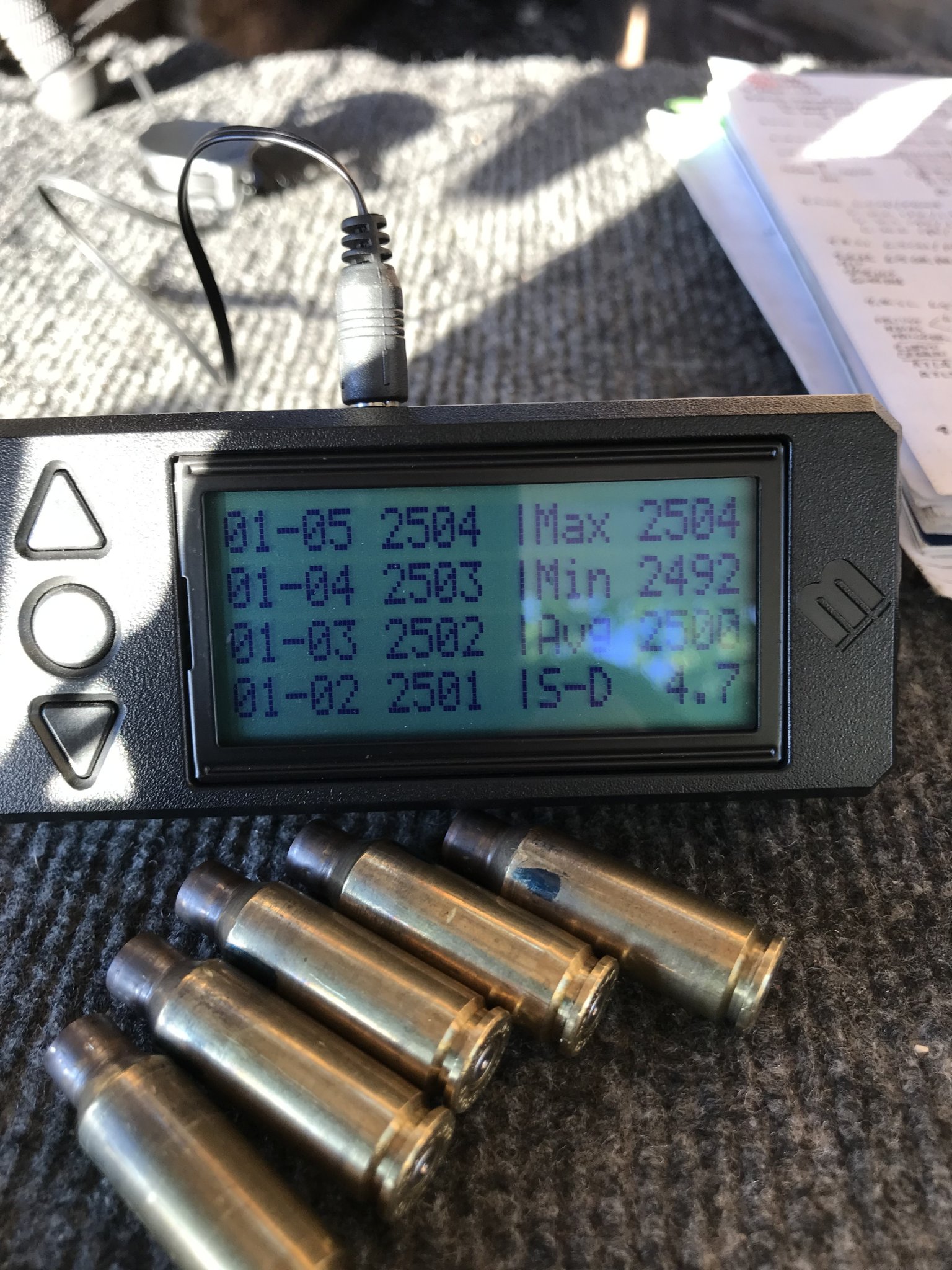

I had an 18” ba grendel barrel on an upper for a bit. I could have sworn ~2500 is what I got with Hornady American gunner, 123sst and 123eld. A 12” upper gives my ~2325fps with the same ammo.

I get 2475fps with my 18" Larue UU upper and a 123gr ELD-M over 28.5gr of 8208XBR. The same upper got me 2425fps with Hornady 123gr American Gunner.

I regularly get 2550 from several 20” Grendel barrels with 120 Scenars and AR Comp-would expect 2500 very doable with a correct chamber and good reloading process. These are from an 18” JP barrel.

My odin works 18” 6.5 Grendel chrono sat 2450 fps with Hornady black 123 gr bthp or eld-m. My 22” JP 6.5 Grendel chronos at 2550 with the same ammunition.
