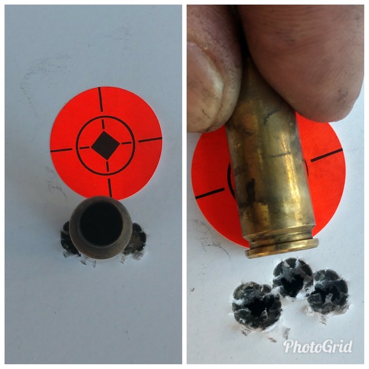

As long as I've been a member here you would think I would heed my own and many others advice, "buy once cry once".
Having built five Grendel uppers, have just not been satisfied. Three of the Saterns shot under MOA, one BA shot under MOA, and took a chance on a BCA just to see what you really could get out of a complete $300 upper which was a MOA shooter. Then #5 with a Lilja 319 barrel and shazam! Sub moa finally with factory 123 amax.

Jake must be admiring your persistence, as am I. My results, however, do not mirror yours. Of 5 barrels from 5 different manufacturers, 4 shoot like that or better-and I've lost patience with my AA barrel, after multiple tries with loads and receivers. Grendel is an easy caliber to load for with both excellent accuracy and good SD/ES numbers. I do-seriously-admire you keeping with it, your efforts finally rewarded.
Yep..... It's like arguing with toddlers on here, you spend thousands of dollars and countless hours learning the hard way and you try to help people out and they still go out there and buy cheap barrels or half ass their builds, and when they can barely average 2 MOA they blame it on the cartridge.
It's awesome when you see people like the OP stick with it and when the Stars finally align, and you see how the 6.5G can easily produce .25 - .50 MOA.... it's like Christmas every day when you go to the range.

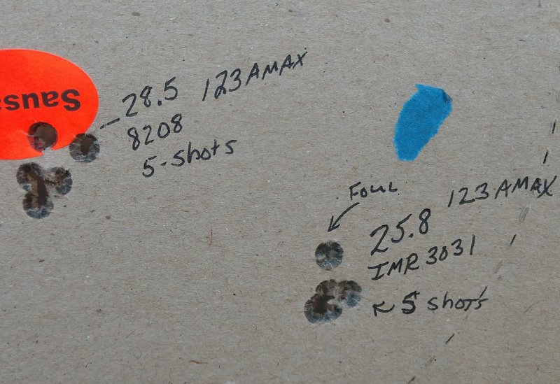

What kind of speeds are you getting with the 3031 load?

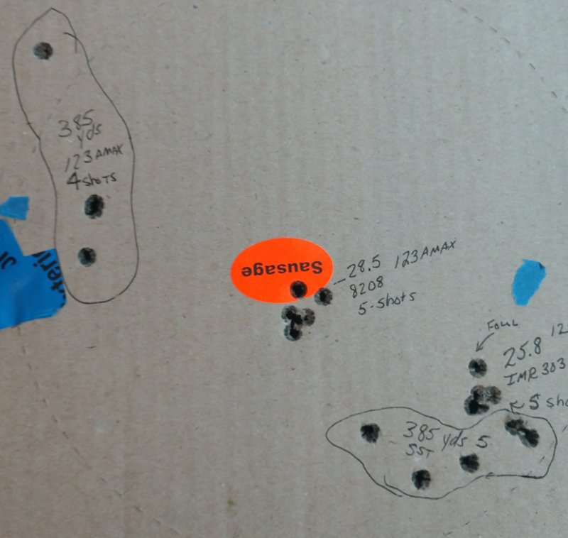

Just checked it, little slow but very accurate! Took it to 600 this evening with no issue. Loaded up a sst same load, right at moa 200yards. The amax is a laser with the 3031. Here is a pict of todays target with various loads and distance.
