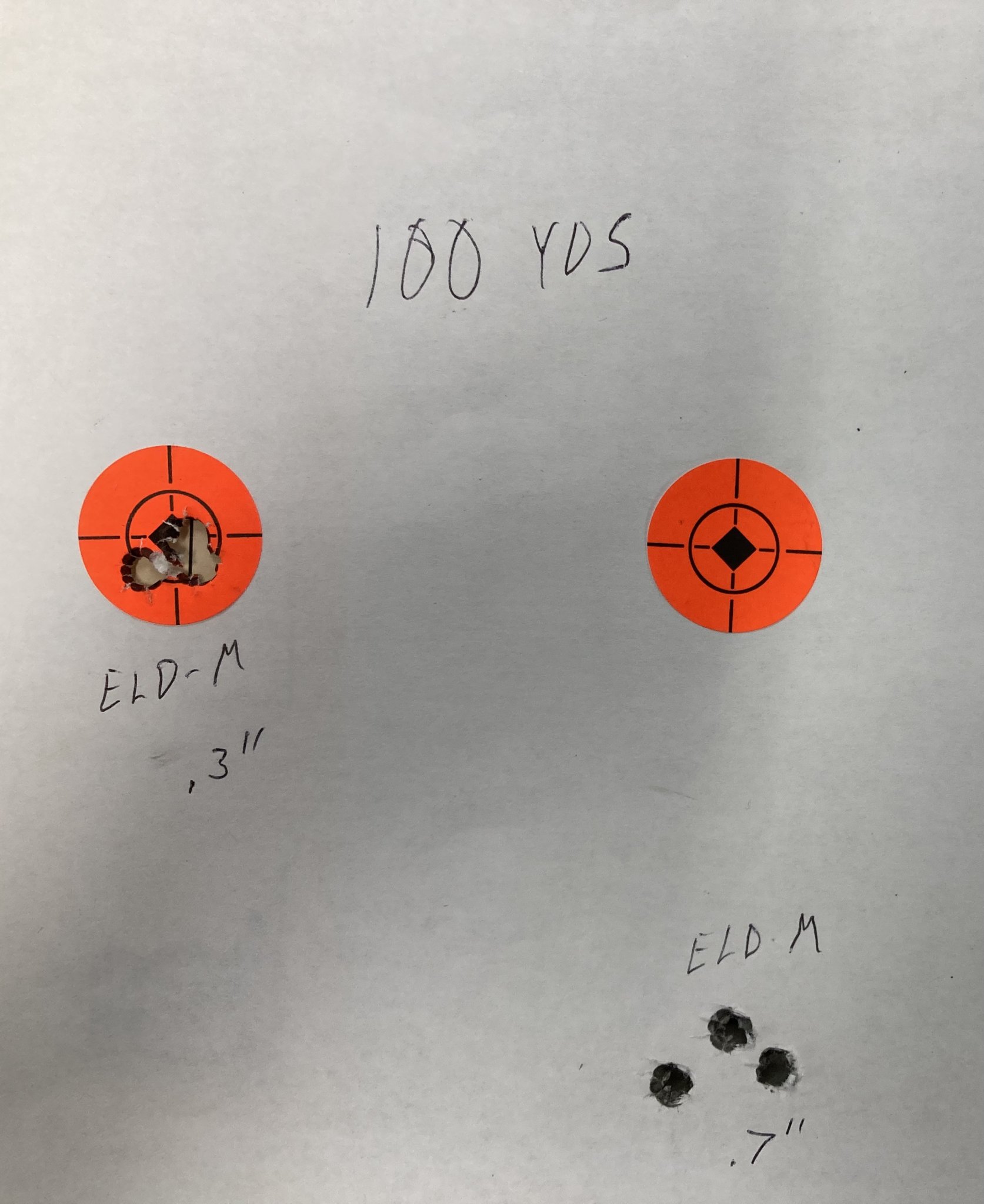

My 6.5 Gs are well past sub moa with Hornady match (why did you discontinue this Hornady?) and black 123 Eld-M and BTHP. But, they spray bullets like a shotgun with Hornady custom 123 SST loads. I'll second "picky" on bullets. But, its not the cartridge that holds me back in PRS comps- unless they stretch out past 900 yards.
