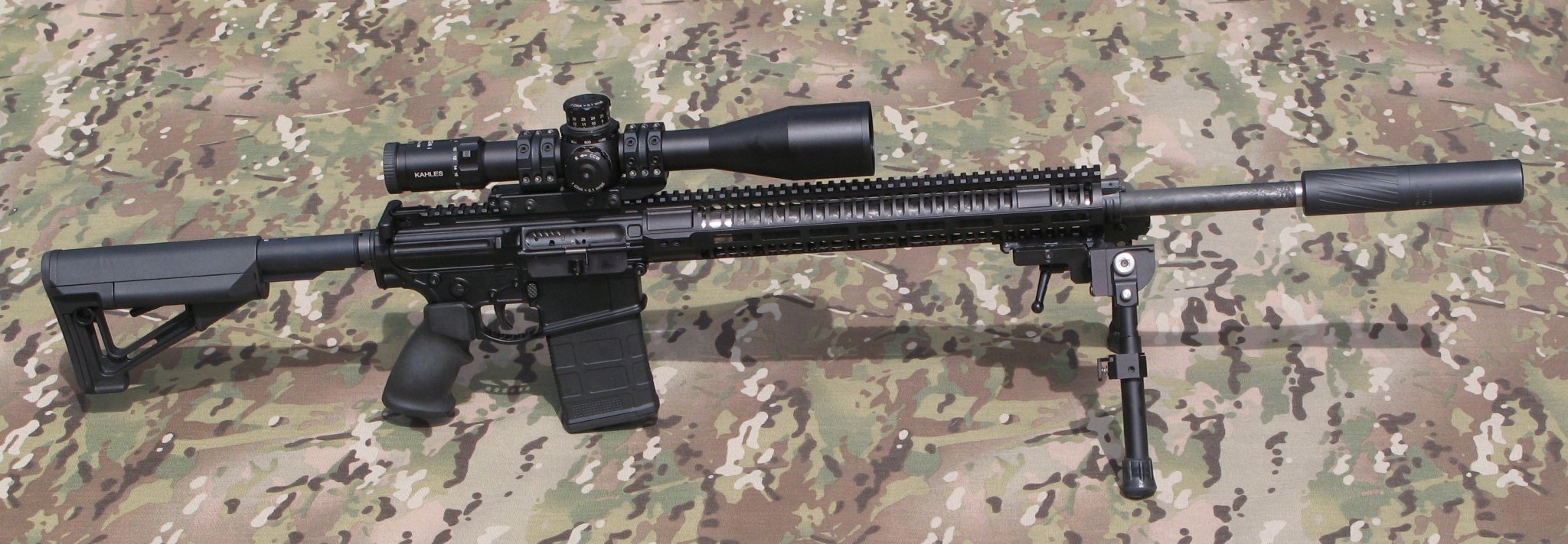

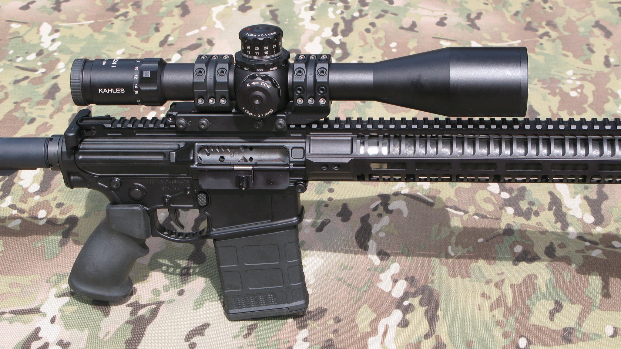

Here's a rifle similar to what you're describing I built in 2017 using a Proof CF 22" barrel (2 ounces more) plus the 2A Xanthos components along with alloy V Seven everything else. I could have scrimped more on furniture but I planned to actually shoot the thing. Just the bare rifle was 8 LB 2 OZ. It did perform quite well.
The shortest Proof CF barrel in 6.5CM is 20" and weighs 2 LB 14 OZ. You really do need a full mass bolt carrier group plus some serious buffer mass with the 6.5 CM.

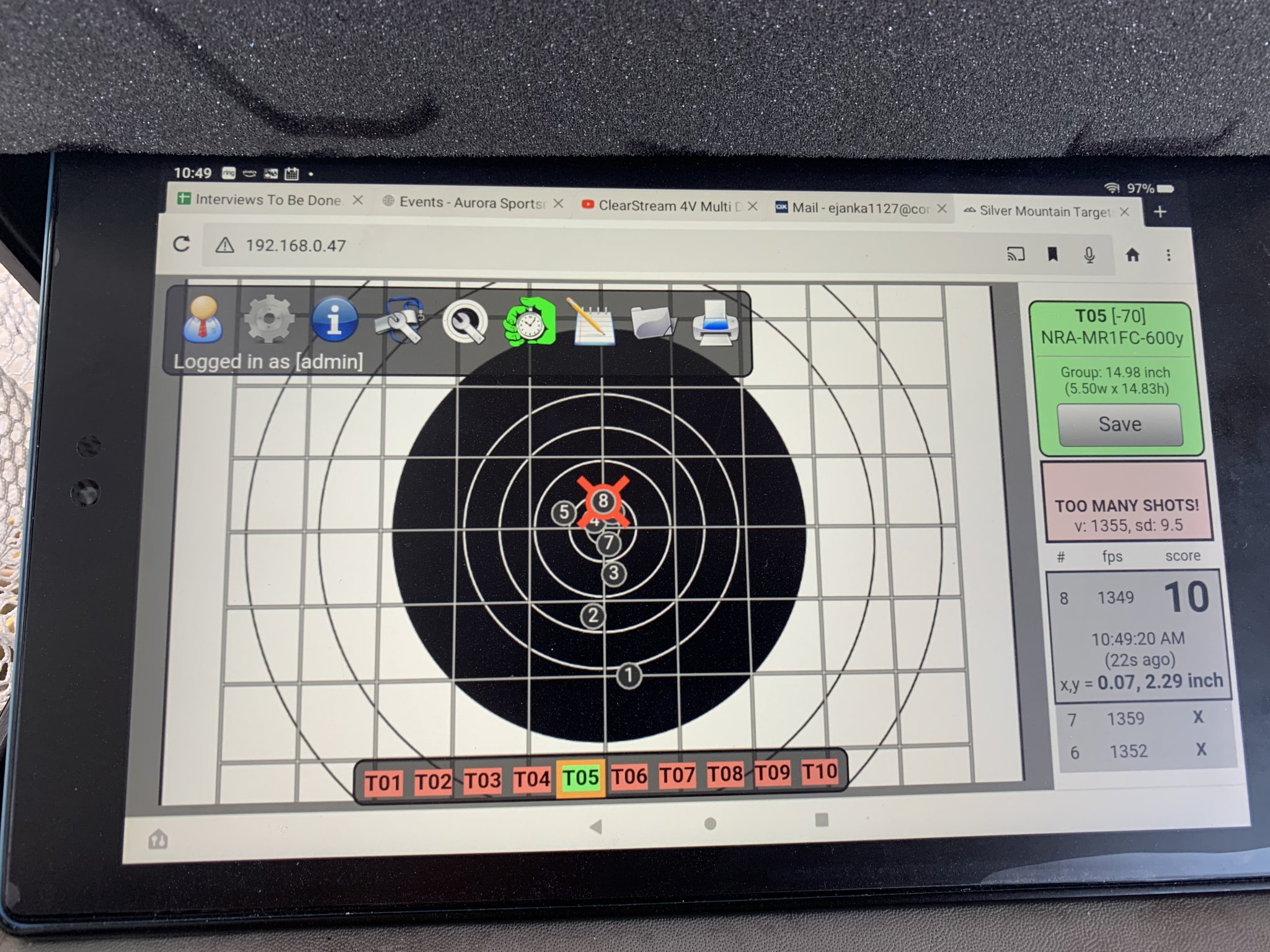

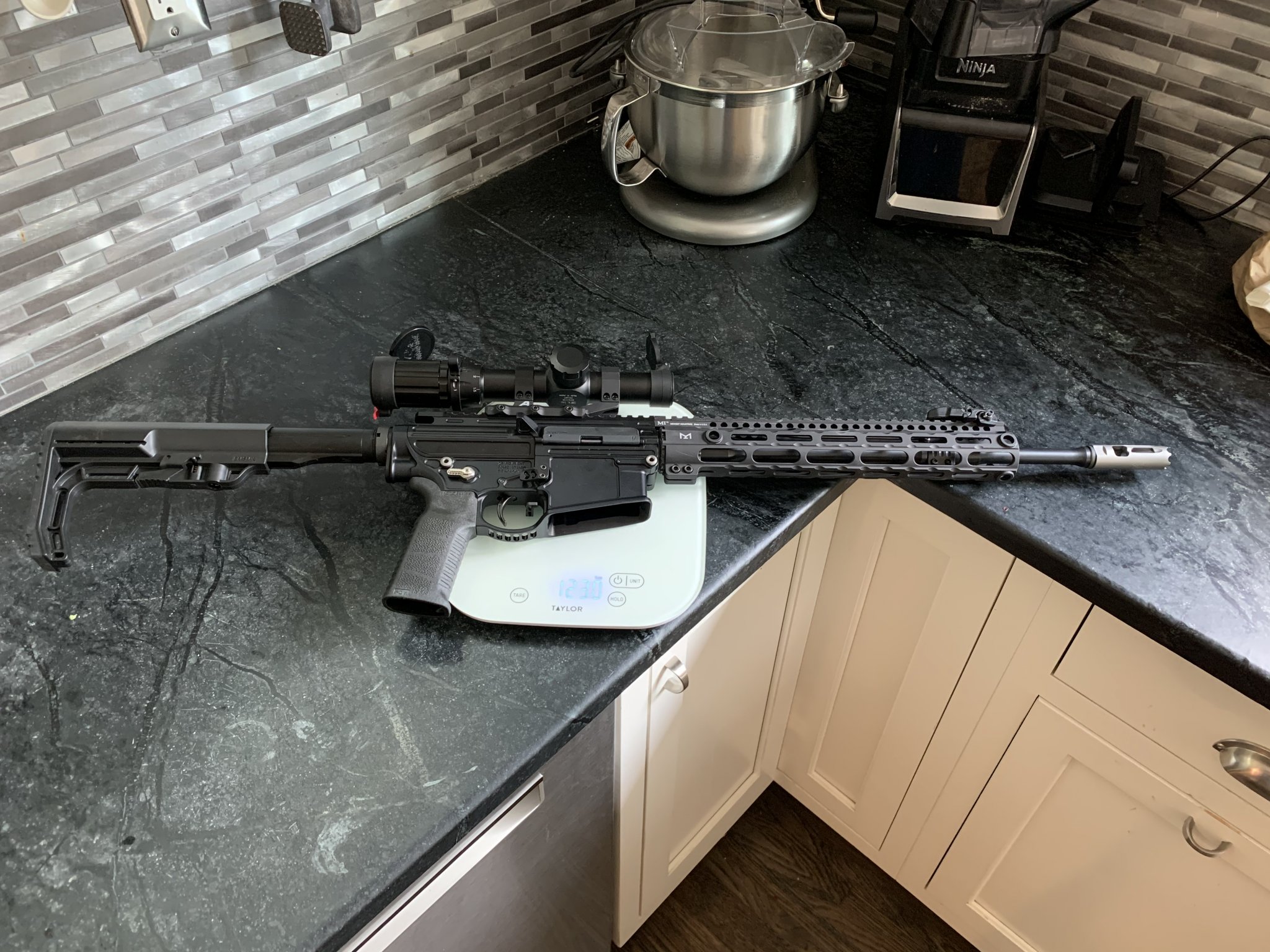

This has been my experience on the 6.5 I built above and a 308 in the following picture. If you look close, you can see that the 308 weighs 123 oz or 7.68#. That’s with a mounted SWFA 1-6 which is pretty beefy. It has a Faxon Gunner 16” barrel. The second photo is of an electronic target screen when I was shooting at 600 yards with it using 168 FGMM. The X-ring is 3”, the 10 ring 6”; I’m happy with how it’s shooting. The lower the mass of the bolt, the lighter the buffer can be IF you have an adjustable gas block. The handiness of speed block might actually be worth the weight even over the titanium adjustables I usually run that need a tool to adjust. To go light, it’s very important that you understand how the gas system works and how badly you can damage things if you open it up all the way and pull the trigger.

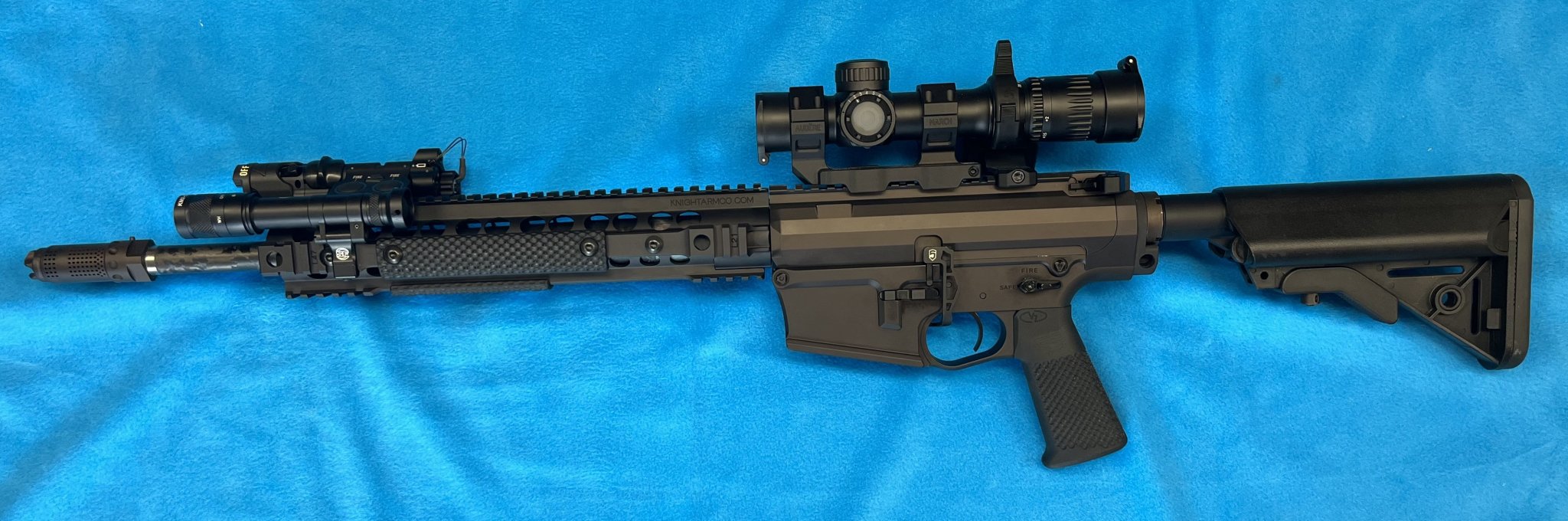

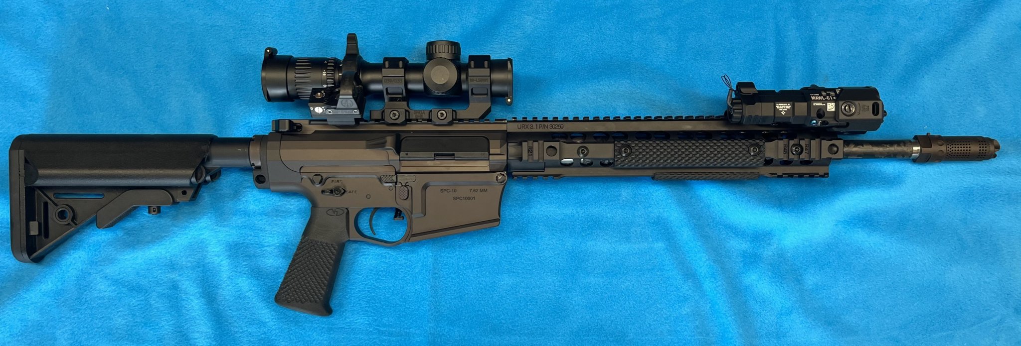

Sounds similar to my build on a Xanthos receiver set…. Mine finished out at 8.25# after swapping over to a Spuhr scope mount, a brass catcther mount on the rail, going to a Keymo mount vs direct thread for a can, and with the much heavier KAK bolt carrier with dual ejectors.
Was noticeably lighter with no muzzle device, a lightweight scope mount, and the V7 titanium bolt carrier…
…older pic with the old scope mount (and its AR15 mini me based on the original Balios Lite receiver set…with matching serial numbers btw), and when I was running a much heavier S&B scope. Basically swapped scope mass for mount and muzzle mass, LoL
I had a whole build thread with detailed notes, weights, etc. over on the old defunct Zombie Hunters web page, but that’s gone forever now, and I can only find some of the old pics.
Can get you a detailed parts list if needed, but bottom line it was a lot of V7 and 2A Arms titanium parts, Smoke Composite long closed stock, and a Faxon pencil profile barrel. All in cost was right around $6K with the S&B scope…about $1.5K less with the NF scope.
This is primarily a pig gun…not a lot of long strings of fire, and shooting at moving targets after the initial shot, so lightness and maneuverability matters. Pretty happy with it in every configuration.
