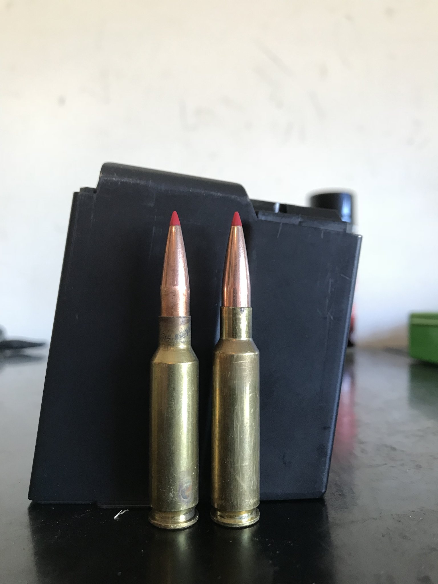

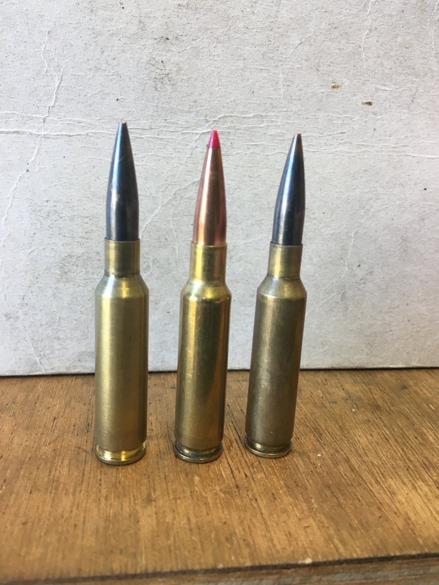

Just run a 7mm SAW with lapua brass.
Here’s a mocked up 7mm Creedmoor vs a 7mm SAW.
