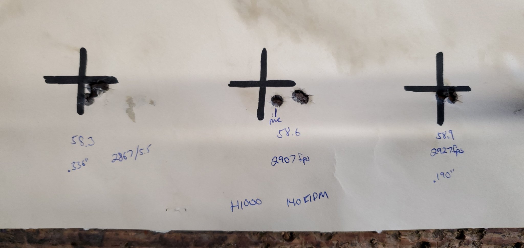

I load 58.2gr h1000 and 147gr eldm, it wasnt a compressed load, and this was to fit in a 2.980 mag. With a .188 freebore, I was jumping .050" though. Hence my suggestion for .130freebore.
I switched over to 140eldm, I can get those to the rifling and still fit in mag easily.
140s do good at 1700.

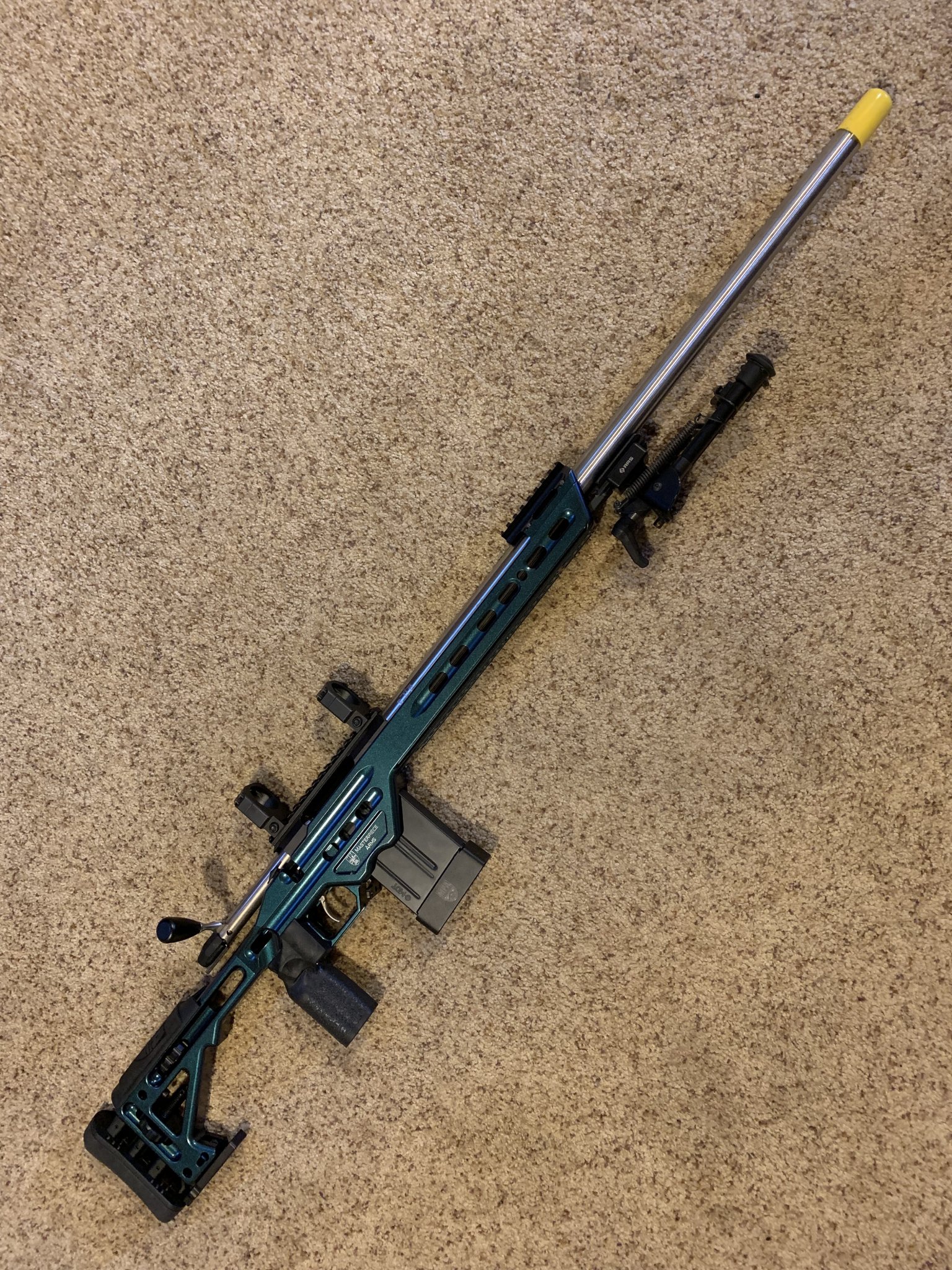

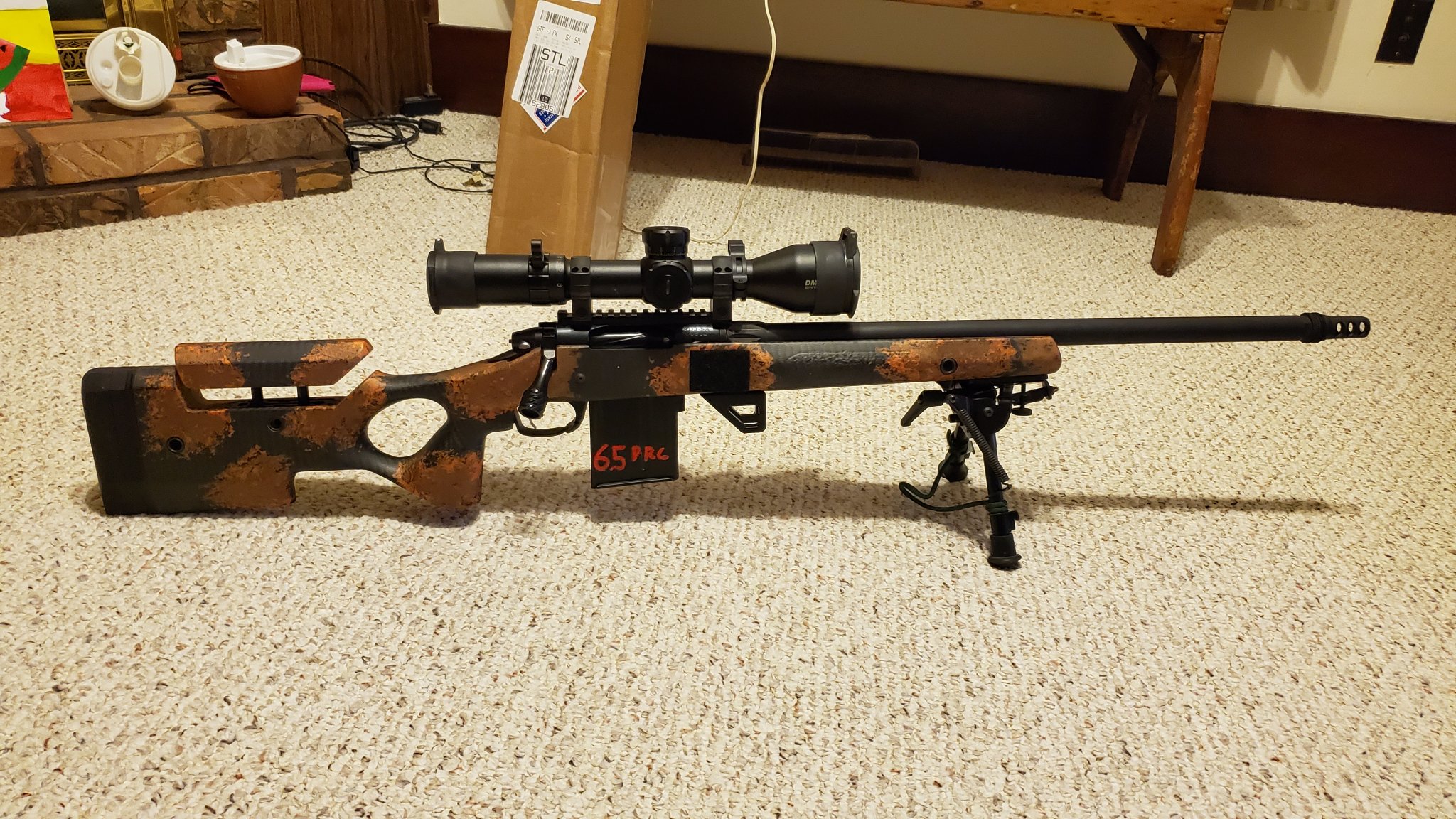

Which Tikka model did you start with? What magazine are you using? Nice rig BTW.
Just a regular old T3 action. Actually started out as a .308 action and I sourced the mag bolt from here. Short action bolt stop.
Atlasworx shroud and bolt handle. 28” Hawk Hill M24, GAP 4S chamber. Mag pictured is an Accurate Mag with MPA extension but I have since switched to the 419 extensions to give me 10 round capacity.
Again, function and performance does not suffer in any way compared to my full customs. Just have way less invested. Good luck!
