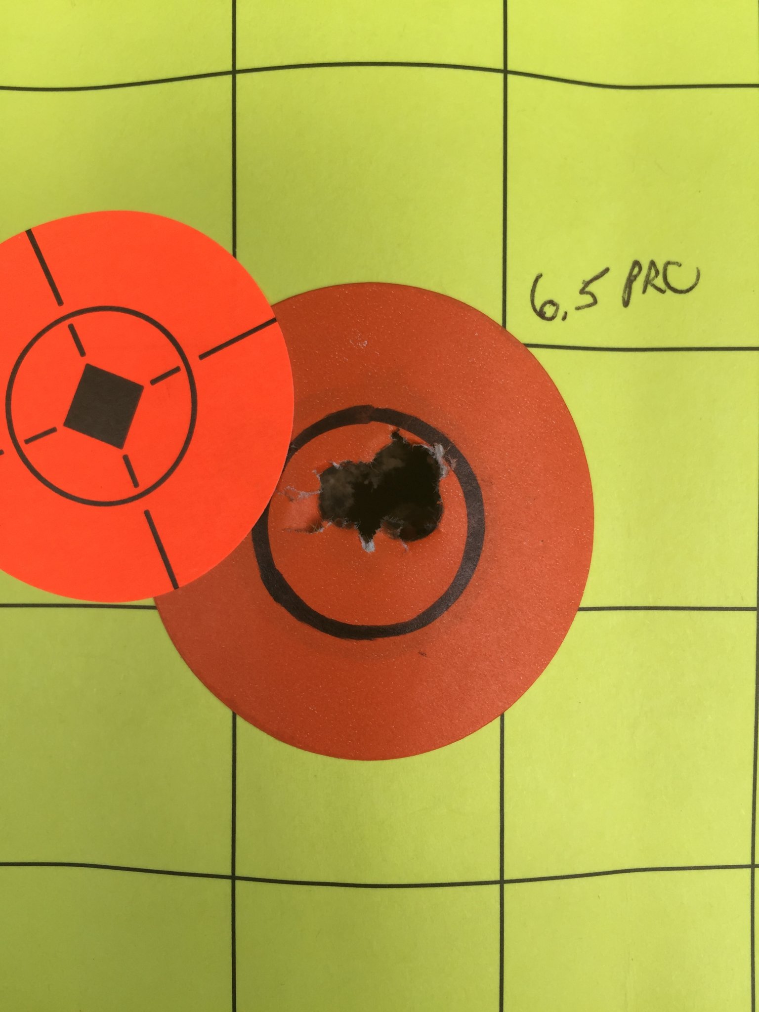

Factory Bergara HMR. 24” 8 twist barrel. Loves RL 26 and 142 gr ELDMs.
