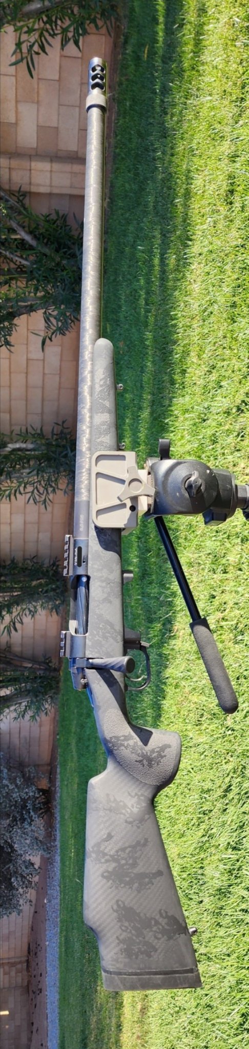

I’ve got a 6.5 prc on an impact with a 22” proof carbon barrel with a suppressor in a manners lrh, and with factory eldx I’m averaging 2920 fps, been working up a load with some different Berger bullets lately. I would go shorter than 24” as others have stated, of course you could always have it threaded and just run a thread protector if you didn’t like it need the brake .
