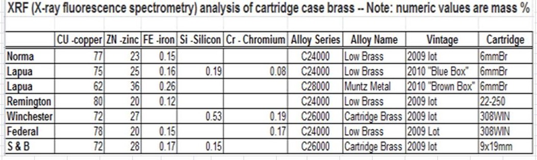

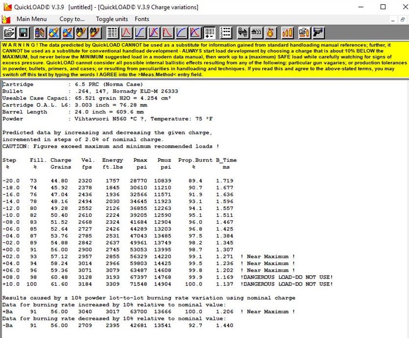

Here's some info you might find of interest regarding your brass and your load:

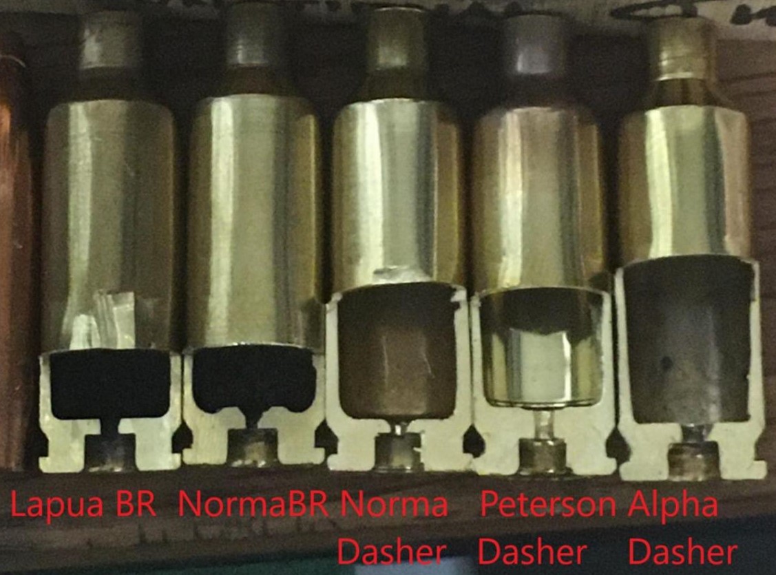

Interesting to me is the difference between to two Norma brass examples (BR with thin wall and the Dasher with thick case all) making me curious about their construction for the 6.5 PRC's:

I have not used Norma brass, but I have read and heard many reports suggesting the brass being softer that others, leading to primer pockets opening up relatively soon. 3x firings seems to me a lot sooner than I'd expects. Certainly, Norma's case walls are a bit thinner than than other's, which contributes to you having more case volume that've we've been discussing. Likewise, I don't think 56.0 grs of N560 is hot nor producing an unusual amount pf pressure that should be of any concern. My Lapua case pockets are looser than in the first few firings, but as long as there's no leakage from around the primer and they don't fall out, I don't worry about they feeling looser than before.
