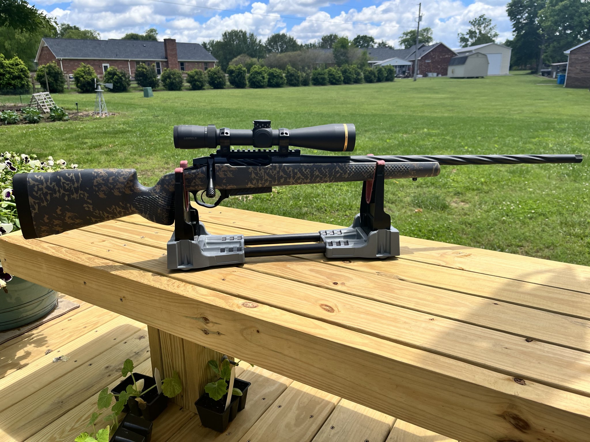

Picked up a Seekins Havak PH2 in 6.5 PRC this week. Got it cleaned, scope mounted, and sighted in. Its a shooter with factory 147 ELD-M but I like loading my own ammo so I need to get dies for it. I have always used regular FL sizing dies and non micrometer seating dies for my 270 Win, 270 WSM, and 30-06. Looking at doing something a little different with this rifle and could use some input from the group.
