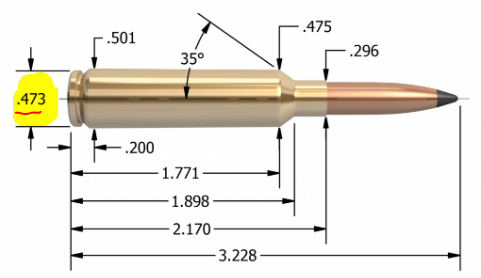

You have two factors. Action length and bolt face diameter. As far as caliber goes the action doesnt care what caliber the barrels bore is.
Chambering has two aspects, action length and bot face diameter.
If you have a 270 win then you have a .473" bolt face and you could change to any other .473 bolt face cambering and be fine. If you wanted to go from your 270's .473" bolt face to a PRC .540" magnum bolt face then you would have to machine your bolt out larger and means isnt an easy swap.
So yes, there are only to remington action lengths, short and long, but each of those lengths has a bolt face diameter associated with the bolt that has been fitted to the action and is a variable which is independent of action length.

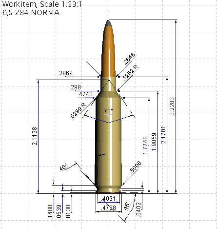

if you have a .270 (.30-06) boltface consider a 6.5-284. It will do everything a 6.5 PRC will do without the headaches. Plus Lapua brass is available. If you are set on the 6.5 PRC sell your action and buy another.

Yeah, a 6.5x284 barrel should screw in and shoot just fine.
One thing to note is that the x284 case has a rebated case rim, it it grows in diameter ahead of the case rim. Read up on potential feeding issues. If the mag lips dont allow the case up high enough for the bolt to catch the rim it could just catch the case wall and slide over it instead of pushing it.

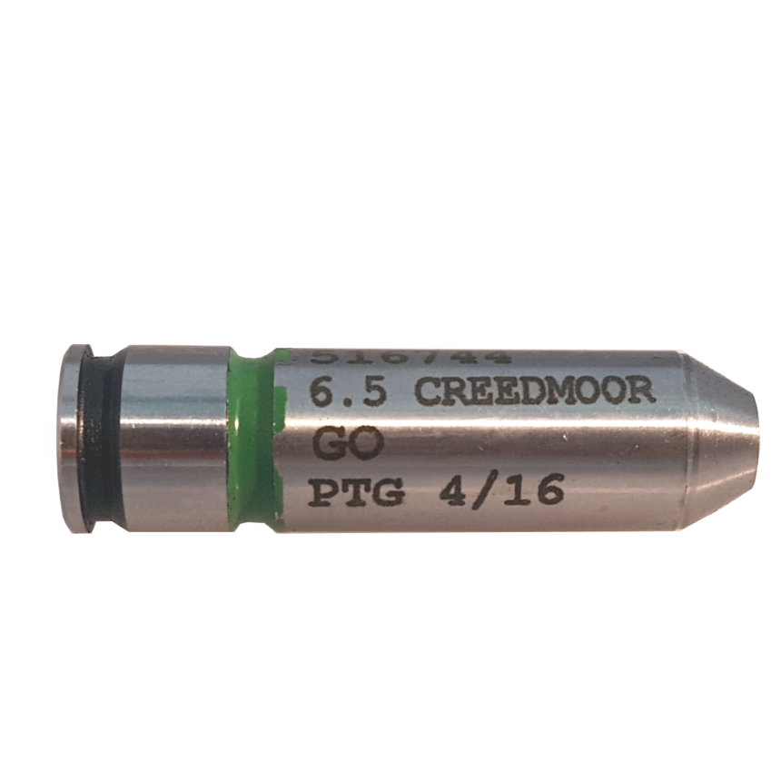

A go gauge is a little chunk of metal that’s cut to mirror the vital points of contact between the bolt face and the chamber shoulders.
Once you have the barrel started in the action threads you will insert this in the chamber and then thread the barrel in until you can feel it bottom out against the bolt face. You are then at proper headspace. Tighten the nut down against the action to lock the barrel in place and you are good to go. If you add a layer or two of scotch tape to the back of the go gauge you create a nogo gauge which is .004 longer to ensure you don’t have it too deep.
The bolt should close on a go and be prevented from going down on a nogo.
It’s the same as how savage barrels work.
Reactions: zog

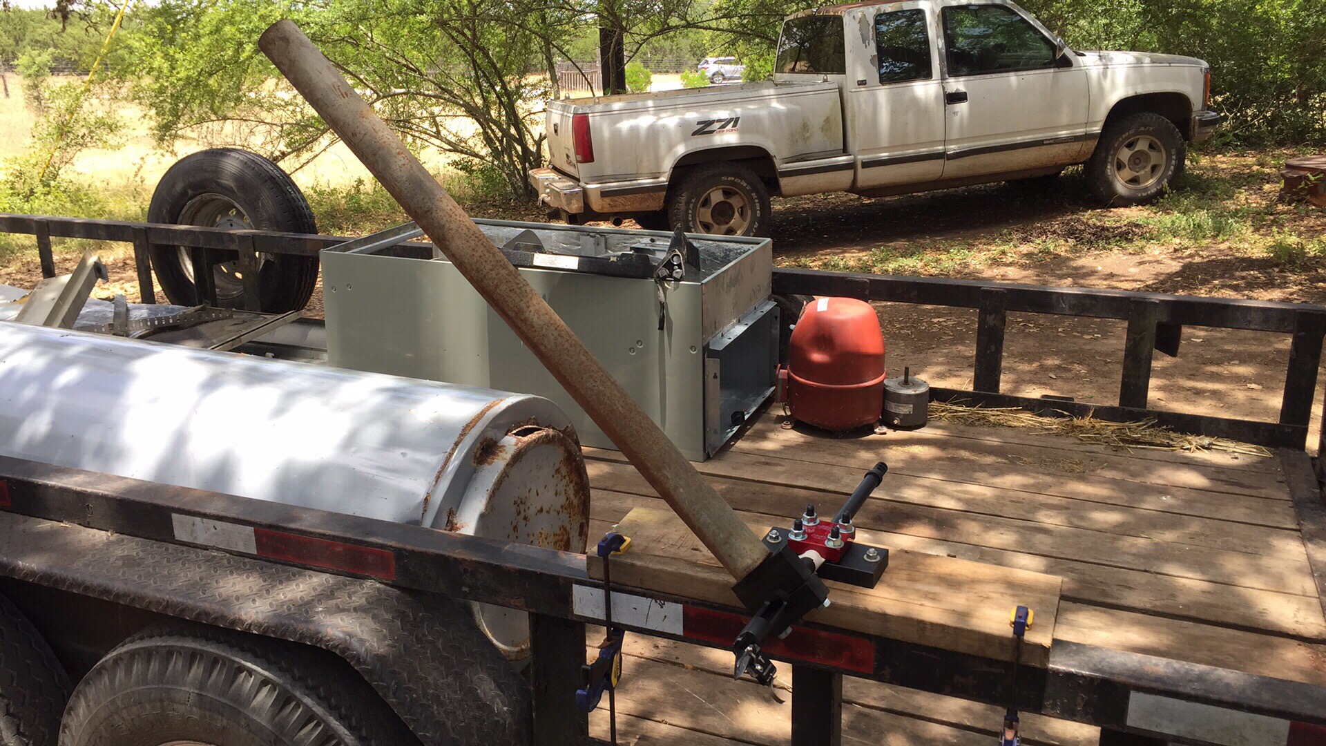

How much torque am I likely to encounter when I first try to loosen the barrel in a 12 year old stainless rifle? (Well kept but still was out in the weather during the hunt)
No clue, it caries. I put a big breaker pipe on my action wrench and it was nothing. Some say it was still tough for them. Soak it in penetrating oil, put it muzzle down and squirt some inside the action so it can soak down into them.
Yep, that's what I figure I would be up against. I can see I need proper clamping tools, not pieces of tire padding in a bench vise and in a big pipe wrench on the action.

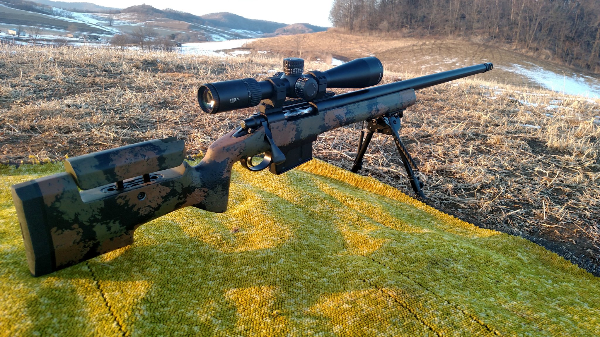

sorry... late to the party and I understand that the op went in another direction.. but just for future reference and to add to the thread about 6.5 PRC vs 6.5-284 conversion I will add my experience .. experiment
I took possession of a "assumed" shot out 6.5-284 hunting rifle that a guy was selling.. and I don't think he knew what he had... he told me he bought it just for the night force that was sitting on it.. and was selling the rifle..
get this.. for 600 bucks.. I got a remington 700 that started life off as a 30-06 (per the '80s serial number check) ... sitting in a MANNERS elite carbon hunting stock WITH MINI CHASSIS ... a 26" CBI Remage hunting profile barrel .. and ~150 new Lapua brass, some previously fired brass ~40 .. some looking rough, and some reloder 17 ..
I think that the seller had no idea what he was doing with reloading since some of the brass showed pressure and some of the loaded rounds that were included, some would have been squibs since he forget to throw powder and the ones that had powder were way on the hot side (NEVER SHOOT ANYONE ELSES HAND LOADS... PERIOD)
so I did some testing with the reloder 17 and was not happy with the powder 140 bullet performance.. velocities that I wanted from this using 17 were on the hot side and pressure spiky ... and groupings sucked..
I used some (apr ~54) grains of reloder 26 and the magic was happening .. 3050 fps and 1/4 inch groups at 100...
damn .. this barrel shoots.. now its a lightweight hunting profile barrel... so not to be used for string fire .. especially in a overbore "magnum - ish" 6.5x284... but one hell of a hunting rig.. and 3000+ fps with a mild load and no pressure signs past 55 grains and 3100fps.. (thats where I stopped) never got pressure.. 140g bullets and r-26 are magic in this caliber..
so -- remage works for 6.5-284 for a conversion 700 long action (30-06 in this case) .. and it shoots...
so , ordered a varmint profile remage from CBI (melonited) and dropped the whole rig into a XLR envy
still load testing but 54 is still a node and with this new barrel velocity is a little lower 2980 or so during the first 10 shots (still working it up) but accuracy is under .5MOA so far and I believe the lower velocity is due to the melanite treating.. slicker, not building as much pressure.. but accuracy is great and r26 is really easy on the brass
yes .. 6.5-284 feeding great out of magpul long action magnum AICS mags . no modifications to action or magazines and they hold 5 rounds...
further.. with a little sanding on the magpul bottom 'plastic' I dropped that into the manners stock with mini-chassis and it works fine there too ... so I can go BDL internal mag or AICS drop mag with it now... awesome..
so to finalize... took old 30-06 long action 700 and turned it into a match / hunting caliber swapping multi chassis one action does it all rig....
and it shoots...
