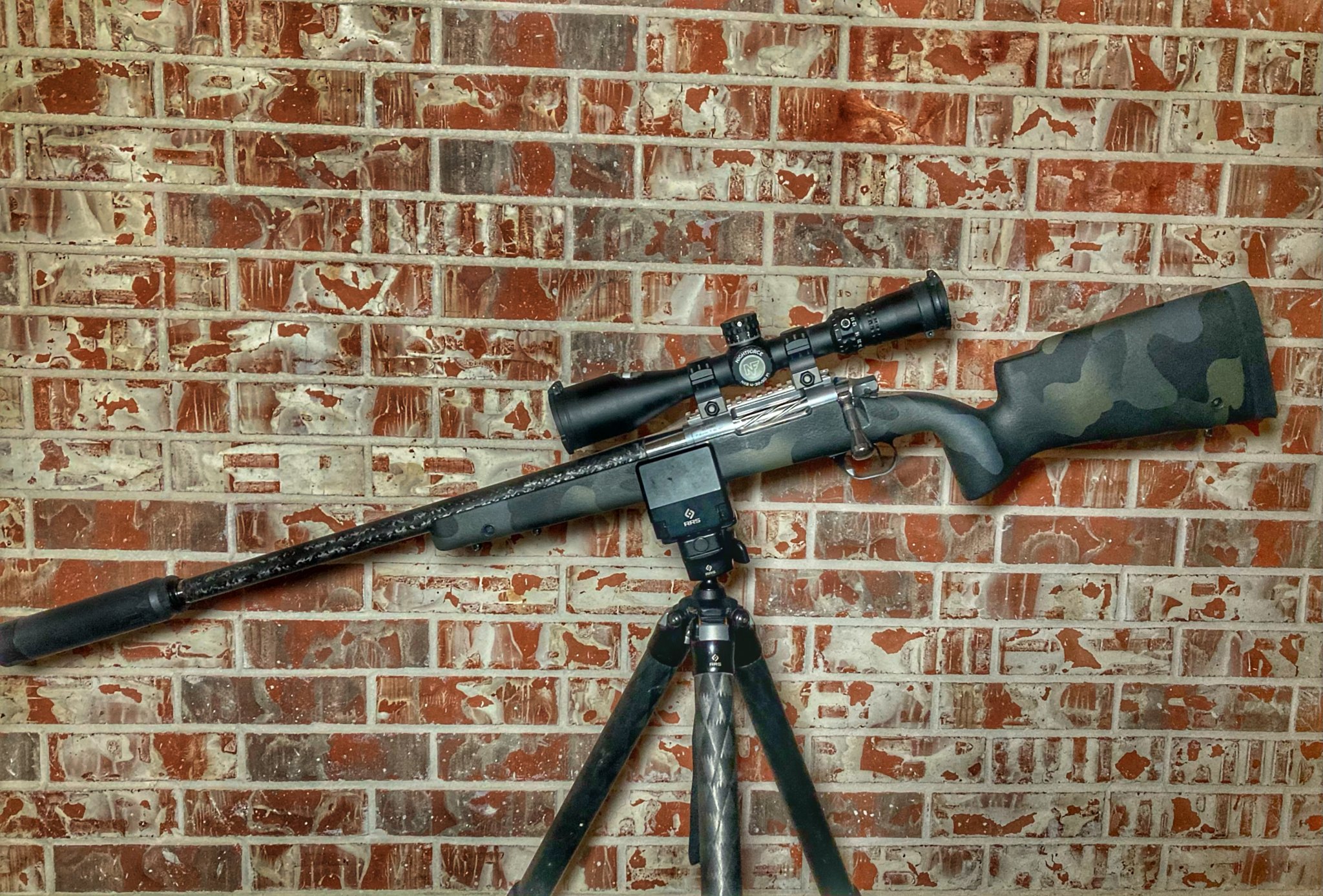

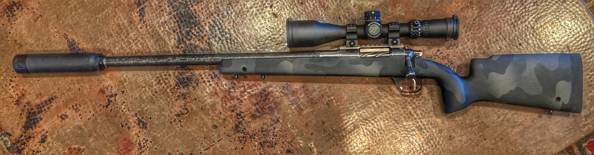

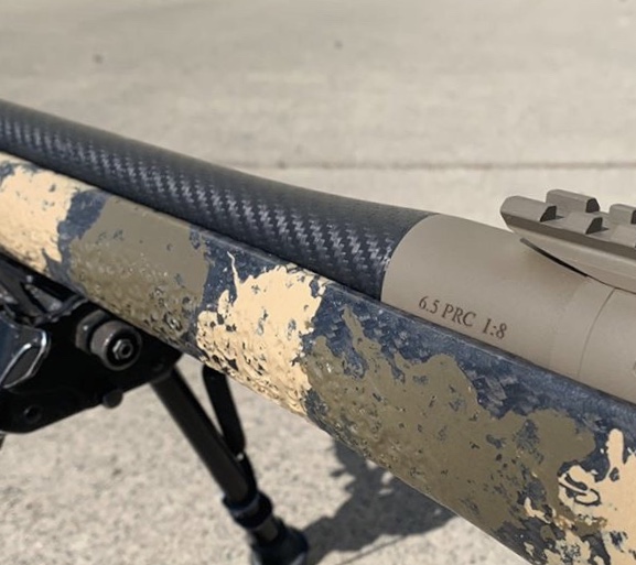

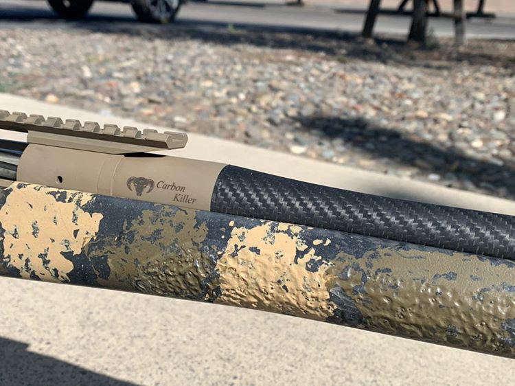

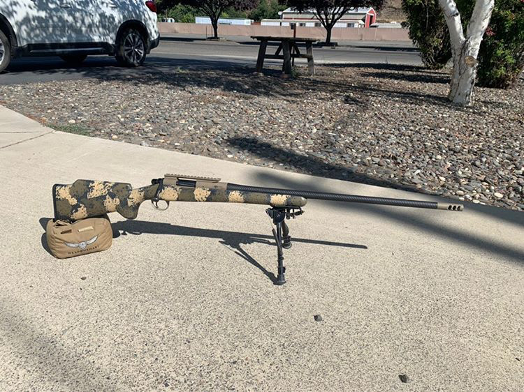

This is not at all about me, but I literally just spent a year going through all this and it might help drive some of your decisions... It turned out to be ultra accurate and just excellent. I hope your project comes along well too brother!
Action: Curtis Custom - Axiom, Short Action, pinned 20 moa rail and recoil lug
Barrel: Proof Research, Carbon. 24" 1:7.5" Sendero
Brake: Area419 Sidewinder M18x1
Stock: AG Composite, carbon, Chalk Branch with QD flush cups on side and atlas 3" rail for bipod and QD sling (excellent shape, very comfortable vertical style grip and nice shaped front end for shooting off a pack and slinging, extremely happy with this stock!)
Rings: Nightforce low 6 bolt ultralite (light, solid)
Scope: Nightforce NX8, 4-32, Tremor3 (excellent scope, NOT an ATACR, but it's very tactile and clean)
Bottom Metal: Hawkins orbendorf hinged floorplate (very sleek, works well with a sling, no magazine hanging out the bottom)
Trigger: Triggertech diamond, flat shoe (diamond isn't required, but it was the only TT available at the time)
Magazine: Wyatt PRC mag box and follower (if you go internal you'll probably want to look at this)
Bipod: Atlas V8 PSR with spiked feet from Ckye Pod
Chambered specifically for Hornady factory 143gr ELDX Precision Hunter.
Mag holds 2 internally with 1 in the chamber.
Shoots sub .5 MOA all day, it's the most accurate rifle I've ever owned.
Weighs 4.5kg empty without bipod.

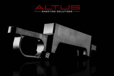

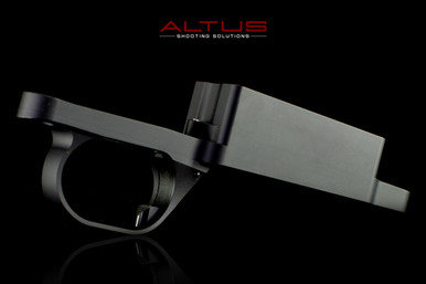

What magazine would y'all recommend for Hawkins M5 BDM. I know they are AICS but any suggestions?
or
Accurate mag
or

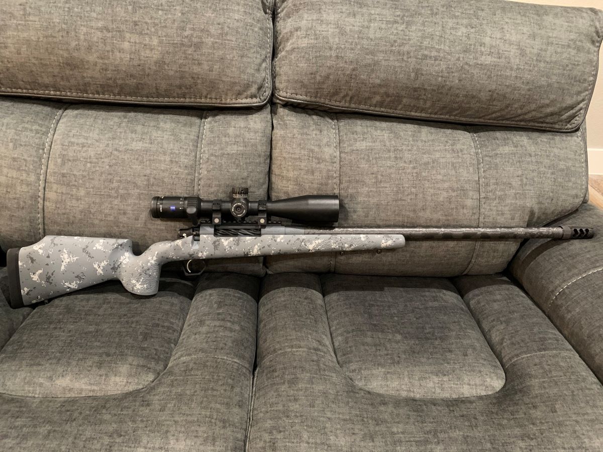

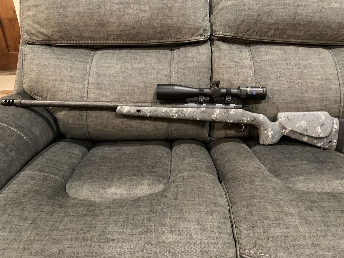

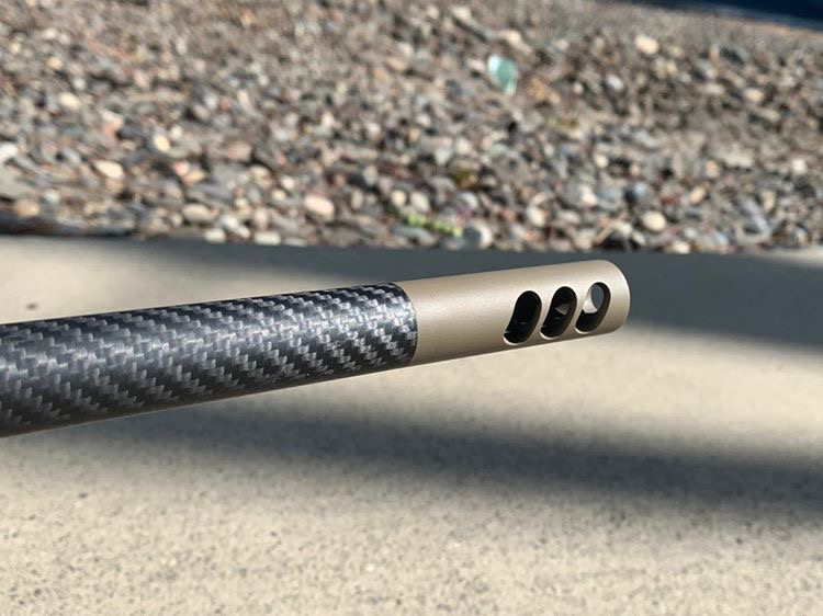

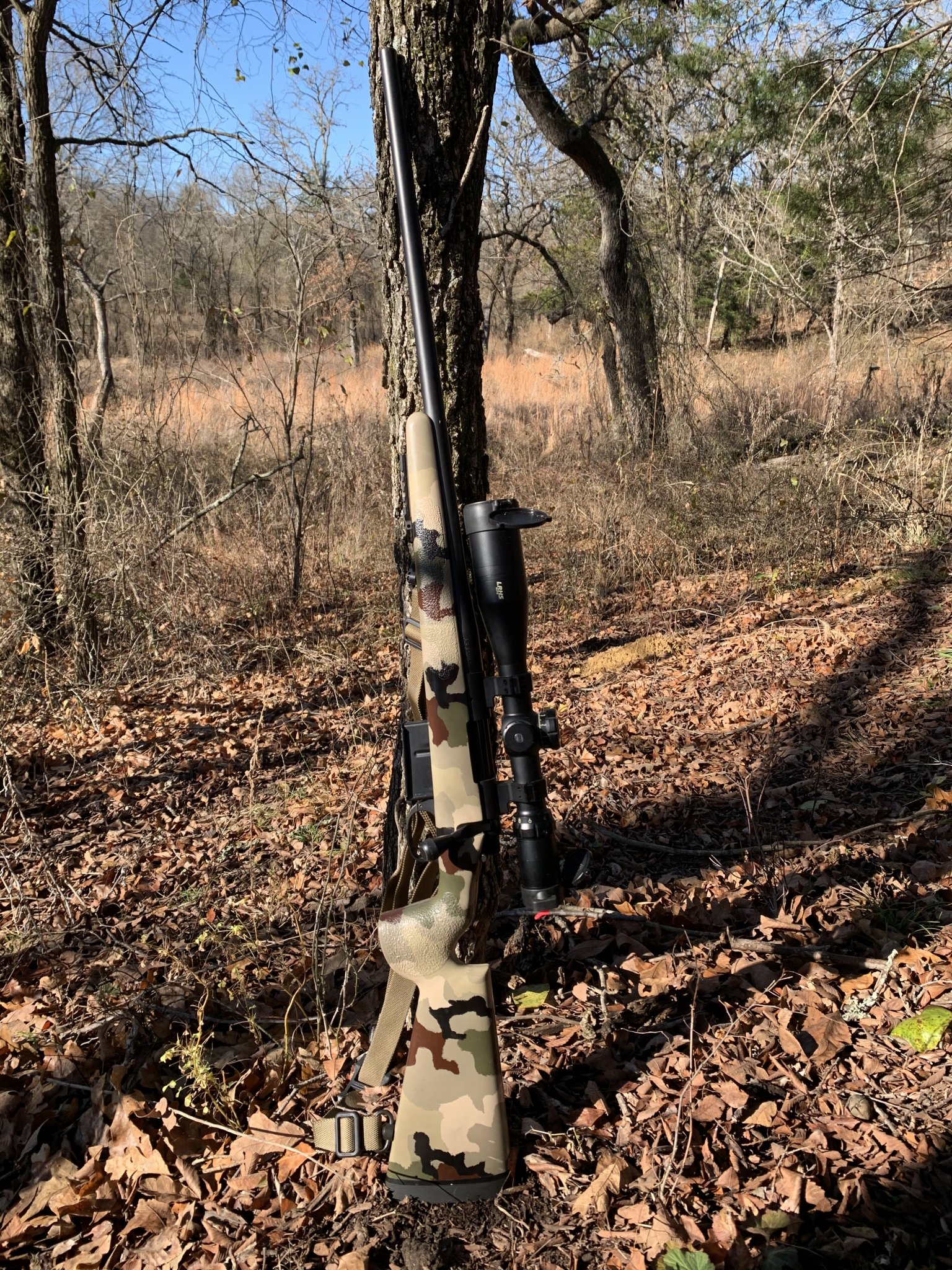

Hey guys! First post that I feel I can contribute to. I have a build that I just finished that is pretty similar to what you are looking to do. Here are the specs to give you an idea on components vs. finished weight.
6.5 PRC
Defiance Tenacity Long Action
24" Proof Sendero Contour
McMillan Game Hunter Stock
Area 419 Hellfire Brake
Triggertech Primary trigger
Zeiss Conquest V4 4-16x50
Nightforce .885" rings
Finished Weight: 9.25lbs

Finished!
6.5 PRC Alamo Build includes
Defiance Tenacity Action
AG Composite Stock (Custom Painted by Alamo)
Trigger Tech Diamond
22" Proof Sendero Barrel
Hawkins DBM Bottom Metal
Nightforce High Rings
Nightforce NX8 4-32x50
Area 419 Muzzle device and suppressor QD Adaptor
DeadAir Nomad Suppressor with E-Brake
