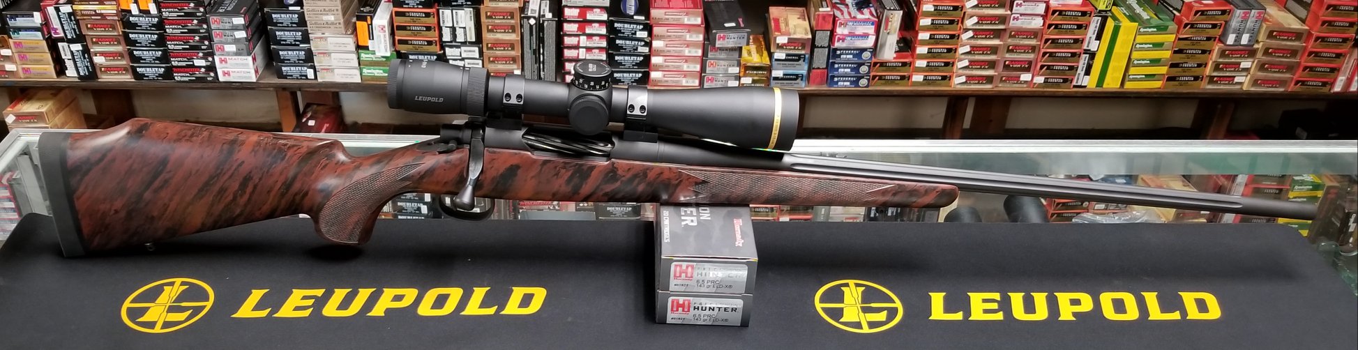

    I got my PRC and am happy. Jonathon at Fine Firearms in La Mesa CA built it for me. 24" #3 fluted Brux barrel, Stiller Predator (med action), oversize stiller recoil lug, Shilen trigger at 3 lbs, blind Stiller magazine, McMillan Hunter stock , Woody finish, action glass bedded, Graphite black Cerakote topped with pinned Talley rings, and a Leupold VX5 3-15x44 scope. Used the 0.1883 freebore. First shot was sighting in then next were 10 shot group using factory Hornady Precision Hunter with 143 ELDX. Going to reload with Berger 140 Hunter Elites using H1000

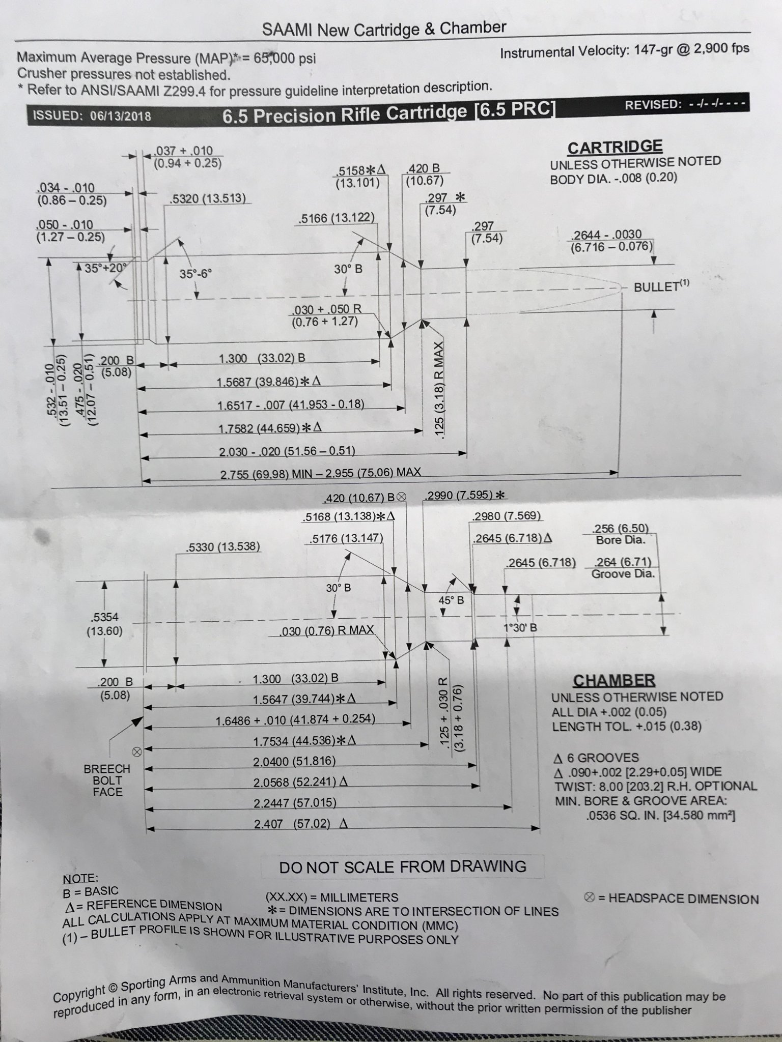

    Hello guys I need a little guidance here is my reamer spec sheet from smith can someone point out please the free bore I’m not seeing it on this sheet or I’m blind or possibly a idiot too thanks
    I also would like to learn how find out the freebore........messing with some numbers I may have gotten the number but idk if it’s right, sounds right anyway: I took the 2nd pictures 2.2447 number and subtracted that from the same pictures 2.0568 number and ended up with .1879. That is the SAAMI spec so I think I did it right?
