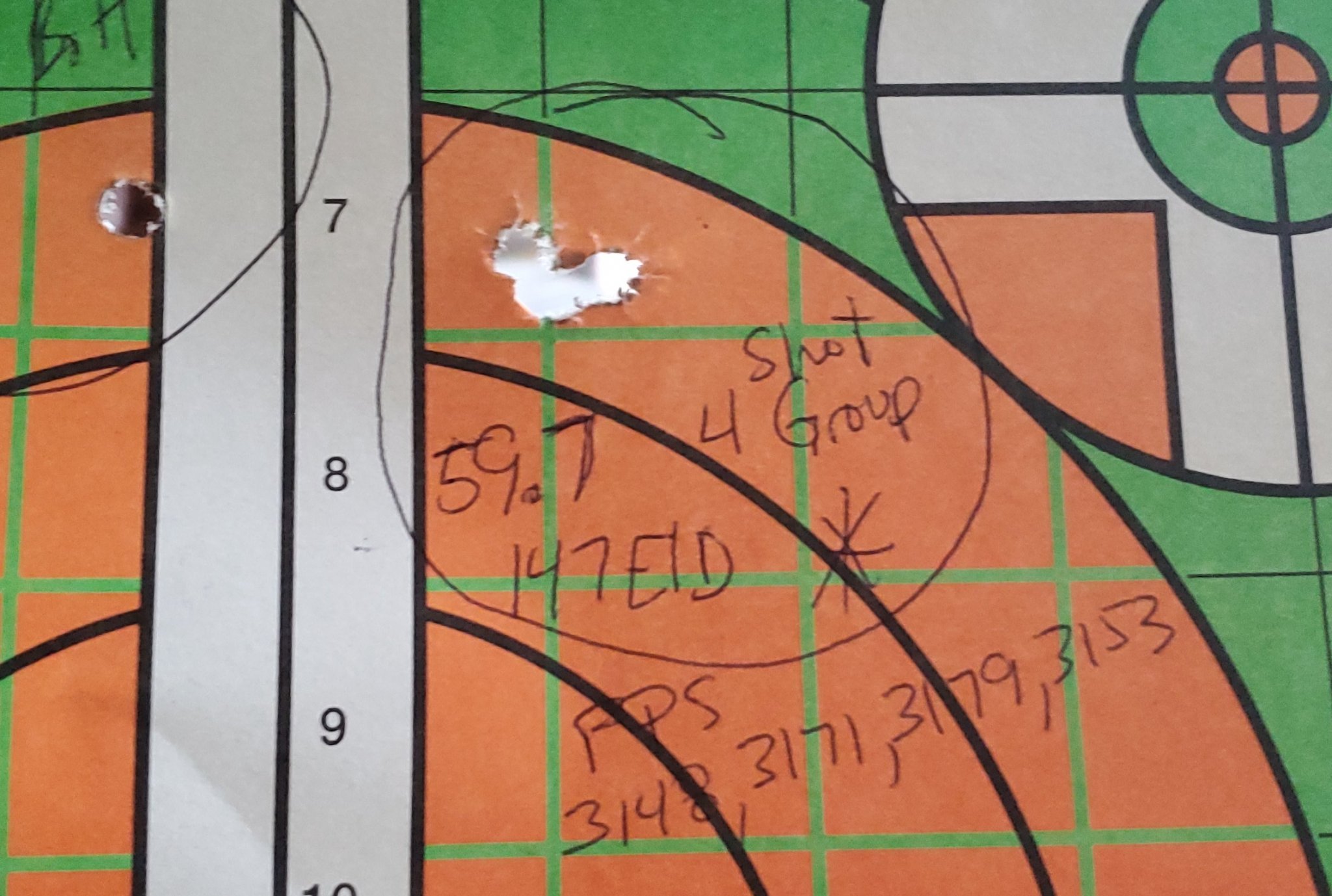

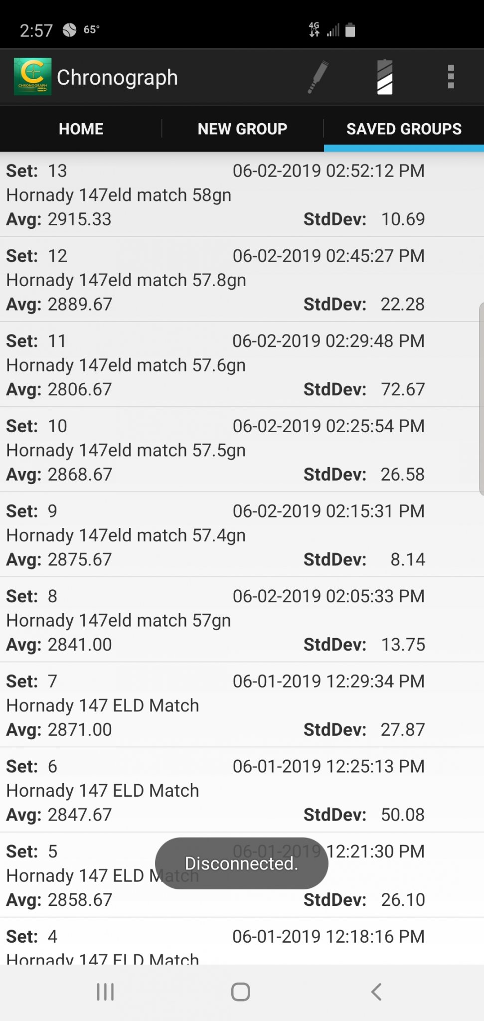

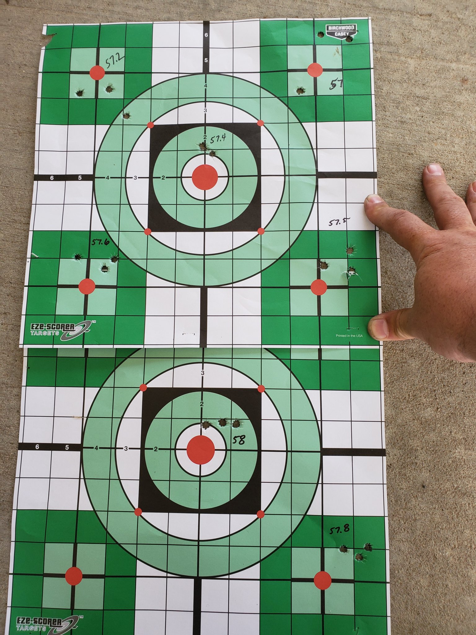

I built a 6.5 prc. 24" proof research carbon barrel with brake,tikka action. I started reloading with h1000, new hornady brass, 147eld match and fed. Primers. I am working my way up and am at 58 grains with no pressure Mark's but my velocity will drop out of know where. Here are some of my readings and pictures of targets. Just looking for some guidance or to see if on the right track with powder and other components. I appreciate any feed back.
Thanks
Chad

Try ADG Brass. I get consistent single digit SD. However not getting velocity i want. But I'm using RL23. That said based on Hornady's loading manual, i should get at least 2900fps with max charge. @52.5, velocity avg is 2838fps

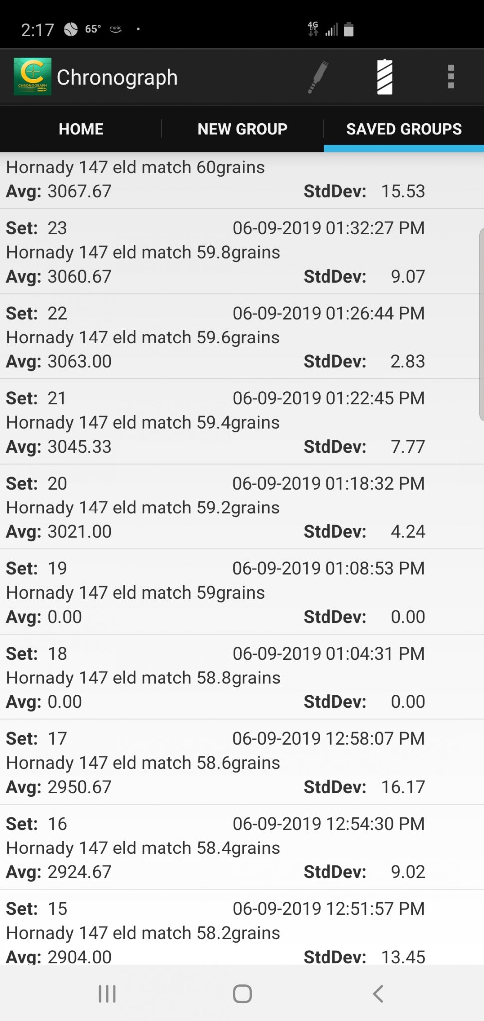

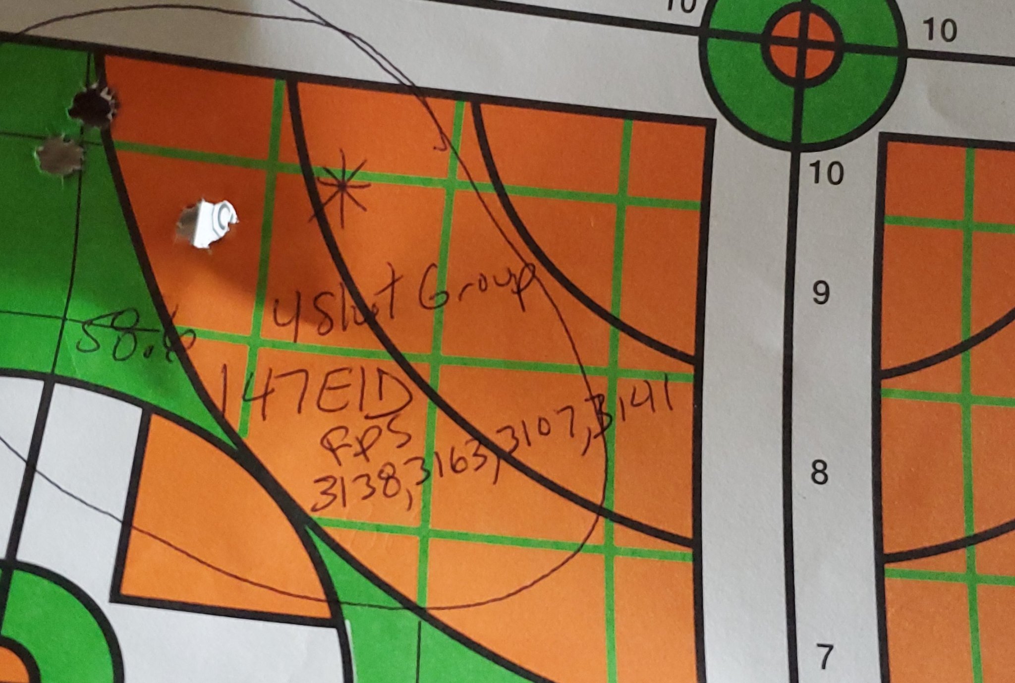

So here is what I am getting now and it seems like I am getting more consistant. I am going to 61 grains in .2 increments. Hornady maxed out at 57.4 with H1000 and said you would get 3000fps. You can see I didn't hit 3000 until almost 60grains and I am seeing no pressure signs yet. I think I will see them soon, so I am thinking I will see well into 3100fps. I will keep you posted.

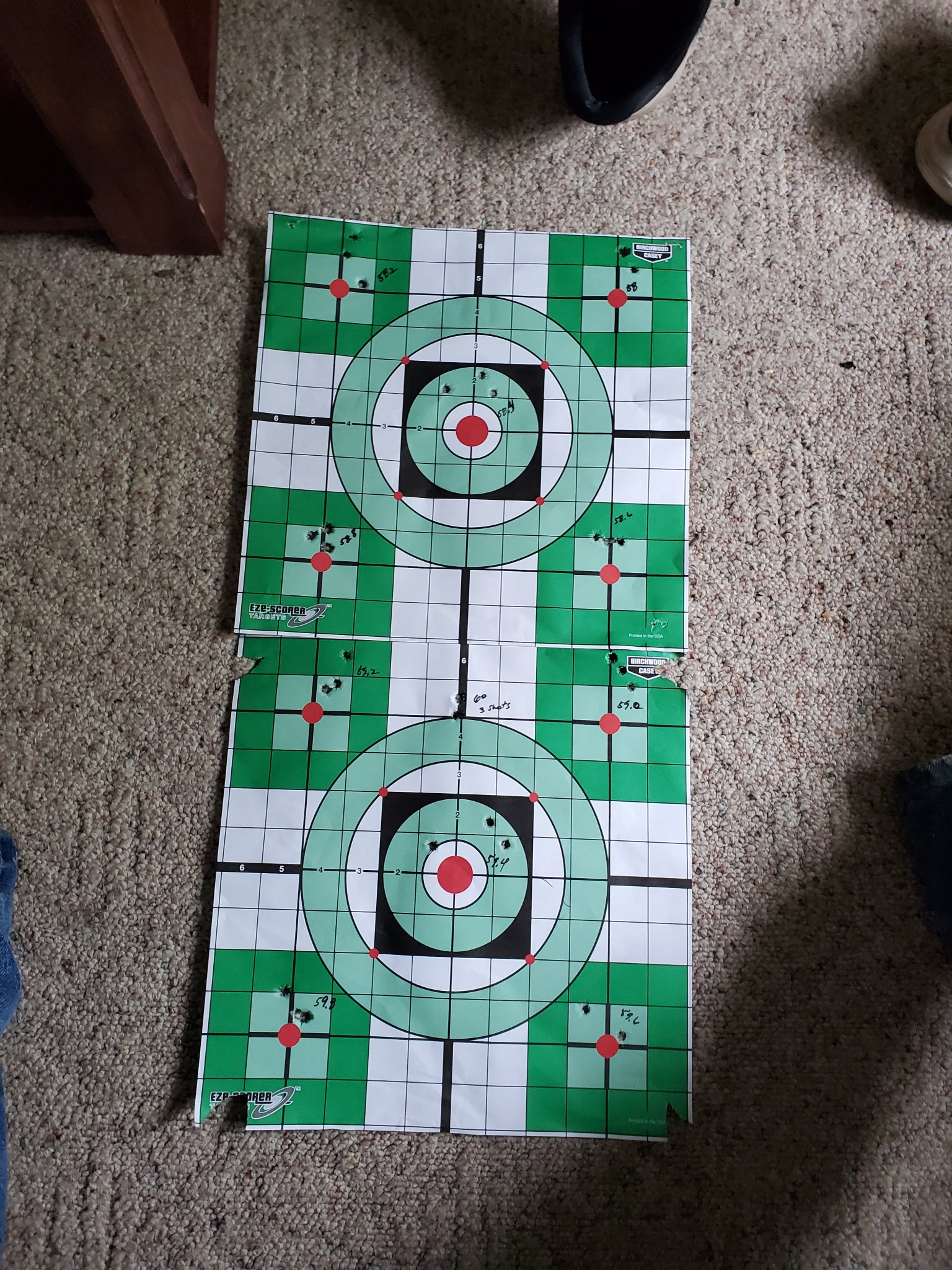

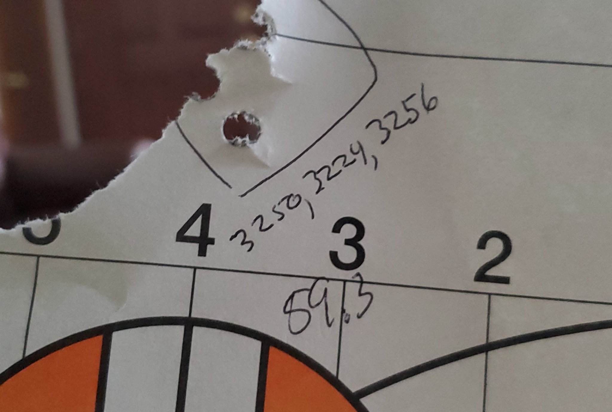

So here is the latest data I have put together
The top one is barnes 127lrx needs a little work but I think I am going to drop that down to a node I got around 3100. Is 3250fps a barrel burner?
The bottom 2 are 147eld
59.7 is the bottom picture and looks like the one
I just found that my digital scale was giving me false readings once in awhile and thinking that's what happened in the middle picture with the 2 flyers

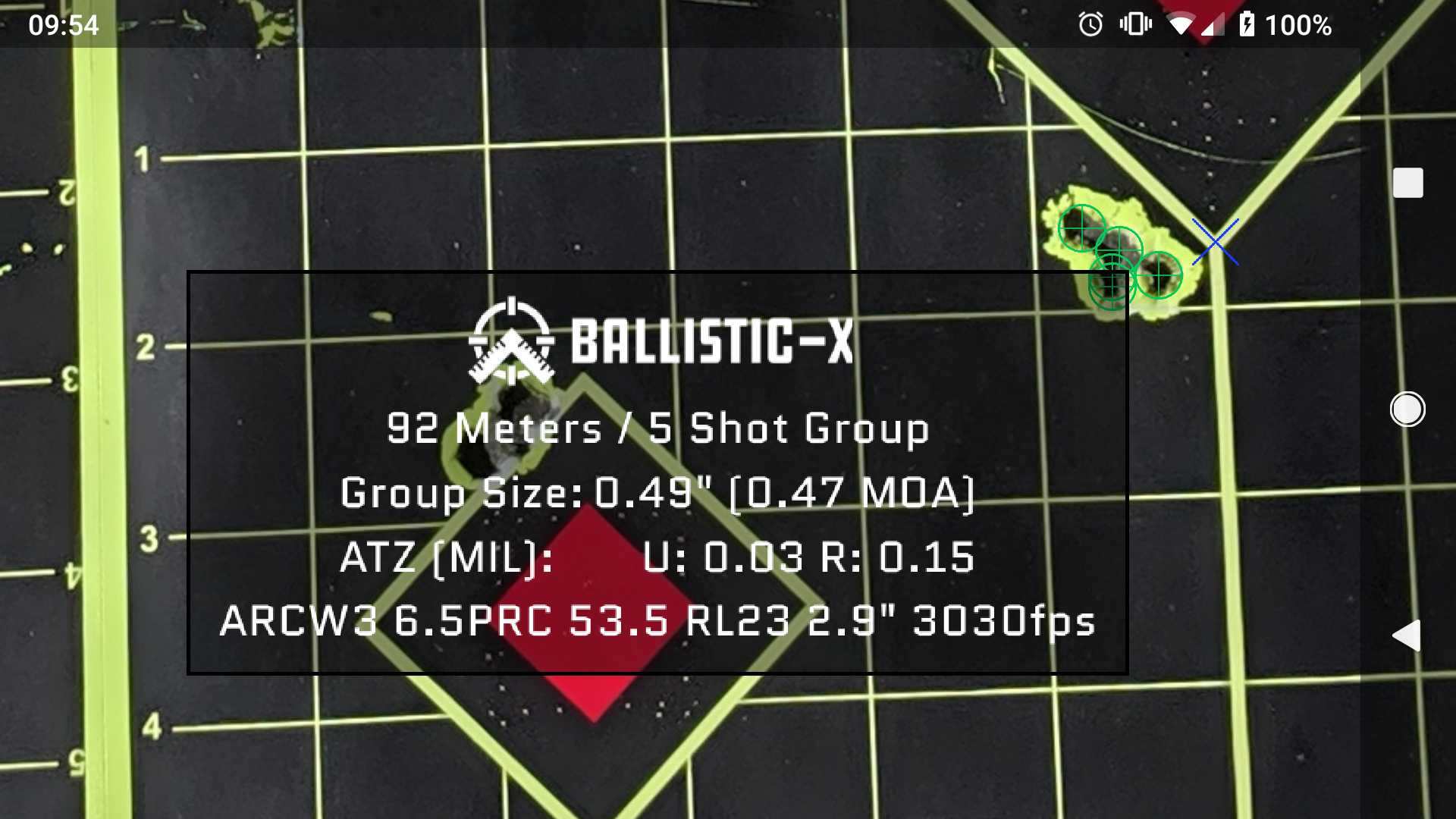

Did you ever get any further with the Barnes 127lrx? Looking to build a tl3 with proof barrel 6.5prc but since I am in California I can only hunt with lead free bullets. Not a lot available in .264 other than the lrx
127LRX
ReLoder 23
6.5 PRC ADG Brass (Virgin)
BR2 Primers
BTO - 2.310"
22" Heavy Palma
SAAMI spec Chamber
53.5 gr (RL23):
Stats - Average3027
Stats - Highest3047.22
Stats - Lowest3016.03
Stats - Ext. Spread31.19
Stats - Std. Dev12.74
Shot IDV0
13047
23016
33029
43016
53026
