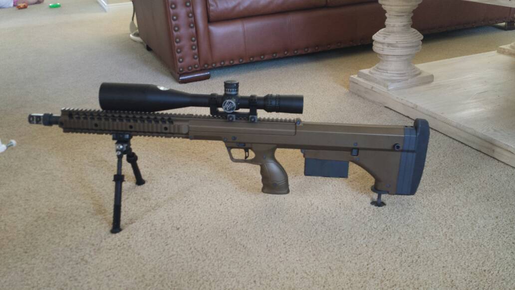

    Here is mine. Defiantly not a hunting rig.
    6.5 SAUM .298 NK reamer
    26" M24 8 twist bartlien barrel
    AICS 1.5
    Nitrited barrel and action
    S&B 5-25 H2CMR
    Thunderbeast 30P-1 it always on there when I'm shooting.
    Shooting 140 Hybrids and it shoots them great.
