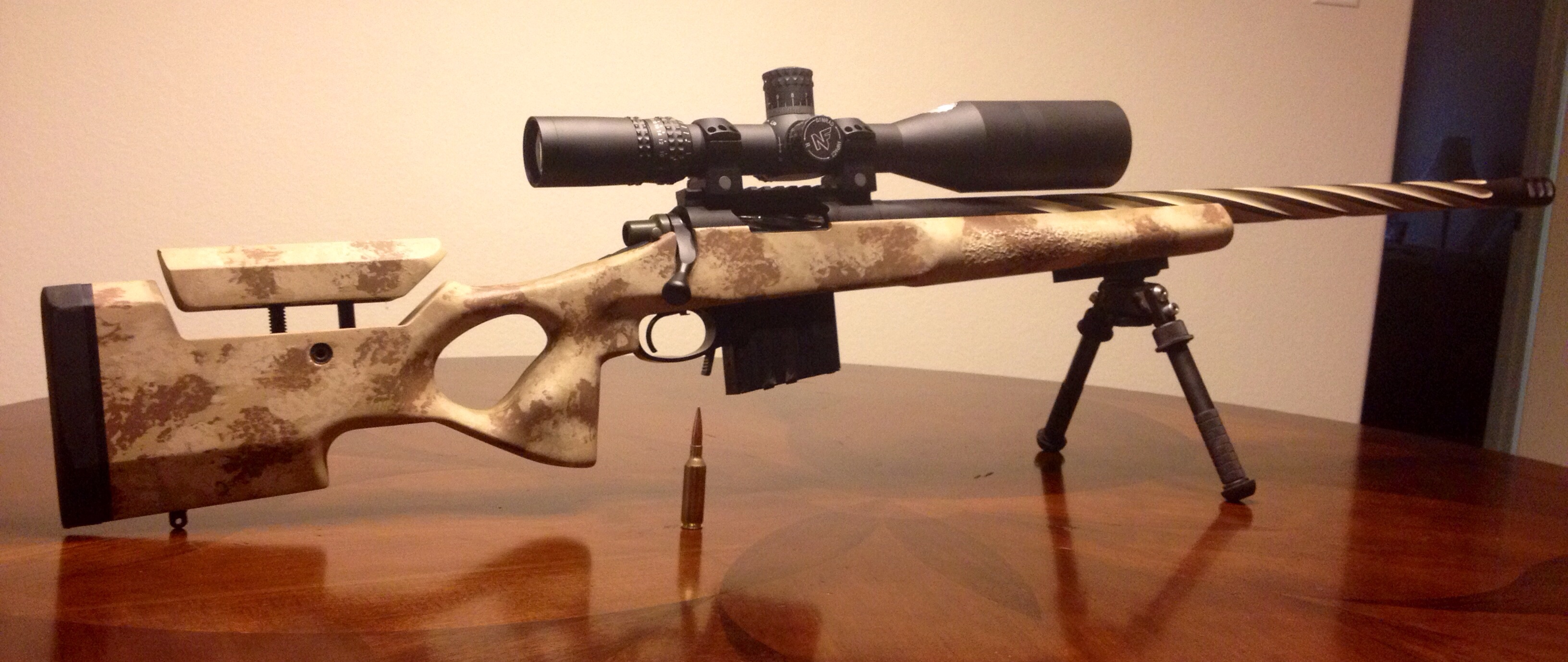

Omar Alonzo 6.5 4S
Accurate Ordnance .260 was originally in a chassis. Omar bedded it and the Defiance DBM in a T4A and also Cerakoted the stock.

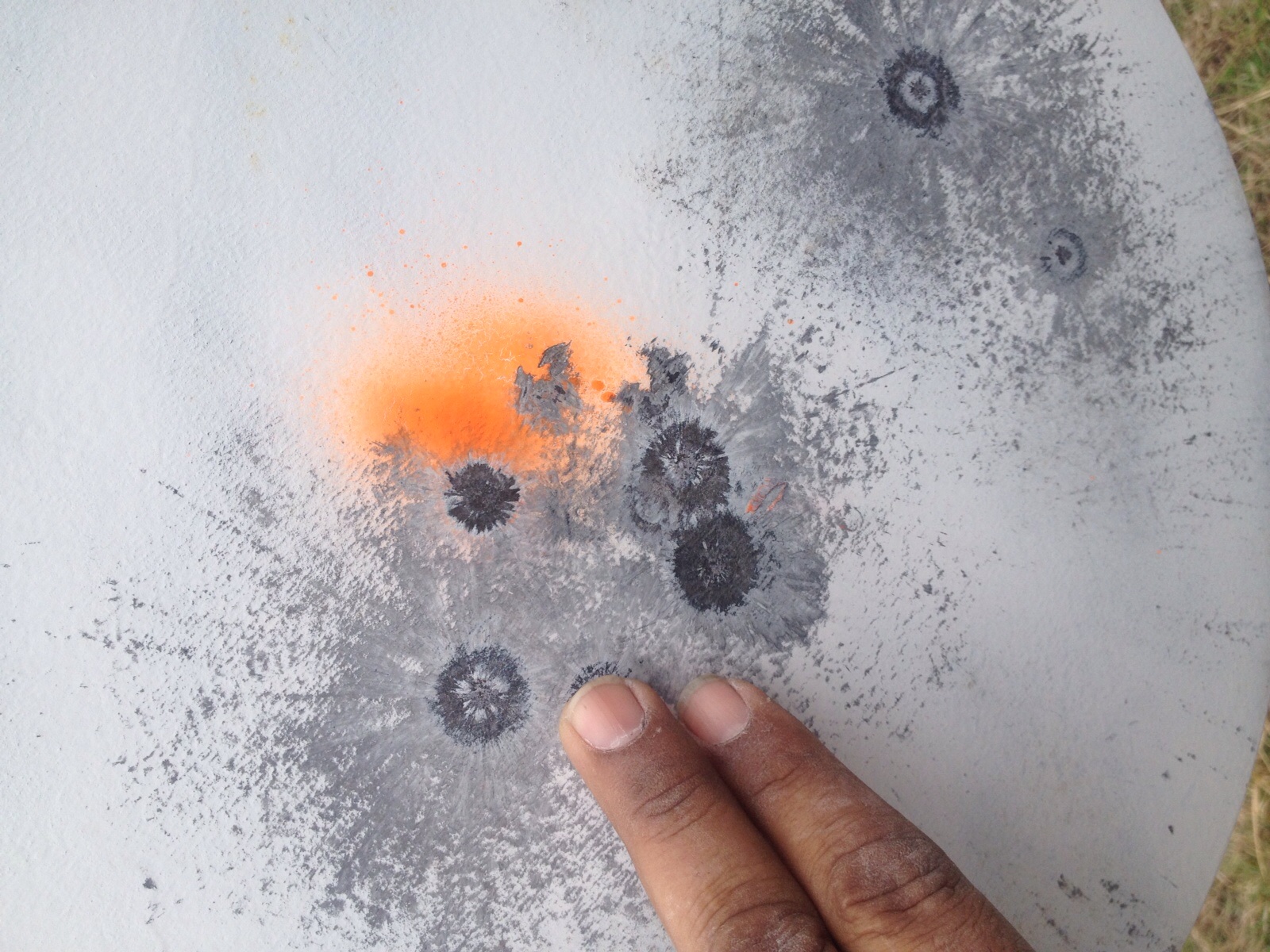

5 shot 100 yards
5 shots 100yards during barrel break-in and with virgin Remington brass. The "flier" was the first shot out of a clean cold bore.

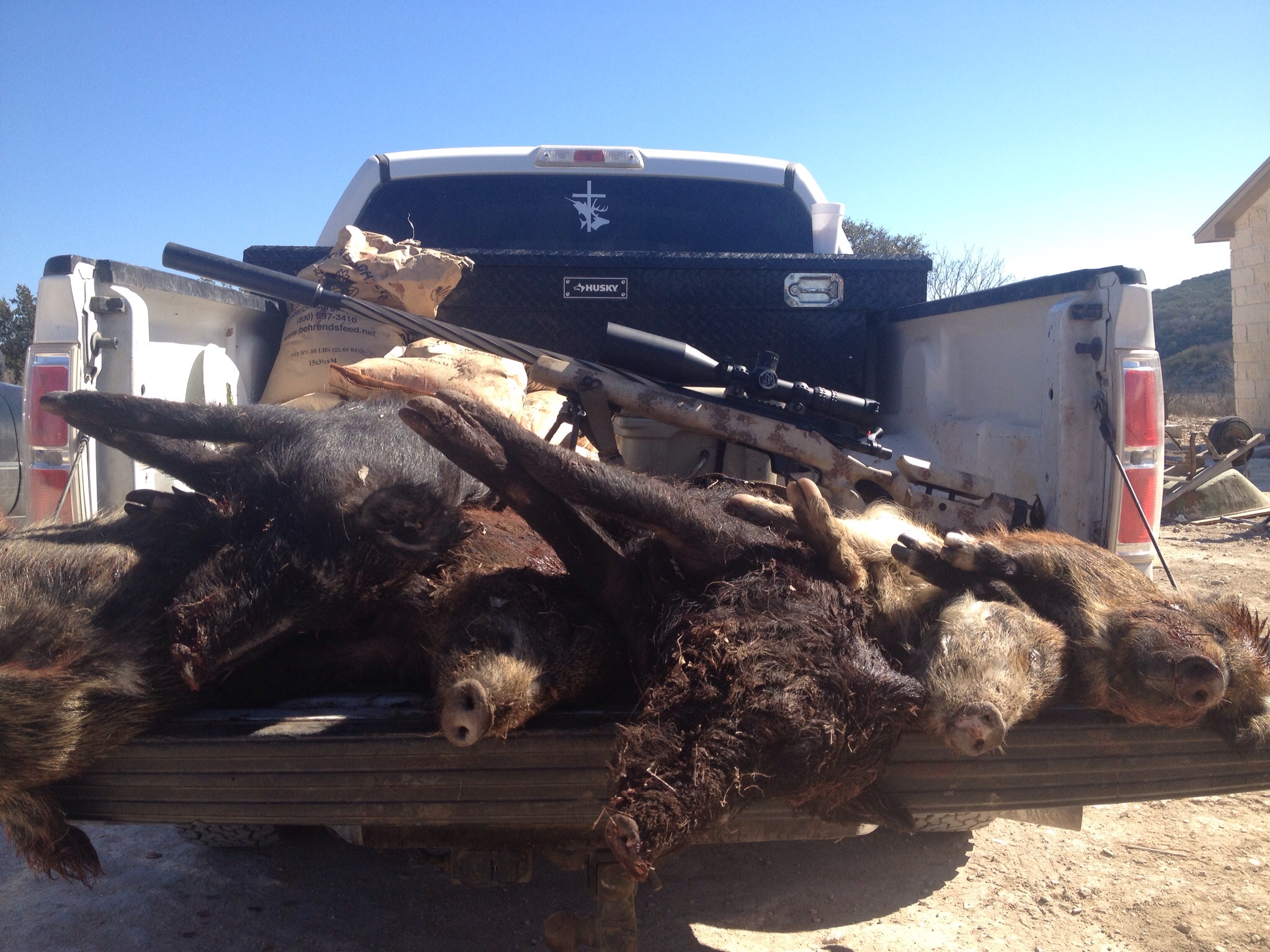

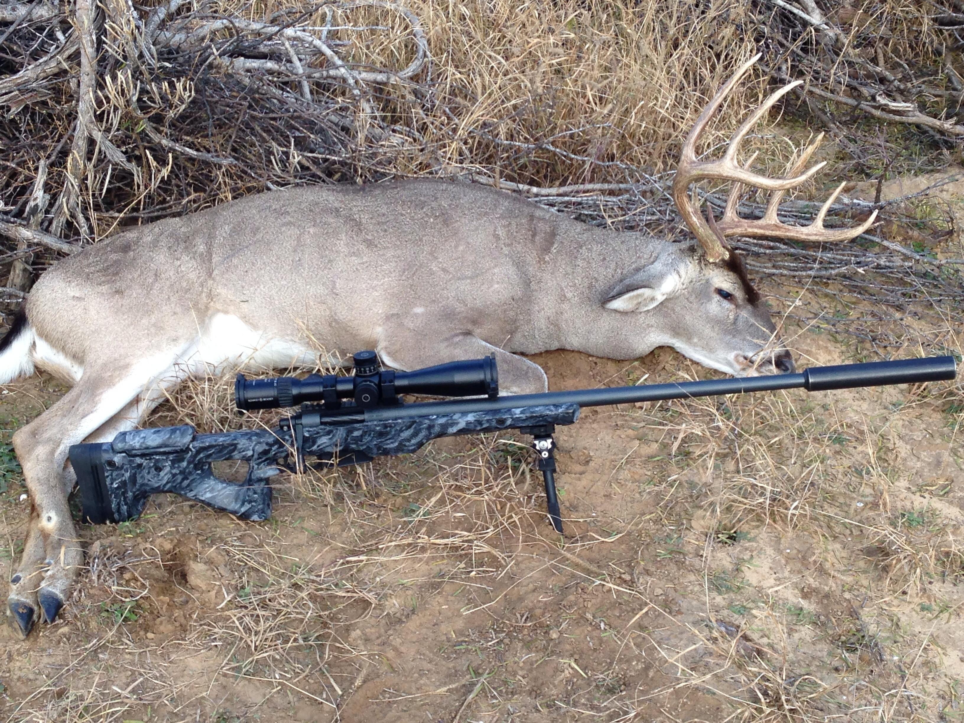

Here are some photos from our hunt this weekend. The SAUM did a number on the fallow doe at 400yrds.

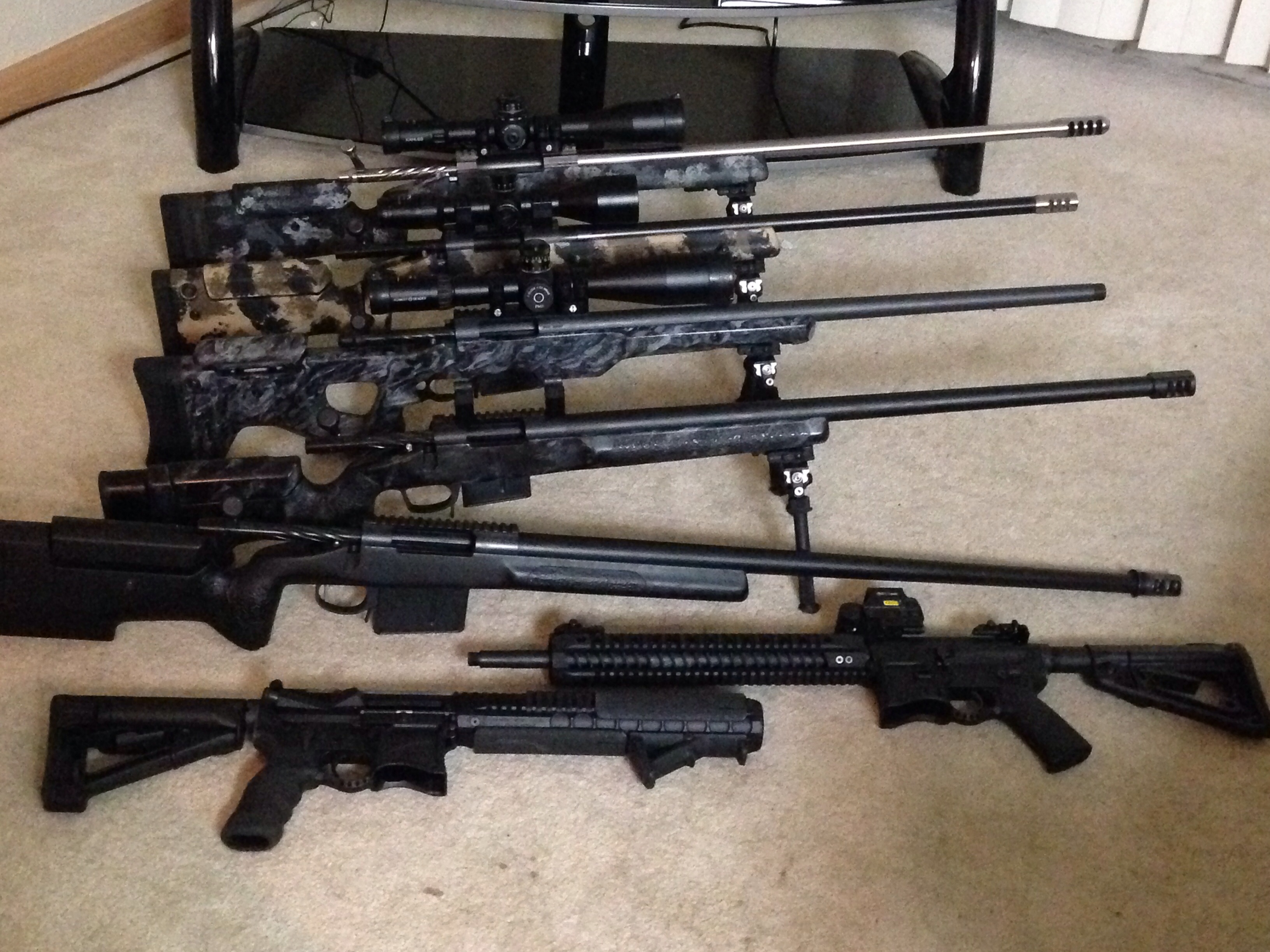

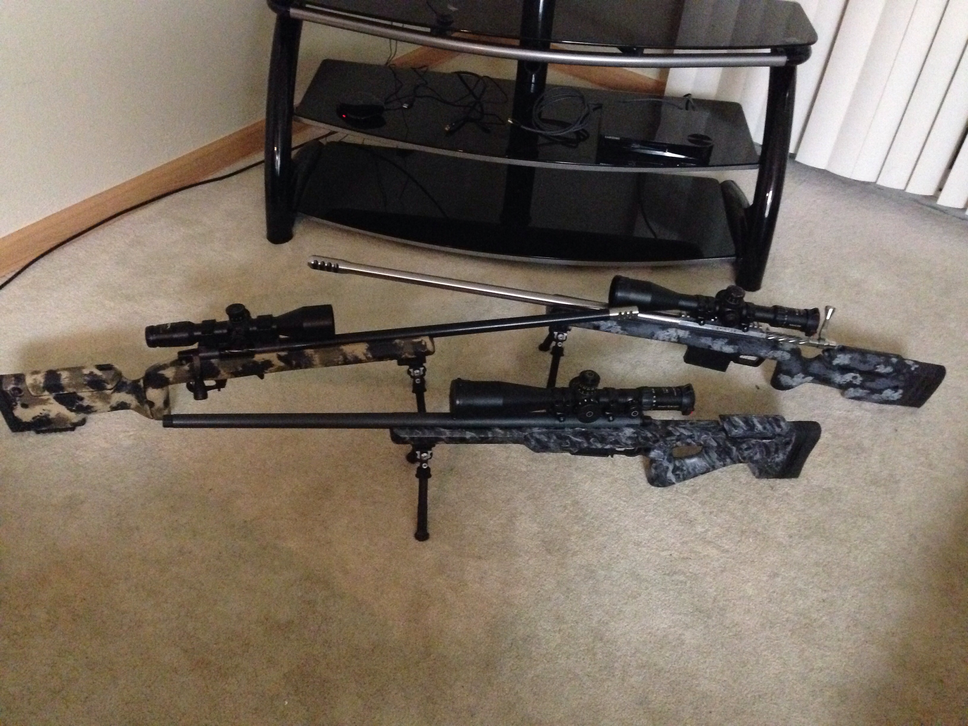

+1 for Omar, he builds some badass guns, he's built me 7 guns this year alone and all of them are 3/8's Moa guns or better
Here are the specs for these builds
338 Lapua AI
Defiance Deviant Lapua action
28" Krieger 9.3 twist with fat bastard break
manners t4a stock with modified defiance dbm
jewel triger @ 1lbs
300 hybrids lapua brass at 3.9 coal
106.5 RL 33 at 2970
6.5 Saum with .188 fb reamer
Bat tactical action
26" Krieger 5r 8.5 twist with omar made break
Manners t4a folder with surgeon bottom metal
jewel trigger @ 1 lbs
140 hybrids norma brass at 2.950 60 thou jump at 3080 fps
130 vlds Norma brass at 2.950 running at 3160 fps
6x284
nighthawk SA Pierce action
27" broughton 8 twist
sentinal stock
jewel trigger @ 1lbs
105 hybrids Lapua brass, 2.954 coal
56grs h1000 @3350
260
bat tactical action
28" hv broughton barrel 8 twist
mcm a5 stock badger dbm
139 scenars 2.830 coal
42.3 grs h4350 @ 2850fps
300 norma
bat tactical lapua action
30" krieger 5r 10 twist with thunder beast break
manners t4a stock with accurate mag dbm
230 hybrids 3.6 coal
89 grs RL33 @ 3050
Top to bottom
338 Lapua AI
6.5 Saum
6x284
260
300 Norma

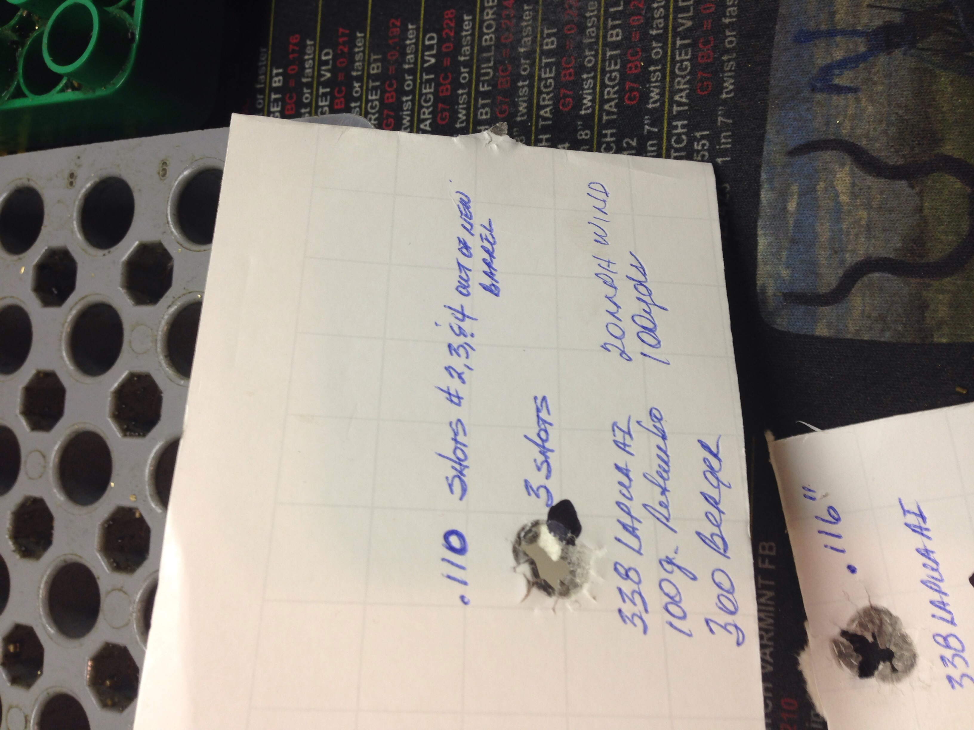

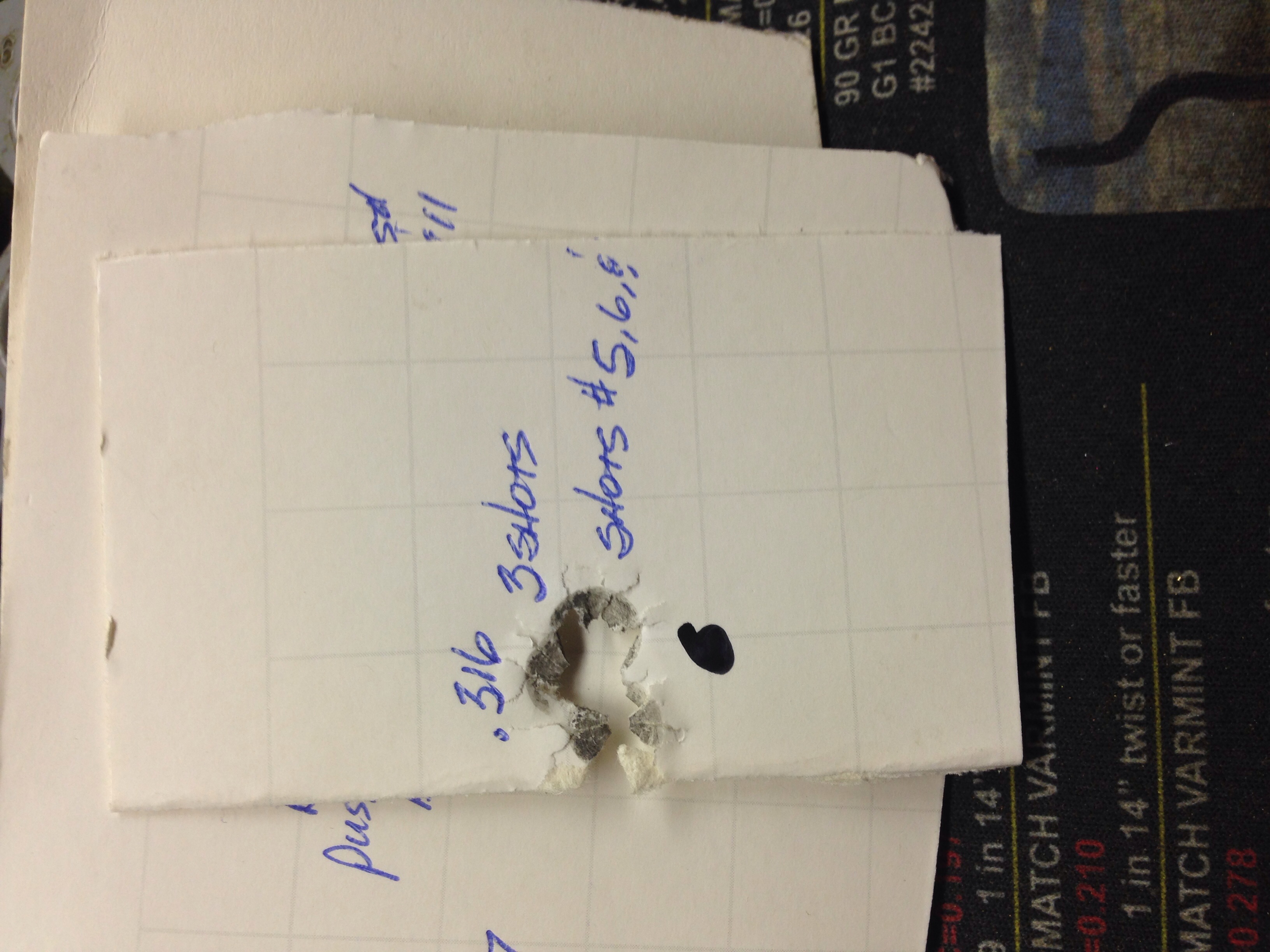

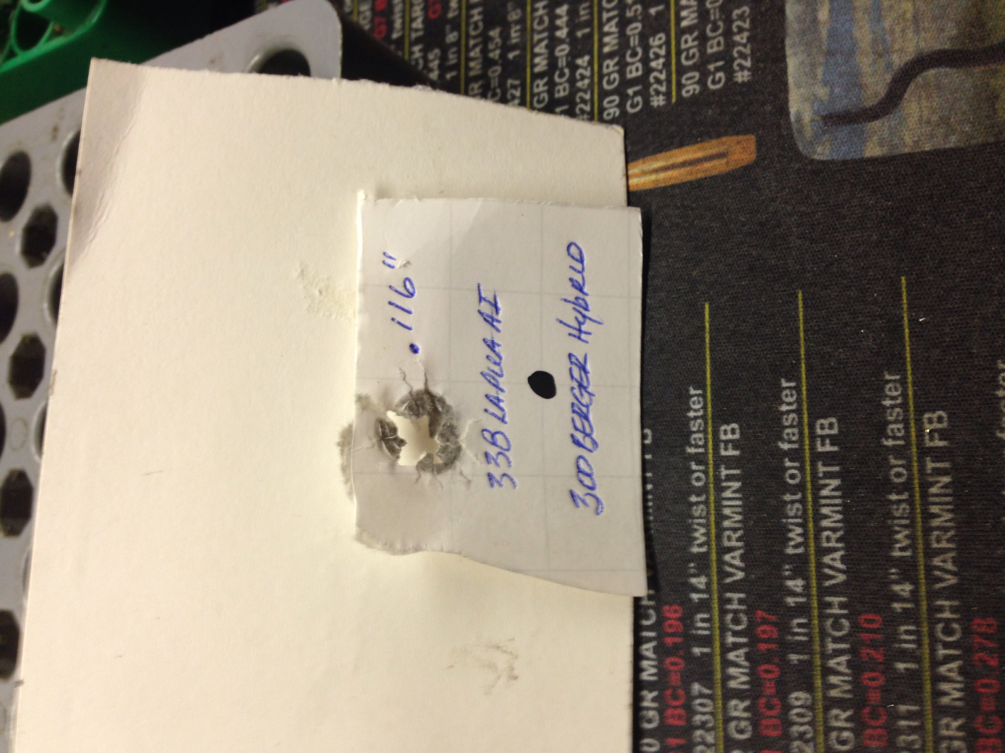

Here are some groups from my 338 AI during break in these were the first 11 rounds through the gun, last pic is at 750 yards 5 shot group
