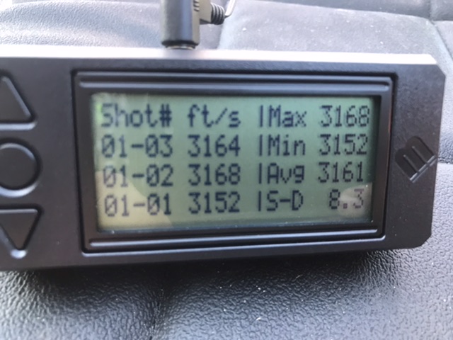

Figured I’d throw this out there for reference data. All was virgin Bertram with br2s and 140 hybrid target. Ended up ditching the h1000 started at 59gr worked up till I was getting more pressure than I’m after for this load(I think it was around 61.5 but can’t remember exactly) topped out around 3050 and maybe .75 best 3 shot group. So went to RL26 started at 59 worked up to 60.7 and started getting light ejector marks so I backed up to a group I had around .5 at 60.5 so started moving the bullet out and ended up with CBTO of 2.216 shooting in the .3s at 3160. Ran up to the hill and shot 2 shots at 800 and 3 shots at 1015 to confirm data had 1 miss at the thousand (this thing cuts wind better than the CM) but good elevation. This week will be finishing confirming bc, working on brass prep to try and drop my sd a bit and take it out to distance next weekend
