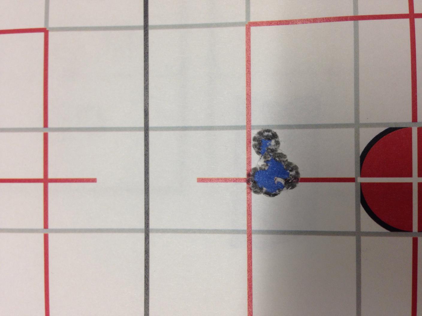

Thanks for everyone's input and helping us all out. I think I came up with a pretty good load.
That's five shots at 200 yards
39.2 gns H4350, CCI450 primers, and Berger 140 VLD's
This round is just plain awesome to shoot!

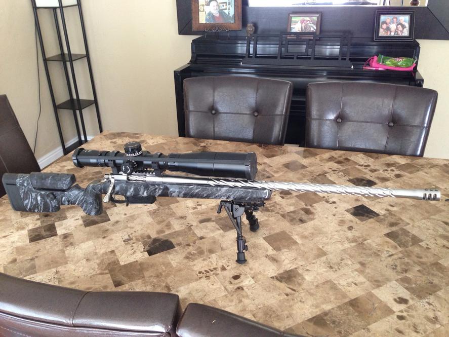

Here's a pic of my gun
Thanks again everyone
