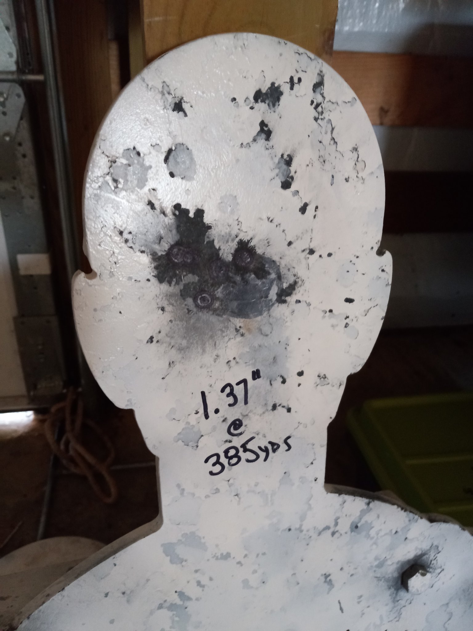

The last time I shot the first 6.5x47L off my porch:
