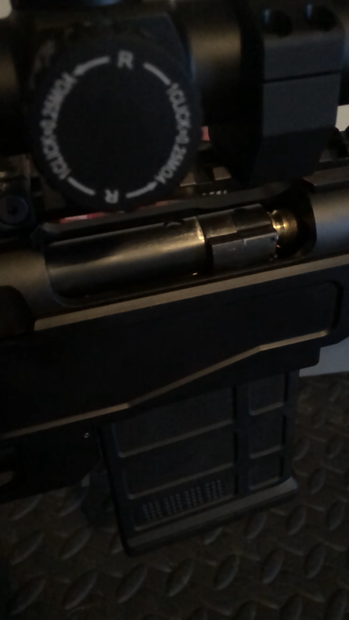

I found a similar thread from awhile ago but there wasn't a solid answer and his issue was slightly different. his rounds were nosing HIGH and getting caught.
I had a savage 10 in .308 that i recently swapped the barrel to a 6.5c. I haven't been able to shoot it yet (sunday hopefully) but I randomly got the idea to try cycling some rounds through it the other evening.
Roughly EVERY OTHER round, the base of the round gets caught TOO HIGH on the bolt face and therefore is pointing NOSE DOWN and binds up as you close the bolt. Then I have to take slight pressure off the bolt so the round drops flat then it will feed the rest of the way. the round feeds about 3/4 of the way into the chamber before binding. With a full 10 round magazine, it'll happen 3-4 times.
only work around at the moment is to just slowly close the bolt, slow enough that when the round clears the feed lips and (rather violently it appears to me) pops up, it gives the round time to 'settle' straight and feed correctly. But if I try running the bolt at a normal speed, I get the binding.
I am using magpul aics mags. I'm not sure if there is something I can alter on them to correct this.
seems to be a somewhat common problem with this savage actions and switching to 6.5. i was just unable to find a clear solution (if there even is one).
attached is a screenshot from a slow mo video where I was trying to see exactly what was happening. posting to show the point at which everything stops moving and is binding up. not the best angle but you can see the base of the round is HIGH on the bolt face and angling down into the chamber.

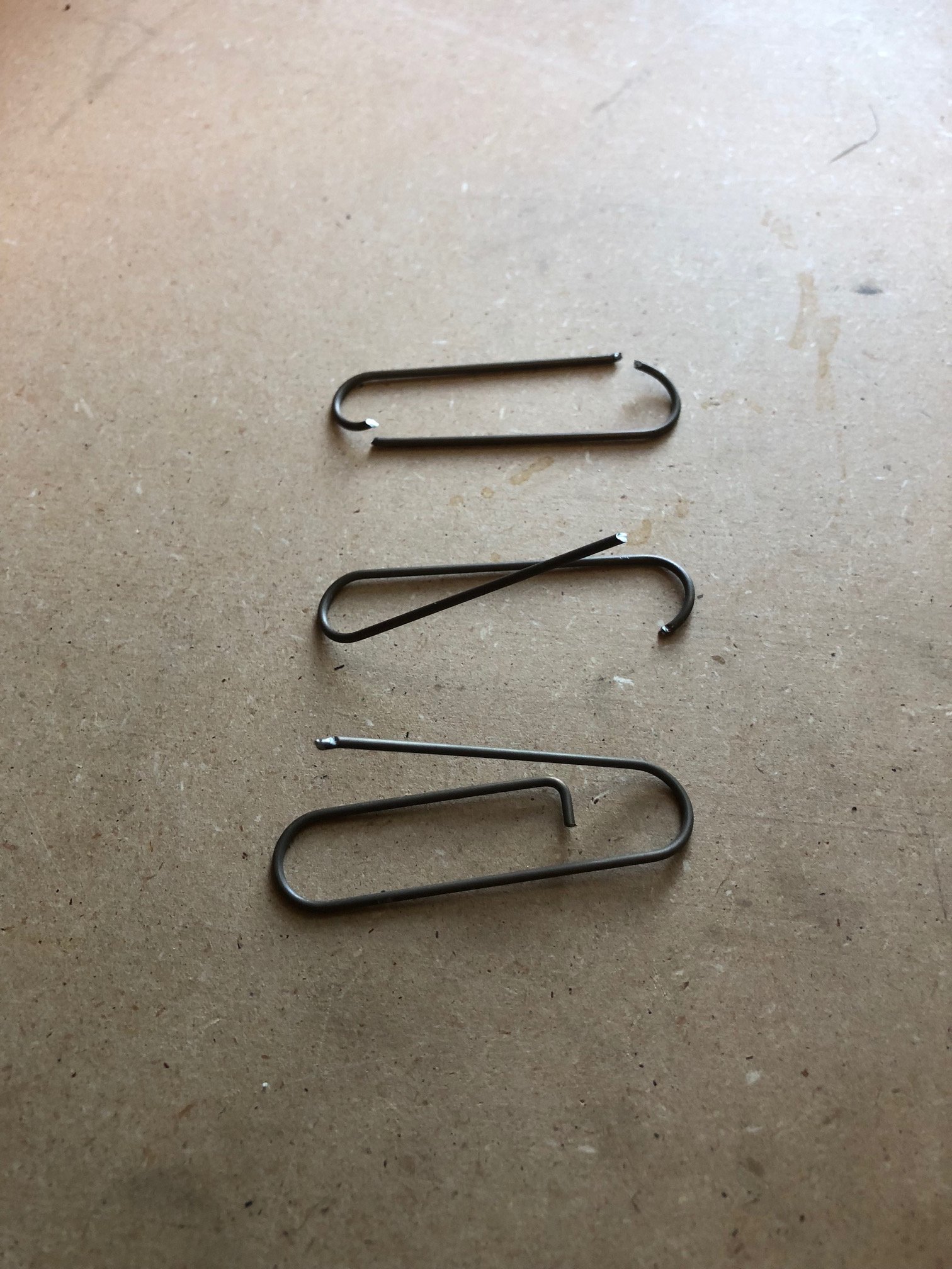

So, with that said this is what I did today with the magpul AICS mags...(the metal accurate mag spring was too difficult for me to cut)
I slowly started trimming away at the spring to hopefully "weaken" it's upward force on the follower. i kept snipping one "loop" at a time until I felt it helped some. I was doing all the "tests" every cut while standing at my bench. and I was getting some inconsistent results. one 10-rd pass would have 1-2 failures, then the next without changing anything would have 4-5. So at 2 loops cut off I decided to lay prone again and try. I was running a whole 10 round magazine with no binding with moderate/fast bolt manipulation. so at this point I'm like "wow, I fixed it!!!!". But the only thing I changed was me laying prone as opposed to next to the bench.
but to confirm my results, I also tried AGAIN prone with an un-altered magazine. I was getting much better feeding this time, maybe 1 round would randomly bind.
whether it be self affirmation or what, I still FELT like the altered magazine felt a little smoother. So I cut one more loop out and kept running rounds through it. I could consistently get all rounds cycled with no binding.
So...conclusion is....if you are having this problem. I think the spring cutting is worth a shot. Have peace of mind that I cut three loops out of mine and the magazine functions perfectly fine still. so in my opinion it can't HURT you, but it MAY help you.
But at the same time, I was also able to cycle rounds in an un-altered magazine much better than I was doing the other evening while laying in a natural shooting position but still would get an occasional stoppage.
So i'm not sure if I actually did anything or not, but I'm telling myself cutting the spring definitely helped.
if you try it, and it helps you, report back.
(None of my little snips were strong enough to cut the spring, so I used a pair of bolt cutters)
Reactions: RFutch
