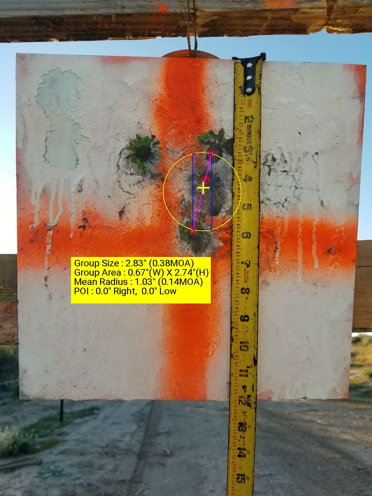

This is @700 yards. Top left is not part of the group as it wasn't shot with it. Even if it was though, the group is still not bad.

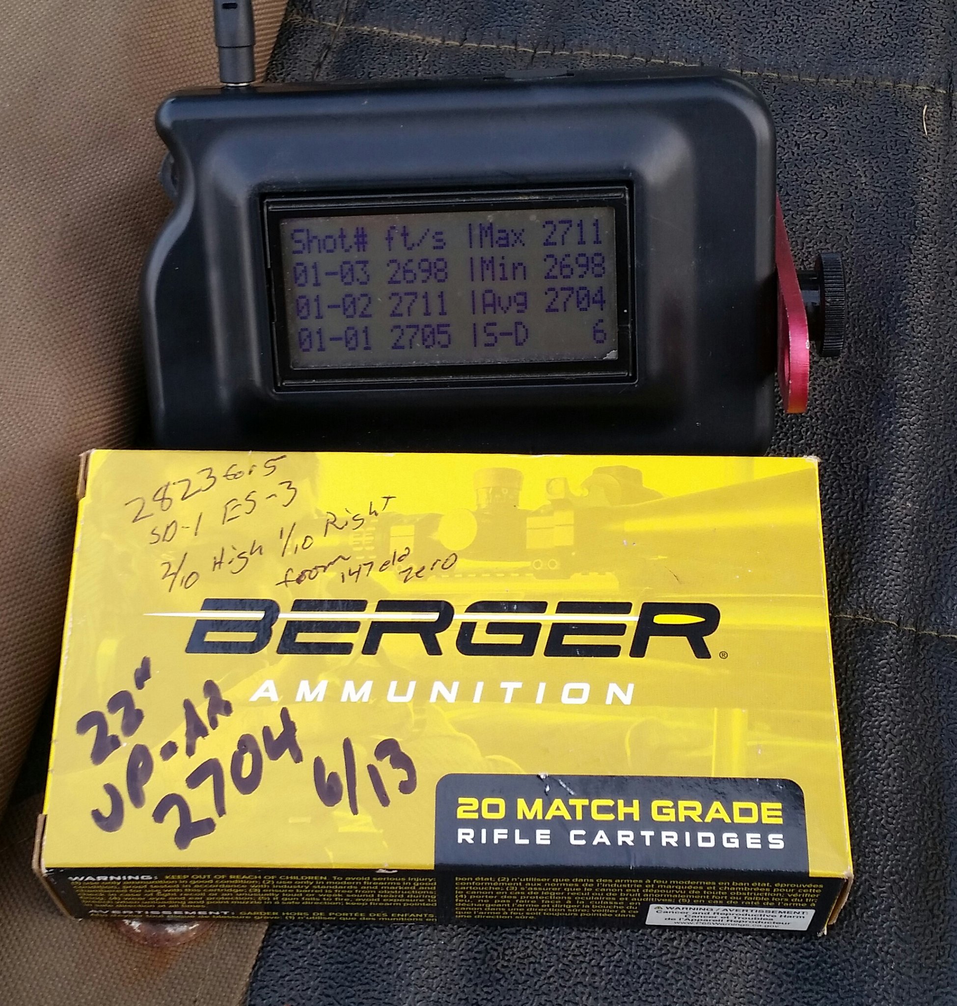

I've got a super slow barrel in 6.5 CM. Shooting factory ammo, as you say you will, it's worth noting that what's on the box is definitely not what you get. I throw my MS3 on whenever I shoot into a new box of ammo. The only thing even close to published so far (and the SD/ES winner) has been the Superformance SST (2860 fps) - not a target load, obviously. The Federal GMM 130gn Berger Hybrids, by contrast, chrono'd 2720 fps from my rifle this past weekend (55 F, 60%, 740 feet). The factory ELD-M went @ ~2585 for the 140 and ~2550 for the 147. I think I still need to chrono my Norma 130 stuff.
Anyway, at those velocities, the 140 ELD-M is a dog compared to the Berger. The 147 is OK. The 130 TMK is still an unknown quantity for me - the published BCs just don't look impressive enough to bother with, honestly. Clearly there is at least one powder combination that'll push decent speed from my bbl, I just haven't found it in any loaded ammo but the Superformance. The good/bad news is that it's really hard for me to find anywhere beyond 400 yds to shoot...so I can run Hornady AG 140 OTM at $.75 a round most of the time because it's "good enough."

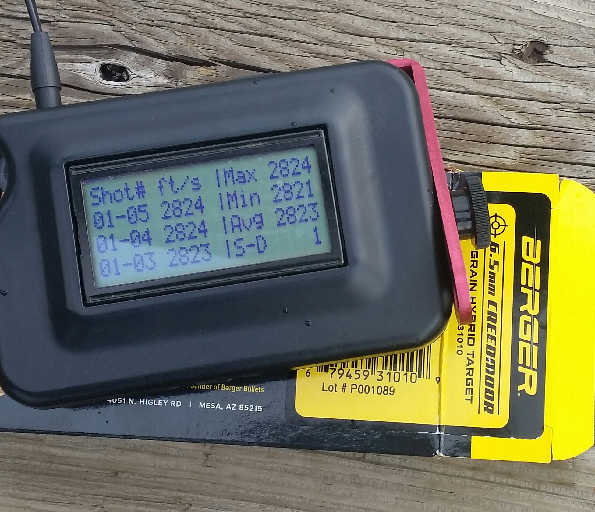

I shoot Berger 130 AR Hybrids at 2825 and only need to dial 7.7 to 1000. My physical altitude is 6200 and according to 4dof my velocity is still just above 1600fps.
That is about my required elevation change at a DA of 1,000 but I get more like 2890 out of the Bergers. My barrel is 26" though and I run a 1:7.5" twist versus the typical 8" twist.
