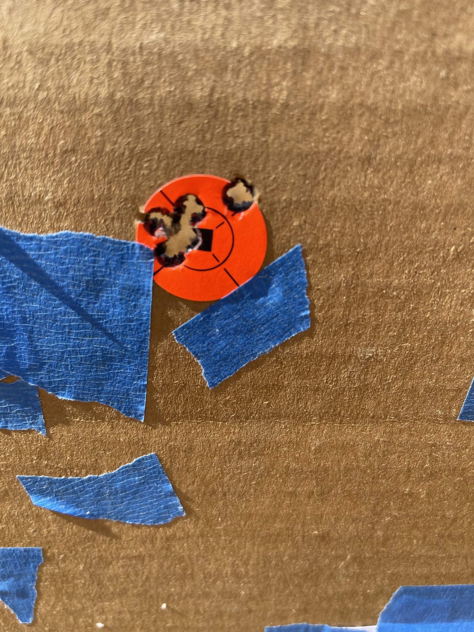

6.5cm 140gn ELD-M troubles.
Not me , this is my 4 shot group out of my Seekins SP 10 , COL is 2.820 with 44 grains of staball 6.5
Reactions: Jscb1b
