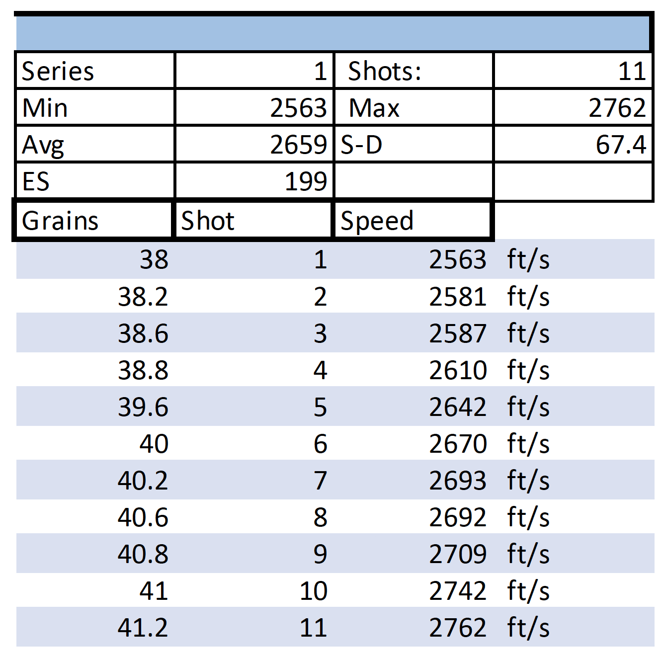

Chrono Data:

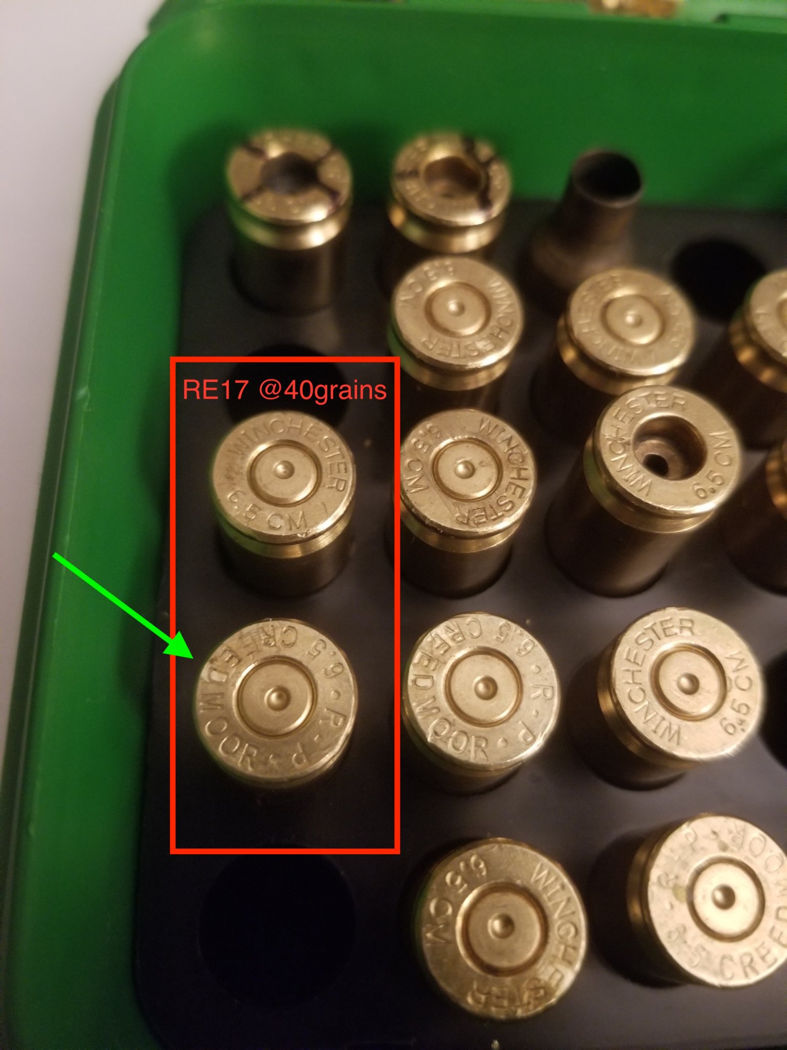

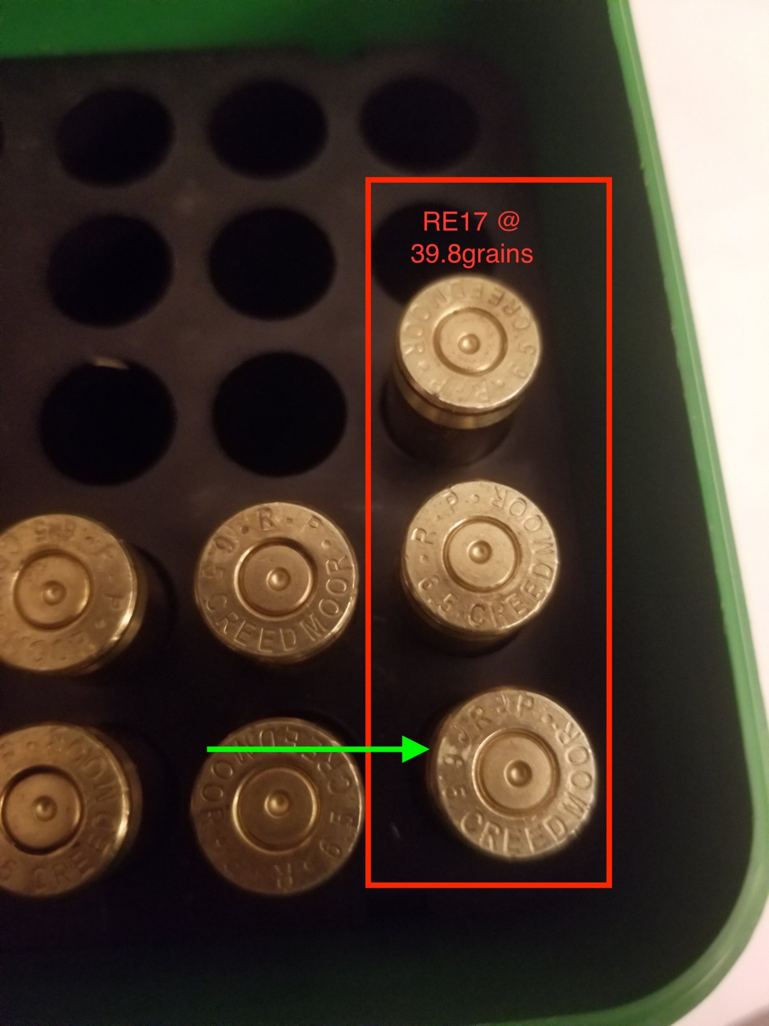

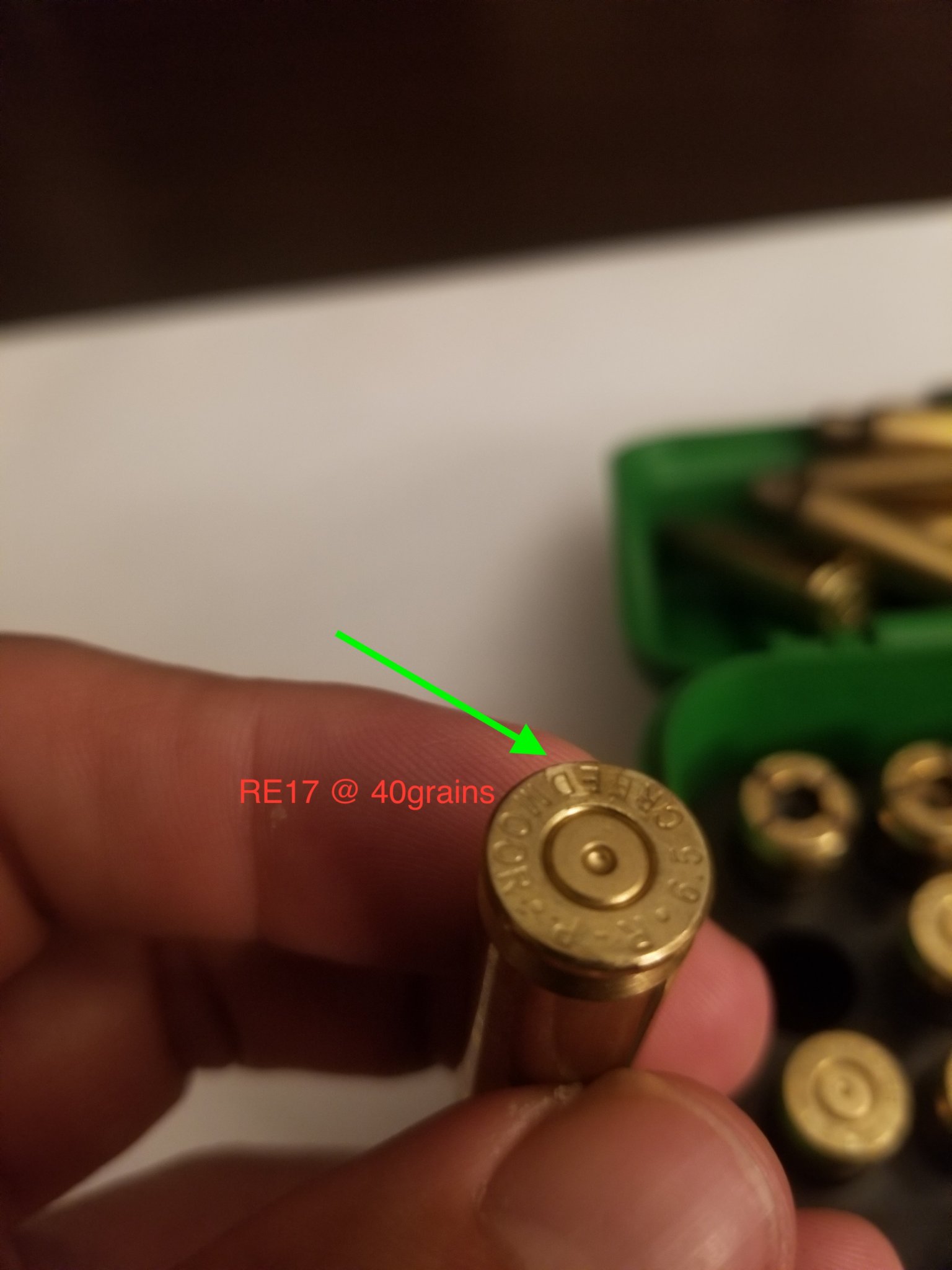

Condition of Brass from Tight Groups:
**Green arrow is pointing to some ejector pin marks noted**
As mentioned above, I identified the RE17 charge of 39.8-40grains giving the tightest groupings. I am having difficulty making a judgement call on the pressure indicators of the spent brass at those charges. I have identified some ejector pin rub marks. At the same time though, the WLR primers aren't appearing flatten nor are there signs of cratering around the firing pin. What should I make of these pressure signs? The Magnetospeed is clocking the velocity of these rounds at approx. 2650-2670fps, which doesn't sound like I'm really pushing it.

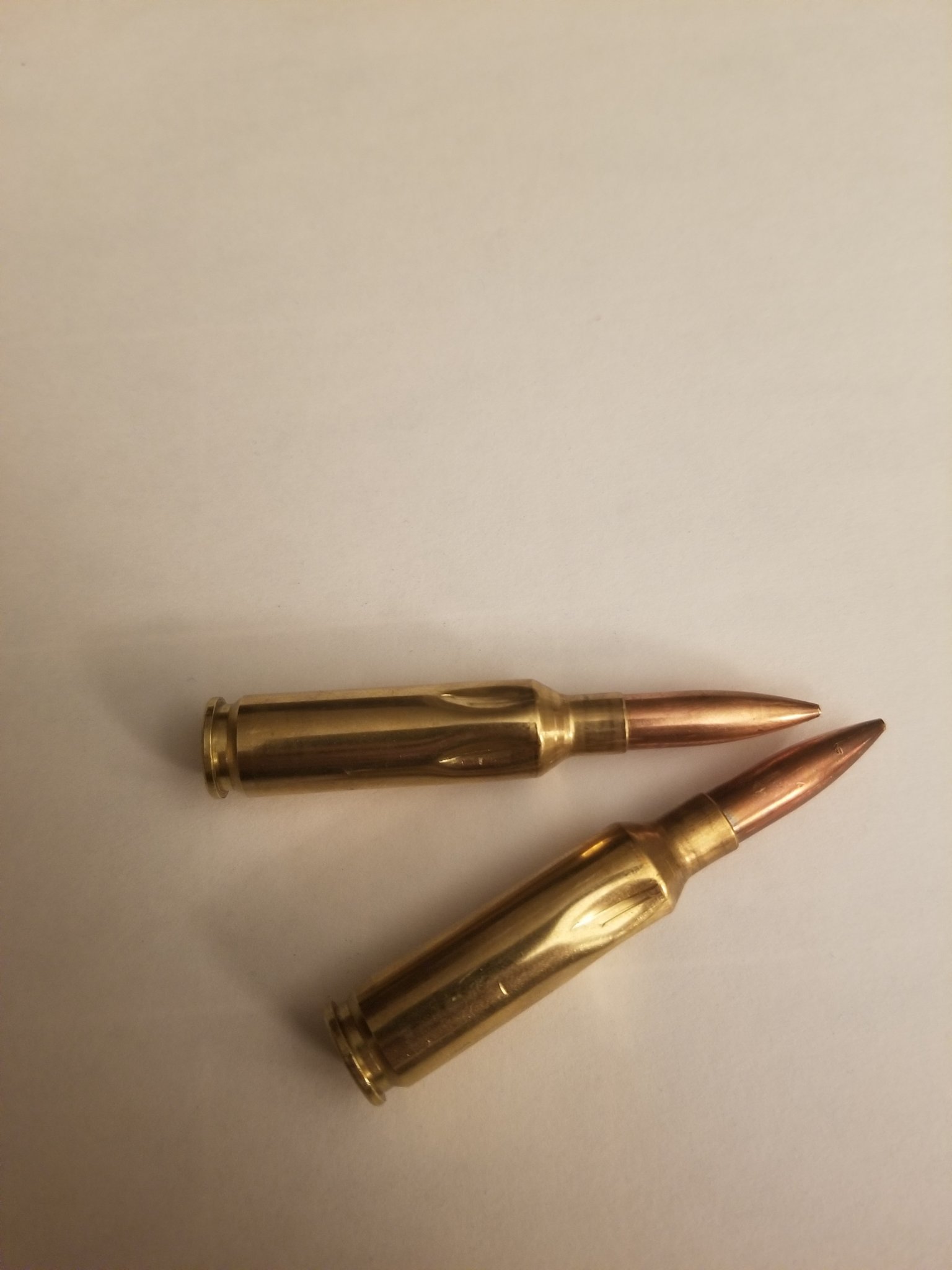

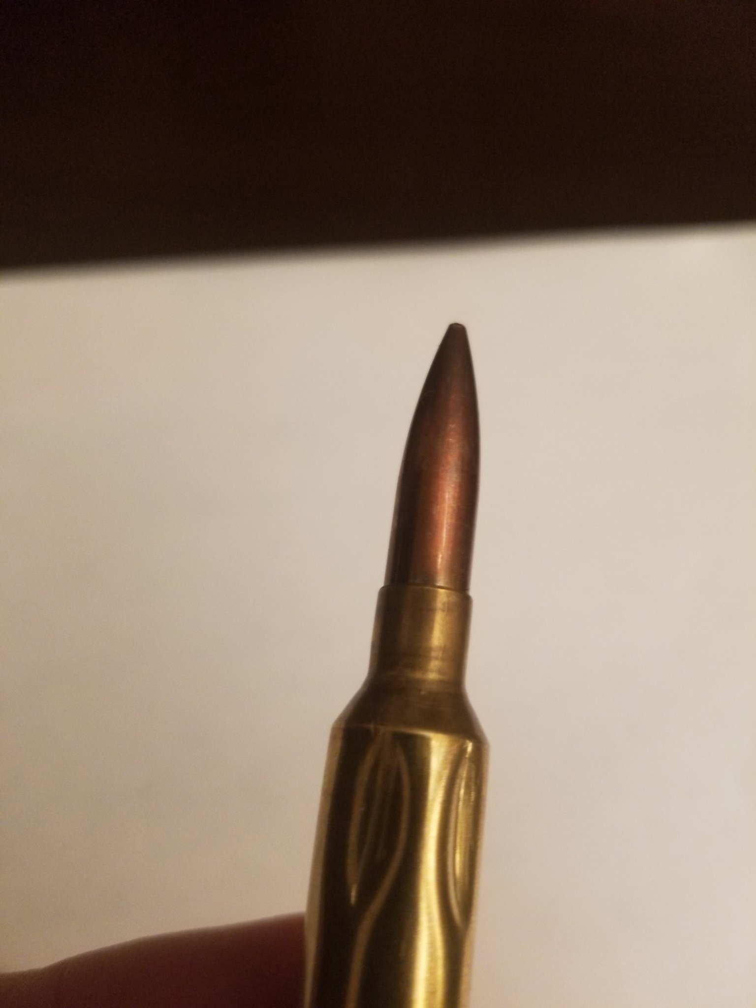

Issues During Range Visit:
Unfortunately, I developed a new issue during this 2nd attempt range, and oddly enough it didn't occur during my 1st attempt. I experienced 3 rounds fail to chamber correctly. The rounds appeared make it most of the way out of the magazine and wedged themselves somewhere between the barrel extension and the chamber. The BCG completely smashed these rounds, in some cases, causing the primers to pop out. Below are some of the examples of the aftermath:

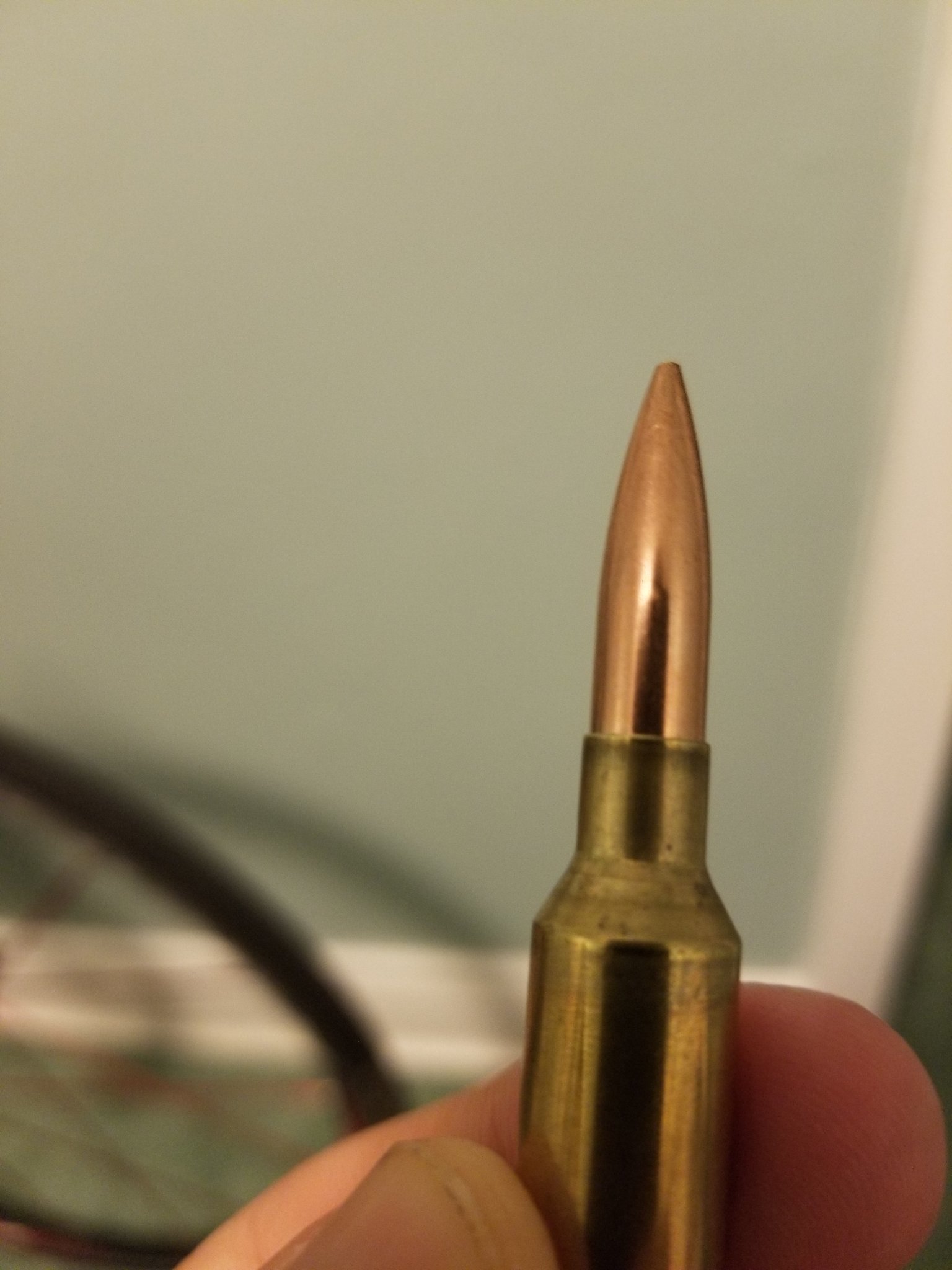

After measuring my my max COL after fitting my handholds into the AR-10 P-mags, I noted that it was less than the max COL as noted in my two reloading manuals. I did decide to come back a few thousandths from the max COL as allowed from my magazine. What could be causing this issue and where should I look? I will provide the specific measurements later tonight, as they are in my reloading record book at home. I personally feel that it might be an issue related to length, but I'm not experienced enough to be certain. All my brass was full-length resized -.003 from fire-formed.
Thanks for any and all help that you can provide!
The rounds that got jacked up during chambering, I would load one in the mag and see if the bolt is locking back on the bolt catch. It could be under-gassed and the bolt is riding over the cartridge upon chambering, or the follower/mag spring are not popping up fast enough to get the cartridge in front of the bolt. If the bcg doesn’t lock back, either the loads are too light or the gun is under-gassed. If the bcg does lock back, perhaps the magazine is the culprit. Clean the magazine body, maybe replace the mag spring or try stretching it out some.
Question: are you only considering the 140g bullet? I have a RPR that loves the 147g, yet others with the same rifle use only 140/143’s. What is your barrel length? That could impact your consistency if the barrel is shorter. Also consider a different powder to see what you get out of them.
Also, what magazine are you using? You might see if you have a mag issue. Is it possible the base of the round on top is dragging the round underneath forward in the mag as it is chambered, causing the next round to jump when loaded?
I don't know enough about an AR-10 to comment on what might cause that damage to the cartridges, so someone with good experience will have to chime in here. But as far as your loads go, they are as you suggest, pretty mild. . . almost too much so.
It would help to know what barrel length you're using here and what your cartridge COAL is and the ambient temperatures your shooting in. From what it looks like in your pics, the COAL's look very long. And if they are, they might be jamming into the lands causing higher pressure . . . which might produce the ejector swipe your seeing even though the powder charges are relatively light. If you haven't measured your distance to the lands to see what room you have for your jumps, it'd be a good idea to get that measurement.
Keep in mind that RE-17 is very temperature sensitive.
BTW. . . IMHO, it's not a good idea to shoot until you the barrel can't be touched (if precision is really important) as that's usually above 130°F. I will stop at 122°F to let it cool down some and I know the temperature as I have a strip (a Temperature Label) on my barrel so I can keep track of how hot the barrel it getting (especially important this time of year here in AZ).

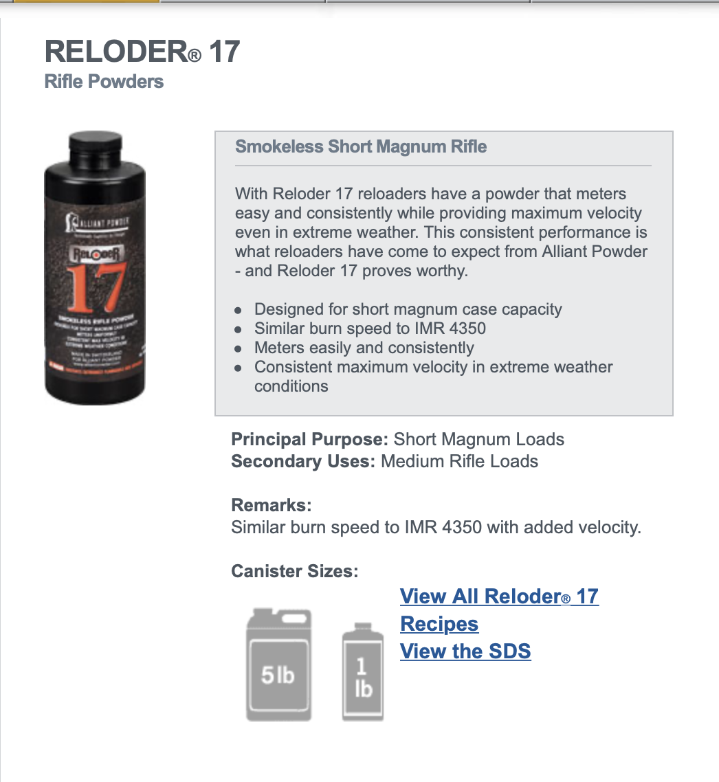

Concerning RE-17, I was under the impression that it was supposed to be stable, relatively speaking. I understand that every manufacturer can make all the claims they want on their products and that the proof is in the pudding. With that said, here is what they advertised, of which I came to kinda understand:
The last bullet stating "consistent...velocity in extreme weather conditions" made me believe that equals non-sensitivity. I'm not trying to argue with you, I'm just trying to get smarter at this stuff. What do you make of this? If this is bad gouge, where should I go to reference an accurate depiction of powder characteristics?

Just a couple of observations from your target and chart:
  • You DO NOT want either 39.8 or 40.0 gr load. You should not be looking for “smallest group” at this point.
  • You should be looking for a stable node.
  • Both your target and your chart indicate that that node is somewhere in the 40.2-40.6 range.
  • Neither 39.8 nor 40.0 are in a node and are not stable.
  • You chart shows both 40.2 and 40.6 at the same speed. Why did you only record velocities for every other charge?
  • Your OAL does look long for a semi. If I were you, I’d find some way of verifying approximately where your lands are.
Reactions: MNtadpole

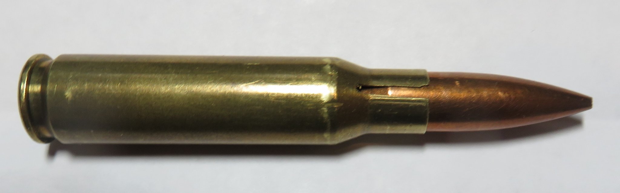

The Hornady gauge works fine. Or you can use a dummy round with a loose neck configured like this:
. . . slip it in, close the bolt, extract carefully and measure. It's not likely going to be "exact", but it plenty close enough to work with.

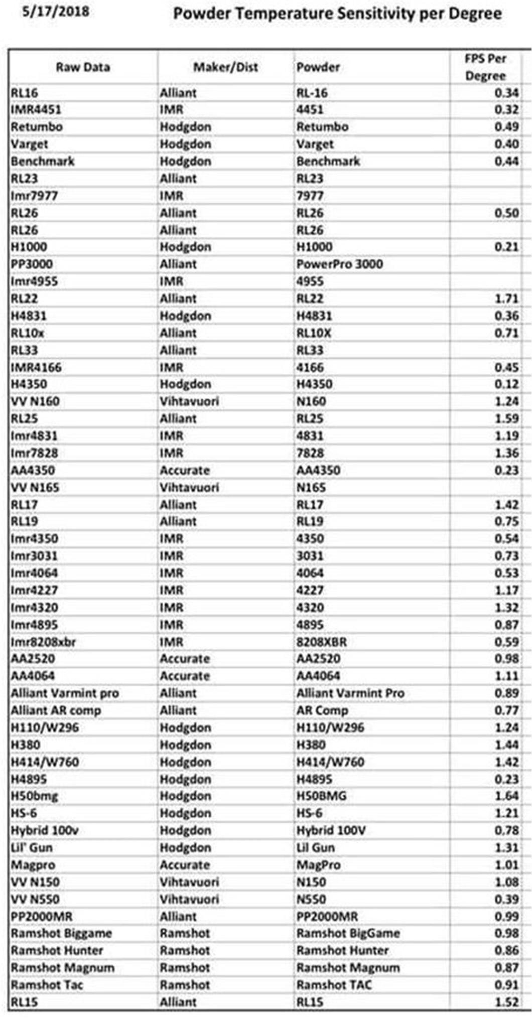

It's one of the most temperature, here's an example:
I've use this powder in my .308 cartridges and found a load that works quite well. But I decided not to use it because of this issue and the wide temperature swings I have here in AZ. Many other powders can work well with less sensitivity. But . . . these days, find the right powder available is a challenge.
I will take the node focus on board. I guess I got too caught on tightening up the groups and forgot about monitoring for nodes.
Leading up to this shooting session, I had only made 4 rounds per charge. My thought process was to do 3 round strings, while having a 4th round if I had a flier. The goal was to not have any fliers and to use the 4th round for a separate Chrono test. Because of some fliers, I did end up using the 4th round. That is why I didn't Chrono every string.
I agree that I should look into the measurement of the distance to the lands. It's an unknown at this point since I don't have a measurement. I will look into getting the supplies to measure this out soon.
