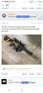

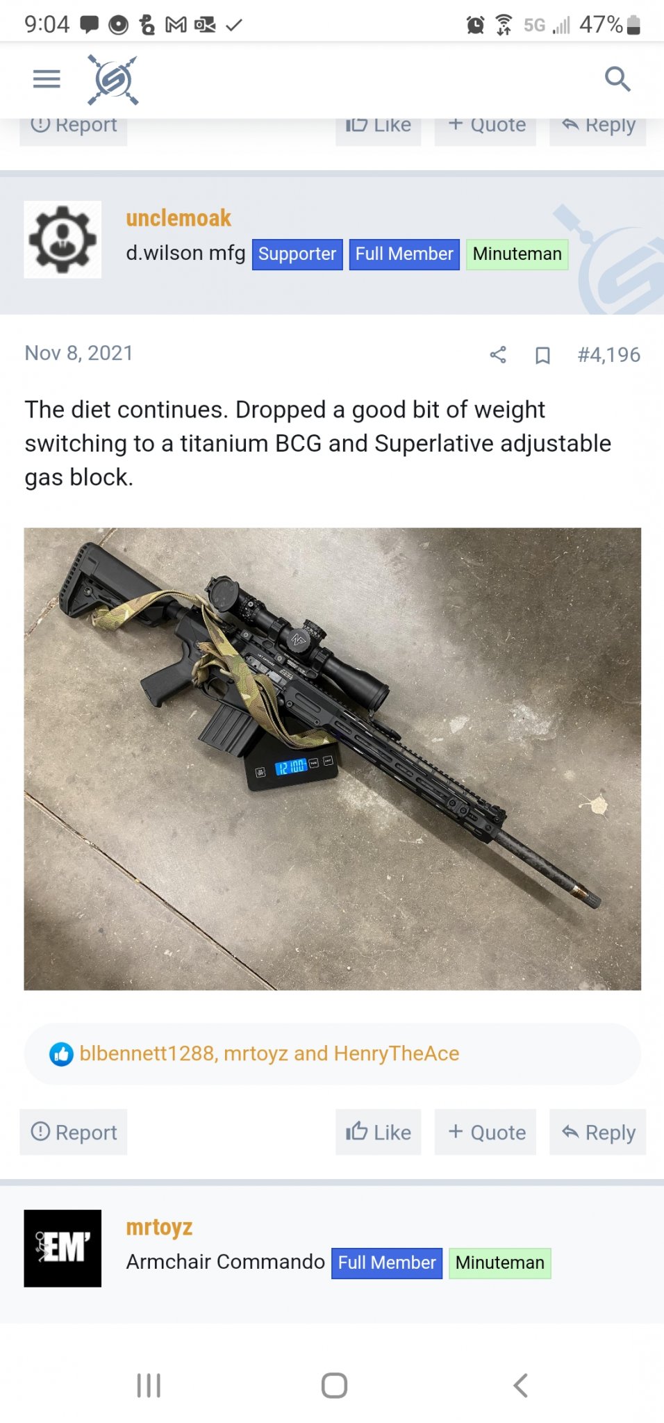

LMT MWS thread, page 84, post #4196. With some machining and a Proof conversion, @unclemoak got his rifle down to sub-13 lbs with optic. Then he proceeded to run that setup in a comp and did very well. LMT may still have some cheap LM8 uppers you could have chopped up.
@unclemoak is exactly who I was referencing when I said the conversion was too expensive. Unfortunately, his rifle is exactly what inspired me to go down this path. I just can’t justify spending nearly $6k on the rifle alone.
