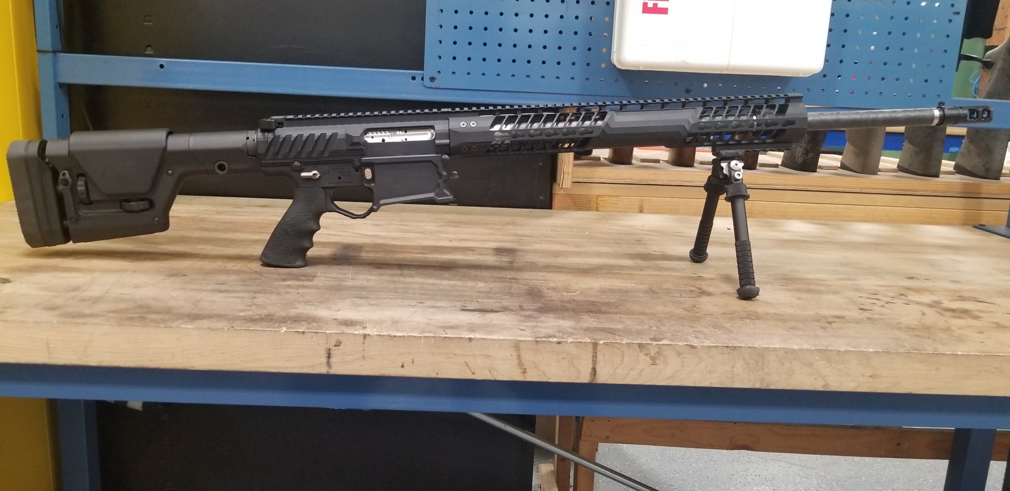

Well she's mostly put together. Went with the High speed National Match trigger, just waiting for it to show up. In the meantime, I have a free Timney Targa 2 stage showing up today so I'll give that ago while I get the gun all adjusted and running smooth. Kahles K525i will be a couple months out still. Really looking forward to seeing what she can do!

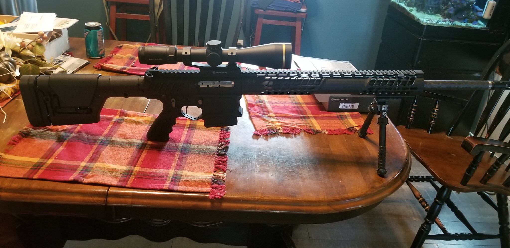

Took the rifle out today to tune the gas block and function check it. Shooting 140gr Nosler RDF's I had no problems. Did a quick sight in and was able to get just over .5" five shot group! Failed to have my phone on me. I am extremely happy with the rifle, now to get the Geissele NM trigger in this week and head to the range with the photo taking device. Can't wait for new glass to replace the VX6
