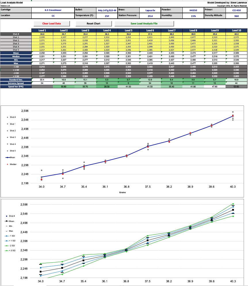

Brass is Hornady large primer, loads are 41.0g of H4350, 147g HDY ELD-M bullets, primers are the CCI 250 large magnums.
(This gives me SD of about 5 fps, the result of 50 round ladder test.)

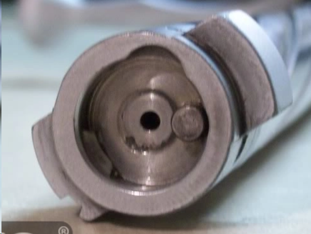

Also, as I mentioned in my last post, if your bolt doesn't have a small diameter firing pin (0.068" max diameter, 0.062" even better) I would not recommend trying the small primer brass in it; small rifle primers with higher pressure and a large diameter firing pin is usually a recipe for pierced primers.
My GAP-10 as delivered had a DPMS BCG with a large firing pin and it would pierce around 30% of Hornady 140 A-Max factory ammo; on the second trip to the range a piece of primer stuck the firing pin and the rifle ran away full auto slam firing. Very lucky it didn't go off out of battery and damage the rifle (or me)... GAP swapped the BCG for an Armalite setup with a 0.062" firing pin and all primer problems went away.

I have the JP High-Pressure EnhancedBolt with the titanium firing pin, it's got a tiny business end so I'm not worried about overpressure and/or piercing primers.

Last night I primed 200 cases of brand new never fired Lapua with CCI #450 and they all went in very nicely.
(I also primed 300 cases of Lapua 300 blackout and those were so tight I got blisters and the RCBS deluxe no-shell-holder-needed primer tool spring-launched a few cases, but I had a smile on my face the whole time.)
I need a different neck size bushing (.289) for Lapua brass though because it has thicker walls than the Hornady. (.288)
I don't turn necks or mandrel size, not yet anyway, happy with my accuracy needs without that and probably not necessary for semi.
I just got my Mitutoyo calipers, so no screwing around with dimensions this time either.
When the bushing comes in I'll be setting up for another 10 charge, 50 round ladder test with the chrono.
Hot damn, now I know why Lapua brass rocks. Here's a chart spanning the charges from minimum to maximum from the Hornady reloading manual. Check out the stats on Load 5. unfortunately, 2350fps is a little slow so I'm going for Load 9. ALL of these are better than Hornady factory match ammo.

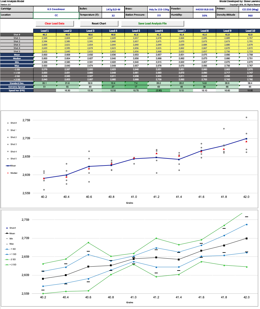

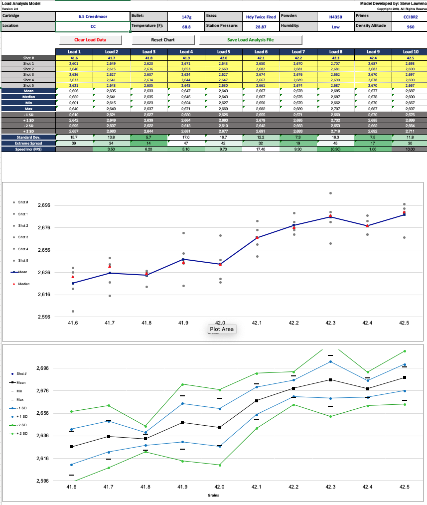

Here's what I was getting with Hornady Brass, CCI BR2 / 250 large-primers, chasing that fps trying to get 2700 and probably killing my brass in the process. (Remember 40.3 is max load according to THE BOOK. :) )

You can see from my charts the difference it makes. Granted, they aren't the same loads or same primers or same conditions but I'm definitely seeing an advantage with Lapua even if I have to sacrifice some fps with lighter loads. I hope it stays that way or gets better (these aren't even fire-formed cases yet.)
Edit: To get all this data I've got to strap the magnetospeed to the barrel which throws off all the harmonics and point of impact etc... but in general the most consistent load groups the best. One of my previous loads had no vertical variance and if I'd had been better on the bench horizontally they would've all gone through the same hole.
