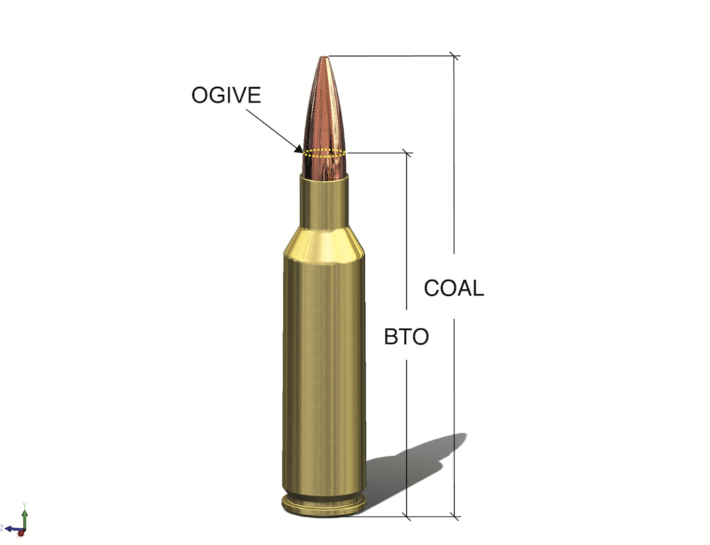

I think you are confusing Cartridge Overall Length (C.O.L.) and Cartridge Base To Ogive (C.B.T.O). The COL is base of cartridge to tip of loaded round, the CBTO is base of cartridge to the Ogive. The Horandy gauge is telling you the distance from the base of the cartridge to where the Ogive is touching the lands in your rifle not COL. It is not possible for the COL to be 2.800 and the CBTO to be 2.65.

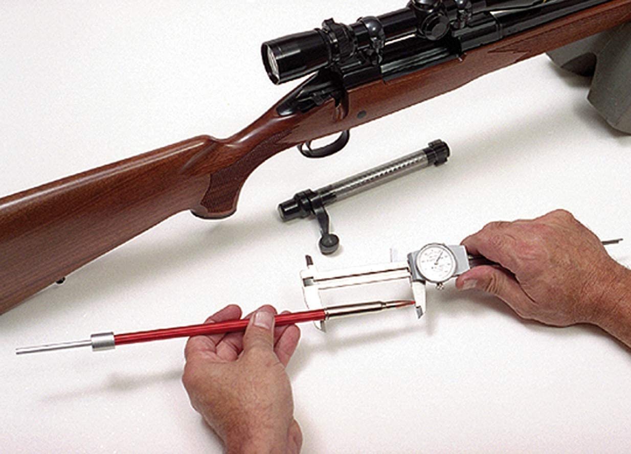

I have an older Hornady O.A.L. gage that I used on my Tikka 6.5. The OAL was 2.93 with a Hornady 140 ELD Match bullet touching the lands. The length of the factory load was 2.81. I tried various lengths including 2.92 OAL and generally saw no improvement but did load up some @ 2.83 to try as that showed the most promise.
I appreciate all the responses. No typo, that's why I'm concerned. It sounds like I made an error. I don't think I mixed Ogive with COAL, but just to make sure my process was:
Attached modified 6.5 CM case to OAL gauge and took out bolt (Rifle is bolt action Tikka with Krieger bbl)
Grabbed one of three Hornady 6.5CM 147g ELDM bullets and inserted into modified case
Backed bullet way into casing and inserted casing into chamber until full stop
Pushed grey insert to push bullet fully forward until full stop and use thumb screw to hold measurement
Remove gauge and ensure bullet is against grey insert and then measured base to tip
Repeated that process 2 more times with that bullet, and then repeated 3 more times for each of 2 other bullets from the same pack.
Measurements were all in the 2.647 to the 2.655 range so I settled on 2.65 length tip to base is touching the lands, so I loaded to 2.63 tip to base.

For some reason this is hurting my head or I'm just not understanding. You don’t measure cartridge base to tip of bullet with the Hornady OAL gauge. What you’re trying to measure is the Cartridge base to where the ogive hits the rifling. You do this with a set of calipers and the attachment that came with the Hornady gauge attached to those calipers and then in your case with the 5-26 insert attached. This measures from the base to the ogive or CBTO. This is the measurement you want. Then you can back that measurement off .020 if that’s where you want to start. If you’re measuring from base to tip of bullet, that is incorrect.

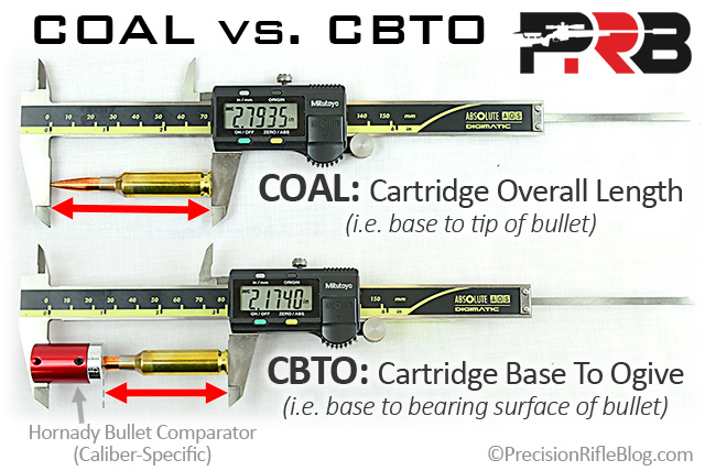

I went and bought a Hornady bullet comparator, remeasured per above posts, and getting reasonable measurements. Consistently 2.895 COL so will start at 2.875 for my first reloads and work from there. I appreciate the assistance.

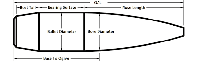

So OP, and to other people who dont know what they are talking about: The nose of the bullet where the copper gets pinched down can vary more than the full diameter bearing surface of the bullet. As such measuring off of the most consistent part of the bullet is preferred over the part that varies more. The ogive is technically the entire curvature of the nose but for reloading we care about where the bullet actually touches the barrel which is right in front of the full diameter on the nose.

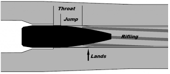

So the part labeled jump is going from the bullets bearing surface right just on the ogive to the lands where the barrels rifling begins which is where the bullet meets the barrel. When you are using the oal tool you are trying to find the point where the bullet touches the lands and you have zero jump so that you know where your bullet actually is in relation to the chamber.
In your creed your barrel will have a .256 hole and then it will have some extra material scooped out to a .264 measurement. The bullet comparator is cut to measure right about on that ogive spot in the middleish of the lands, it should be something like a .260 hole with a slight amount of taper which puts you pretty close to the middle.

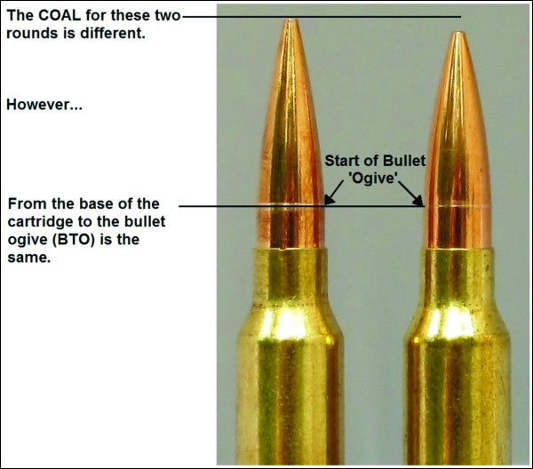

Different bullet shapes will have different over all lengths and positioning from one another when measured from a consistent point such as the ogive. So the COAL number for an ELD bullet wont equal a number for a SMK bullet.
View attachment 7328222.

Thanks Spife, I learned some things as well! I've just always used CBTO as the measurement not worrying about the COL unless my seated bullet didn't fit the magazine. But your explanation makes perfect sense to me now. Much appreciated! Sorry to the OP as well, what I probably should have said is "less accurate" as opposed to "wrong". Apologies also if I 'semi'-hijacked the thread!
Great forum, all very helpful. Measuring the CBTO with the comparator got me on the right track (and out shooting) and I’ve gone back now based on all this information and duplicated the results using COL as well. Amazing how understanding the concepts makes executing the process easy. My theory on the bad initial results (as someone mentioned) is that I was starting with the bullet too far in the modified case so when I pushed it forward it was canted and the tip was catching a groove or land prior to straightening out. Either way, heading back to the range today. Thank you all.
