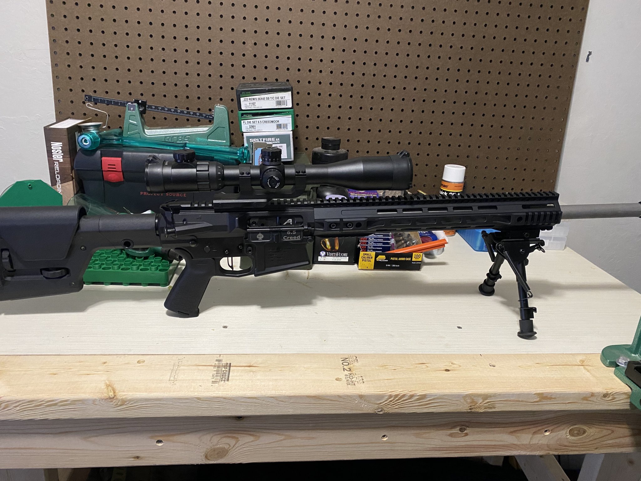

6.5CM Reloading Questions!
jarrington282
Jan 19, 2020
22
2
Hide fam,
It has been a little bit since I have been in the reloading game, and mainly when I did in the past (10 years ago) I had a friend help me out a little bit. While the internet has evolved I have done a ton of research but most things I've found are pretty dated on powders, bullets, etc...
Alright gun info
AR-10 Build
- Ballistic Advantage (PS) 22" 1:8 Twist 6.5 CM
My Goal with finding the best load
- To get the best groupings I can (obviously) and when the time comes shoot 500+ yards (we only have a 300-400 yard range around me within a 2 hr drive)
I am planning on doing the following:
Brass:
Mixed (Test a few brands like Lapua, Hornady, Nosler)
Primers:
Mixed between CCI No.200 LR, CCI No.400 SR, Since 6.5 cm brass evidently fluctuates between small and large primers. And input on which I should lean-to and keep or just shoot the gun and see if it likes one more than the other is my plan.
Bullets:
Right now I am looking at testing Hornady 140gr ELDM and look into Berger 140gr Hybrid, Nosler Accubond 140gr , Lapua Scenar 139gr, SMK 140gr, (After a little research looks like 140gr is the most popular, I may try a couple of other gr but for now thinking stick with the 140 unless the gun tells me otherwise.)
Powder:
Well the plan was H4350 but I'm sure you know it's sold out everywhere... At the moment I have some leftover VV N540 from 2010 when I reloaded for my .308 I am going to start to test with and may pick up some N150, N550, and some new N540 since mine is as old as a 3rd grader. And when H4350 comes in stock I will pick that up and looking into Reloader 16. Any other thoughts on what I should pick up?
If you want the quick stuff and not have to read through me rambling above would love some help answering the following
1. Small primer or Large primer for 6.5cm?
2. Bullet options that you have found to be amazing?
3. Powder alternatives to H4350?
4. Does RCBS or another company make a Microjust like Hornady does for their dies? From a couple old posts I've seen they do not but again the posts are over 3 years old.
5. What other things do I need for 6.5 CM? I have RCBS FL Die set, shell holder, anything else I'm missing I need specifically for 6.5 CM?
Cheers guys happy to be back into reloading!

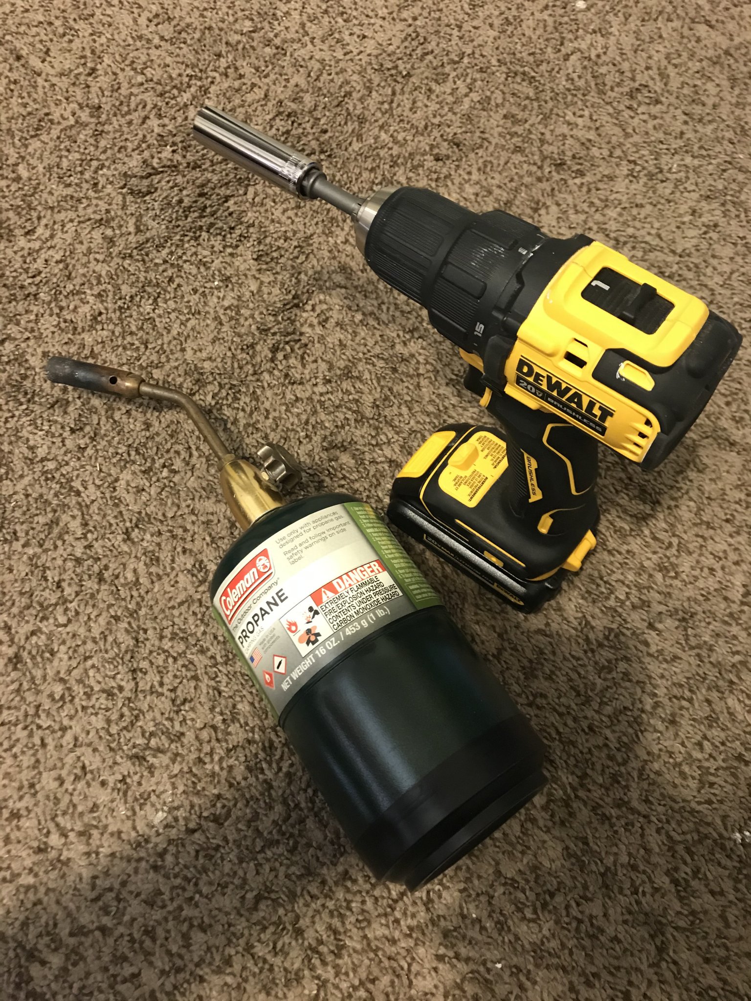

I would anneal after every firing, for a few reasons.
1. A regular Hornady full length sizing die will work the brass ALOT, which isn’t great for it and will lead to faster splitting of necks.
2. It will create more consistent neck tension, which in turn creates better accuracy and more importantly, more consistent velocities.
3. In theory it won’t matter if a piece of brass has 2 firings or 10 firings, they should all size, load, and shoot the same. (This means no more need to keep everything segregated by number of firings. Trust me, this gets super annoying after a while).
4. Your brass looks cool. Which will make you feel better about yourself, and when you feel better about yourself and your gear, you are more like shoot well. A large part of shooting is psychological.
5. Annealing doesn’t have to be expensive. I’ll attach a picture of my setup below.
Now you're talking my lingo! I will definitely look into this... 5 seconds of a low spin?
