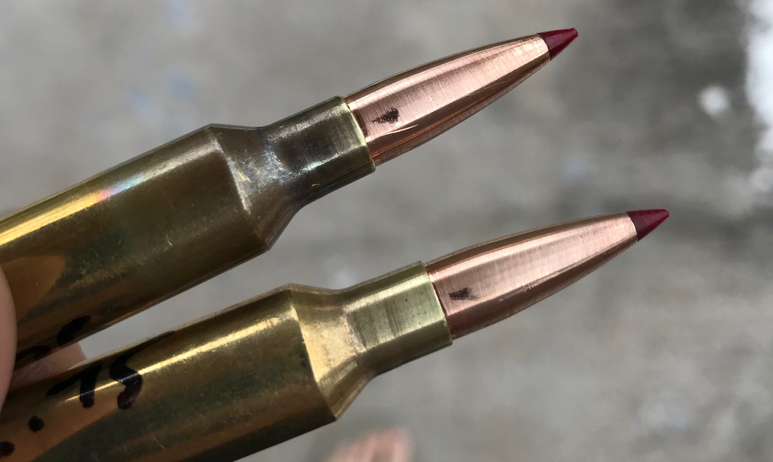

2.76" OAL on top, 2.75" on the bottom.
That does not look like a mark from engaging the lands .
I believe your initial measurements from closing the bolt on rounds measuring 2.85 and those just slightly causing resistance are more accurate in finding your lands

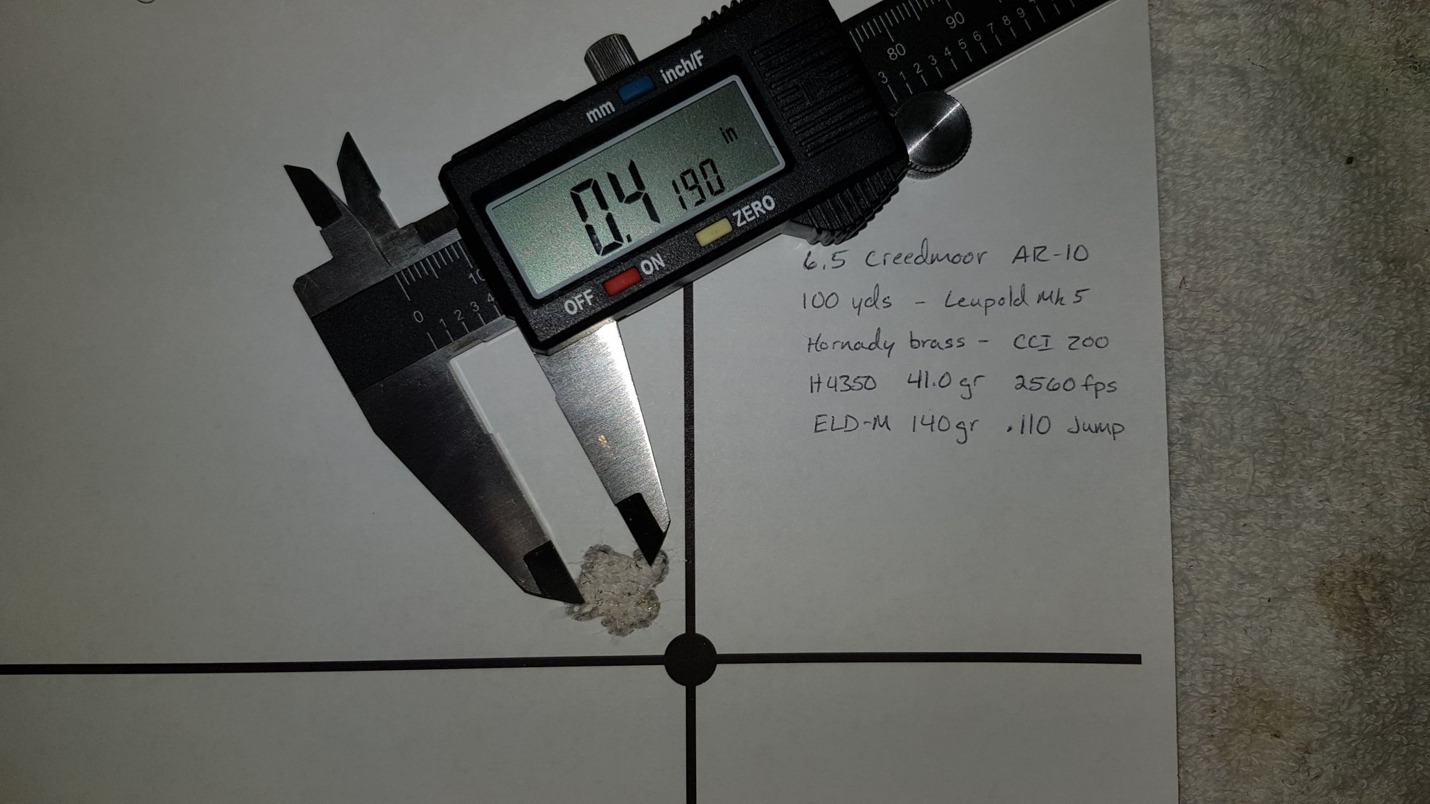

I'm seating my ELD-M 140gr in Hornady brass to .11 jump and getting <.5 MOA groups at 100 yds. May seem like a bit of a jump but I'm on a AR-10 platform so limited by mag length.
Reactions: LG65CM
