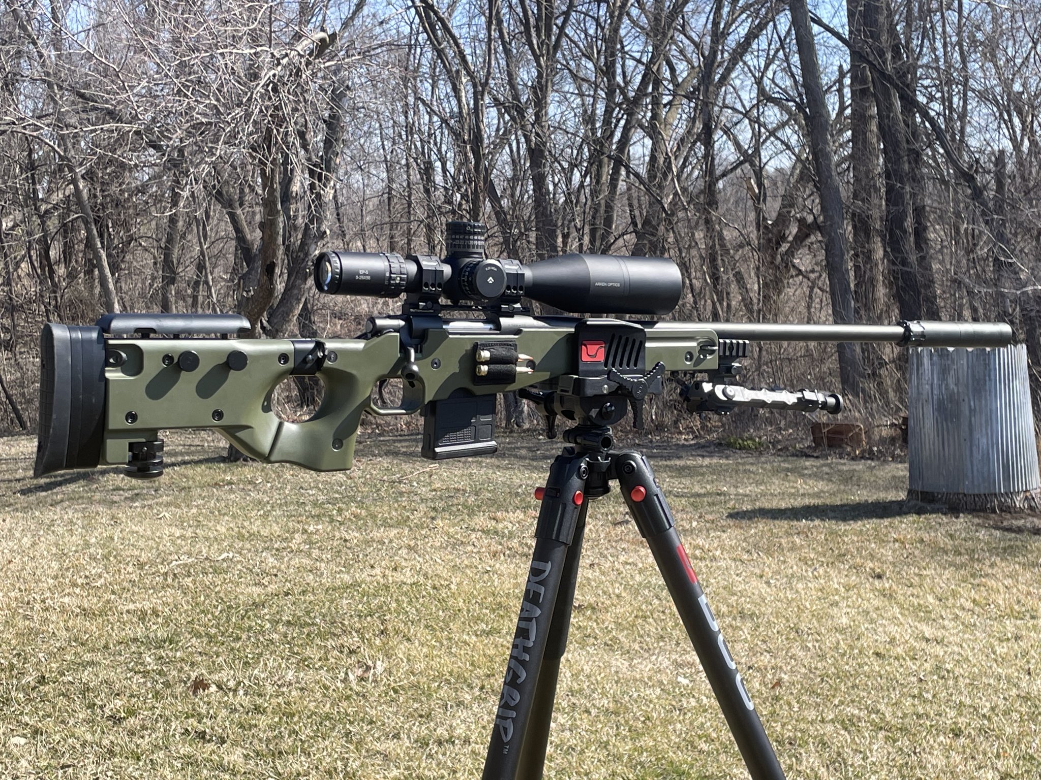

Looking to try some 6.5cm 95g vmax loads,
No Varget but have Accuracy 2520 powder. Brass is Hornady and S&B some new mostly once fired.
24” barrel thinking of starting at 40g 2520.
Anyone had experience with this powder and the 95g vmax?
Nosler shows there 90 with 39.5g of 2520 @ 3105 fps and most accurate
Any experience with the 95g vmax would awesome!
Thanks
