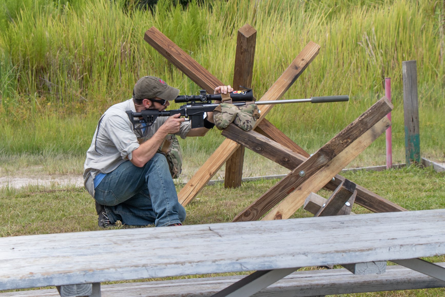

    26" barrel with can (SiCo Omega) on the end here. Yes it is long, but like others have said, there will maybe be 1 stage per match where it is a hindrance. I do see some guys running shorter barrels, but generally around the 22 to 24 inch range. I think going to 18" is pretty drastic. It may also move the balance point of the rifle too much to the rear depending on your stock/chassis.
