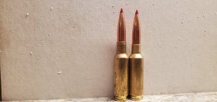

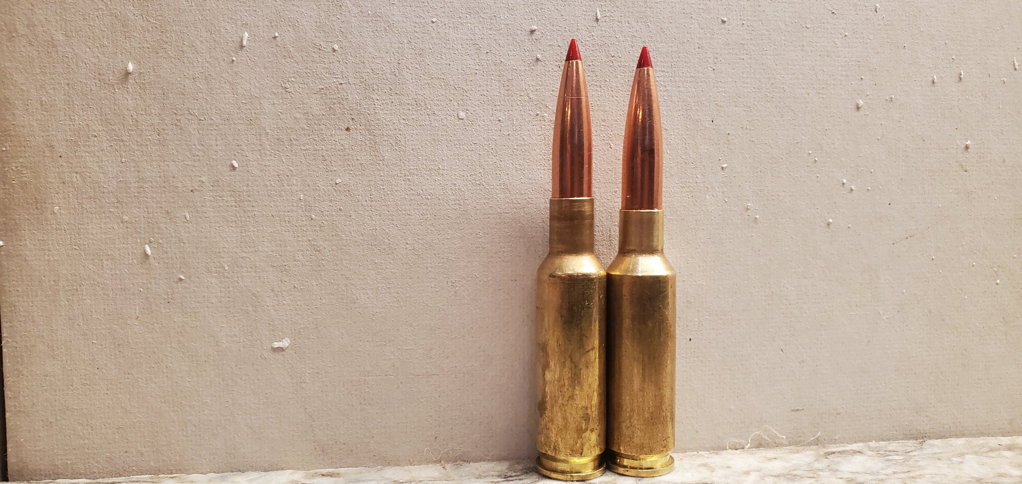

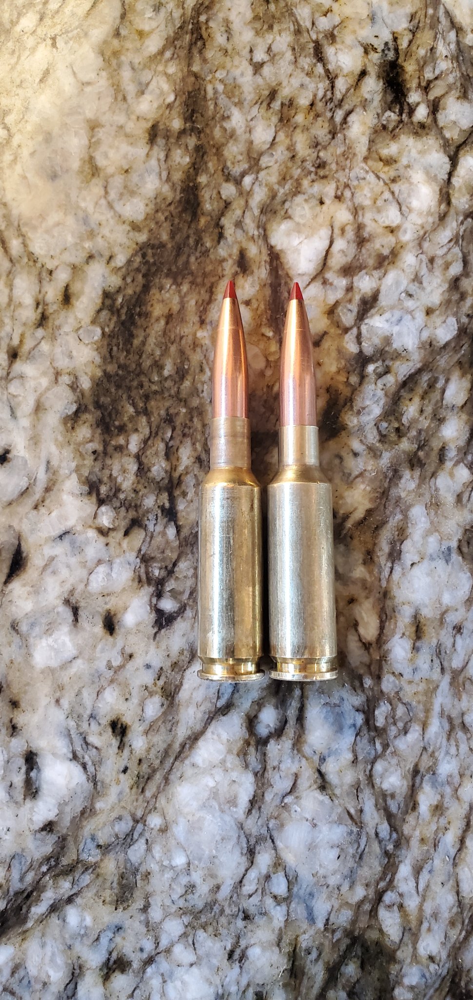

Here's a 6.5 creed case that I sized down in my GT die, the neck is lengthened so it could be throated for the 147 eldm (pictured) and also have plenty of neck for a 140 or 135 Atip.
Here it is next to a standard 6.5 GT, regular GT bushing dies would work since only the neck length changed.

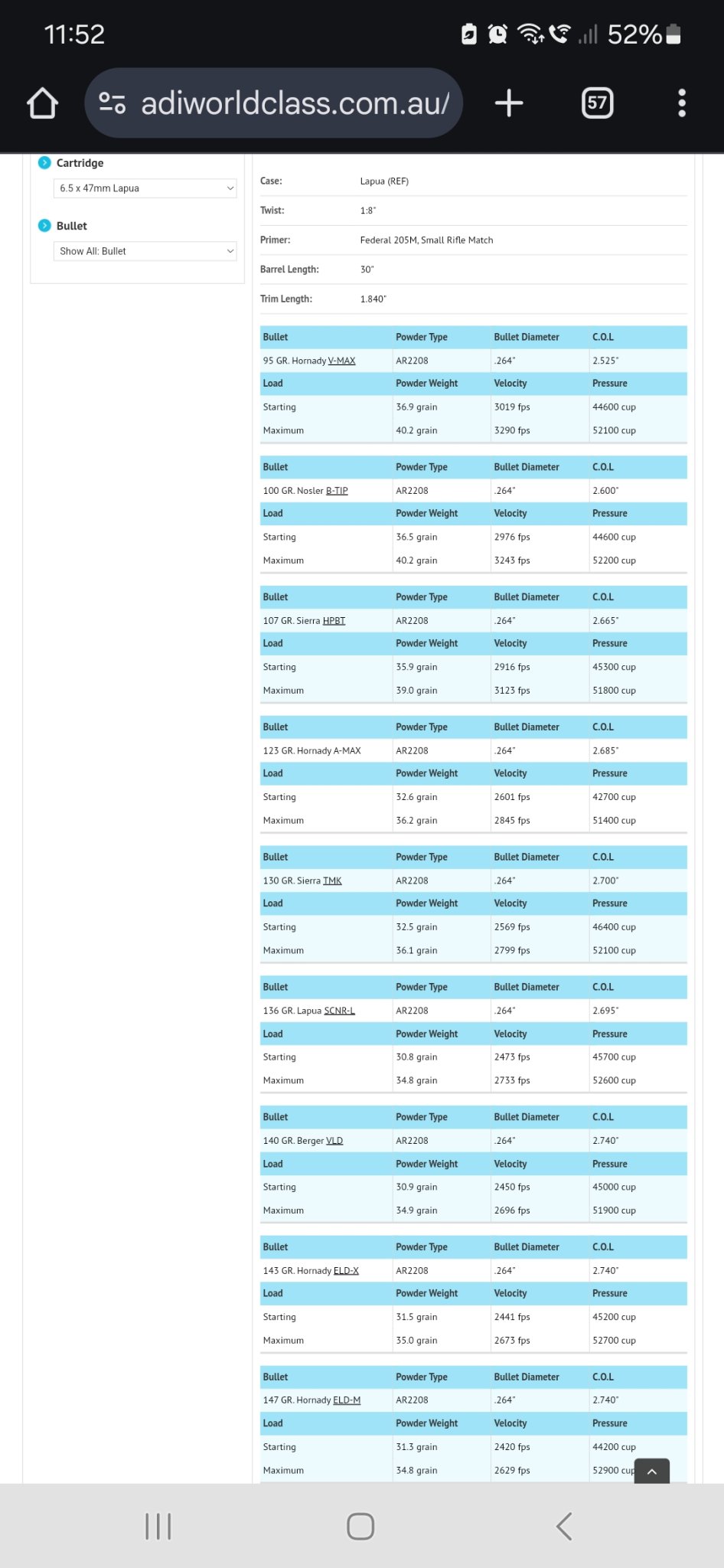

ADI who manufacture 2208/Varget list loads up to 147eldm. Most of their load data is with 24inch but this is 30inch so 26-28inch that a lot of guys compete with would give the 25XX fps velocities people are talking about.
