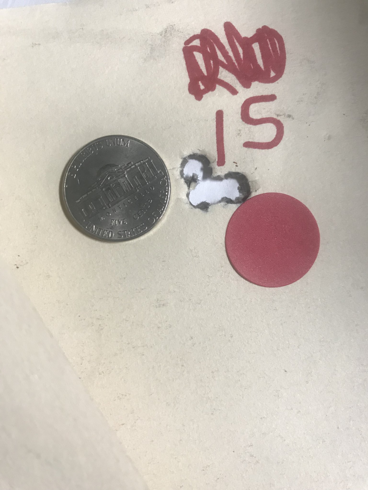

Here is the Sierra 6.5 150 at 100 yards. Doing load development. I’m running the 6.5 prc with .188 freebore. Barrel is a gain twist 5R Bartlein. 7.5-7 26 inches long. I thought they would be a little faster. But its looking good. That is a 3 shot group at 100. 15 thou off the lands. Average velocity is 2991 SD of 3.

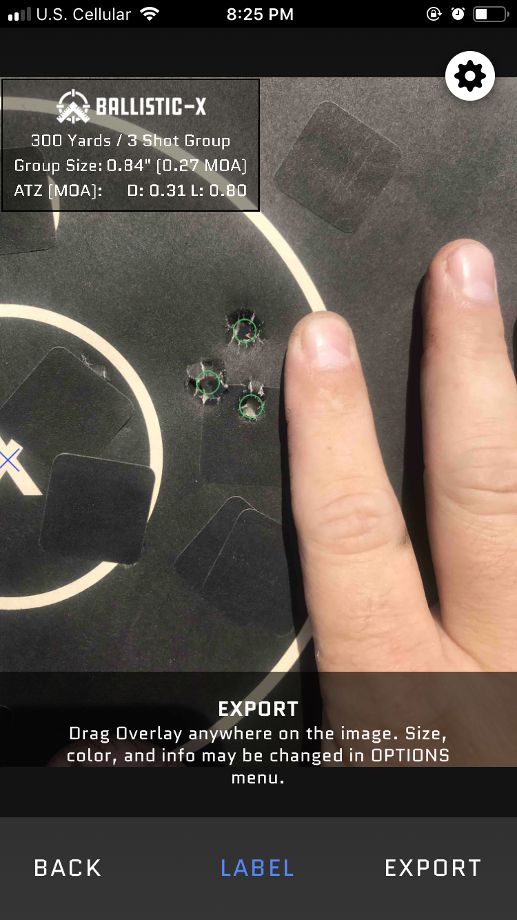

I got the kestrel dialed in. Was only able to get out to 600. I had a awesome group going but dropped the last shot low. Group is around 3ish inches. It shot great at 500. Then went to 300 and shot this 3 shot group. The kestrel was calling for .95 elevation. I put 1 on. .9 would be a little better. But its still in there. It called for .2 wind. I held straight up. And .2 would have been the right call. I’m really liking the Sierra 150s!!
