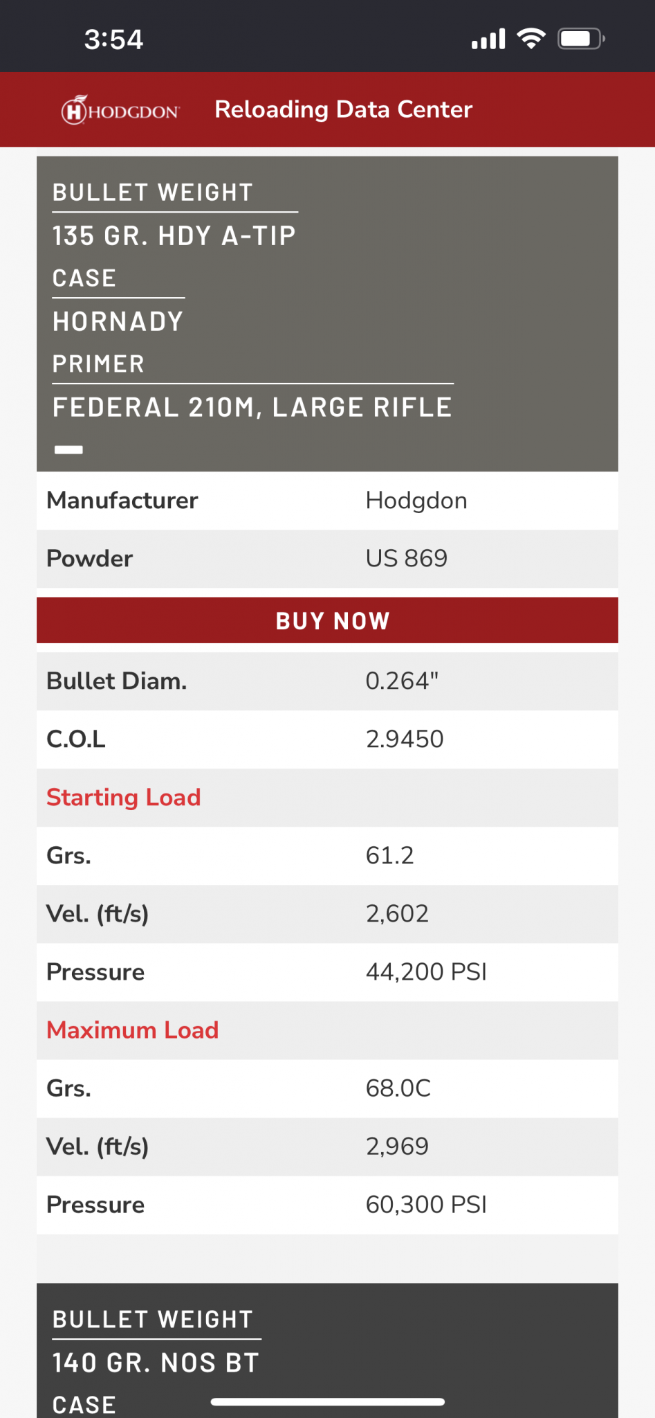

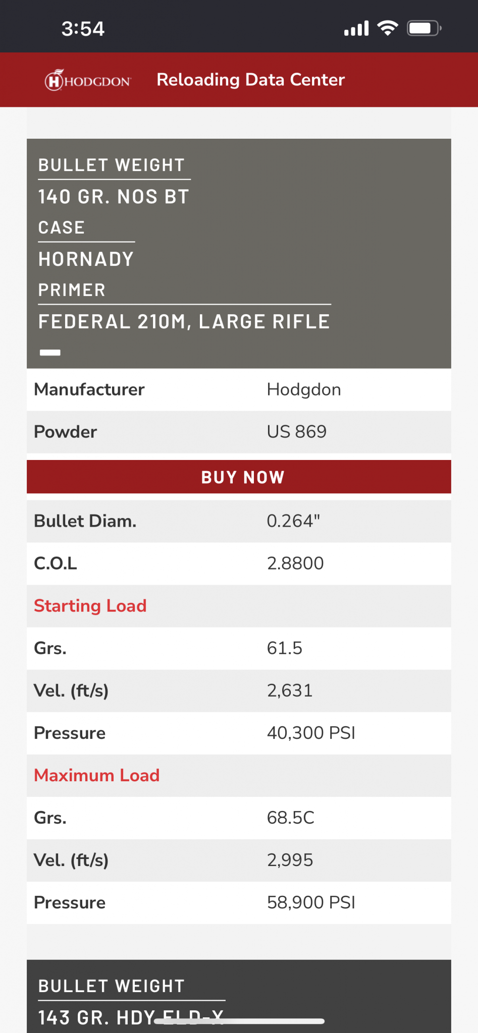

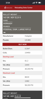

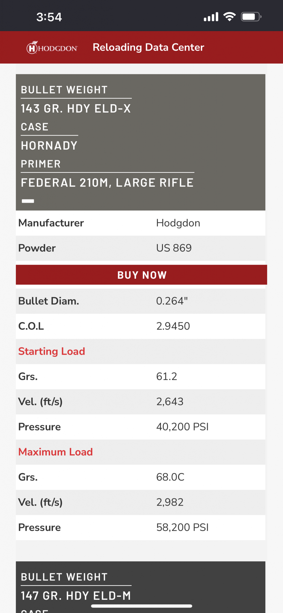

Just getting started with reloading. Purchased a Savage 10GRS in 6.5 PRC. Impossible to find powder such as H1000,RL26, Retumbo, or others on loading charts. This is what I have to start with so any information on load’s appreciated
Hodgdon load data website. There’s more but examples
