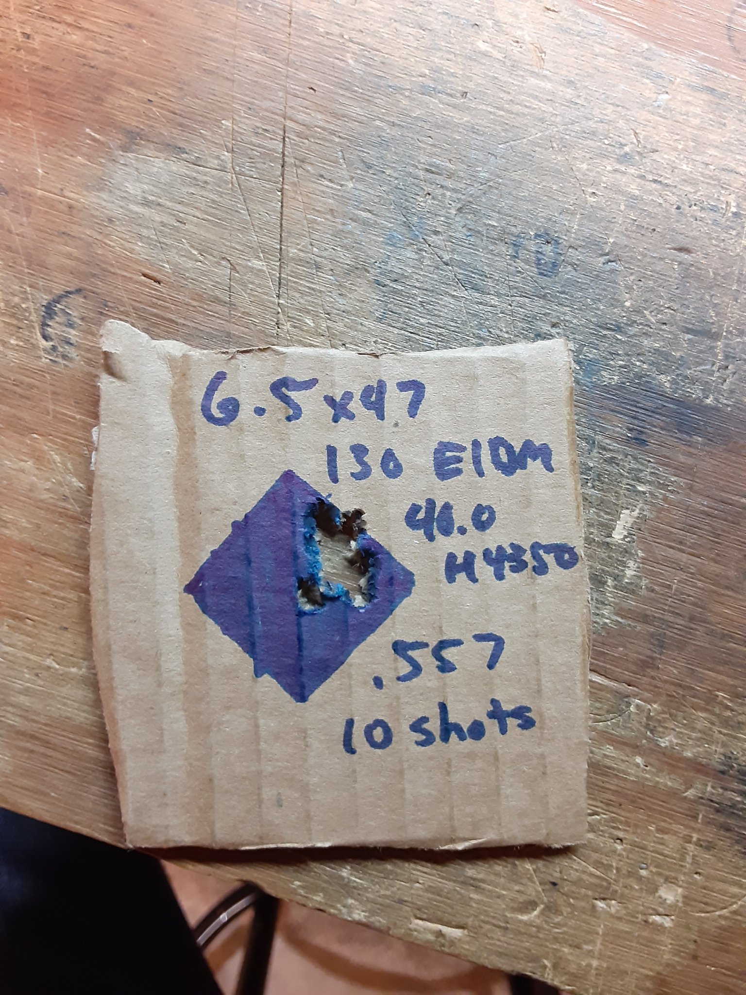

I have a bunch of these bullets and determined to get them to shoot in a 6.5X47 hunting rig, but so far it’s been tough sledding. It’s been most accurate around 40ish H4350 (~.60”), but I am used to this thing shooting bug holes with Berger’s. Anyone have luck with these and a recipe?
Ten shots out of #4 contour Mullerworks. I am not chasing any more accuracy out of a hunting rifle. Shoots very good at 500 also.

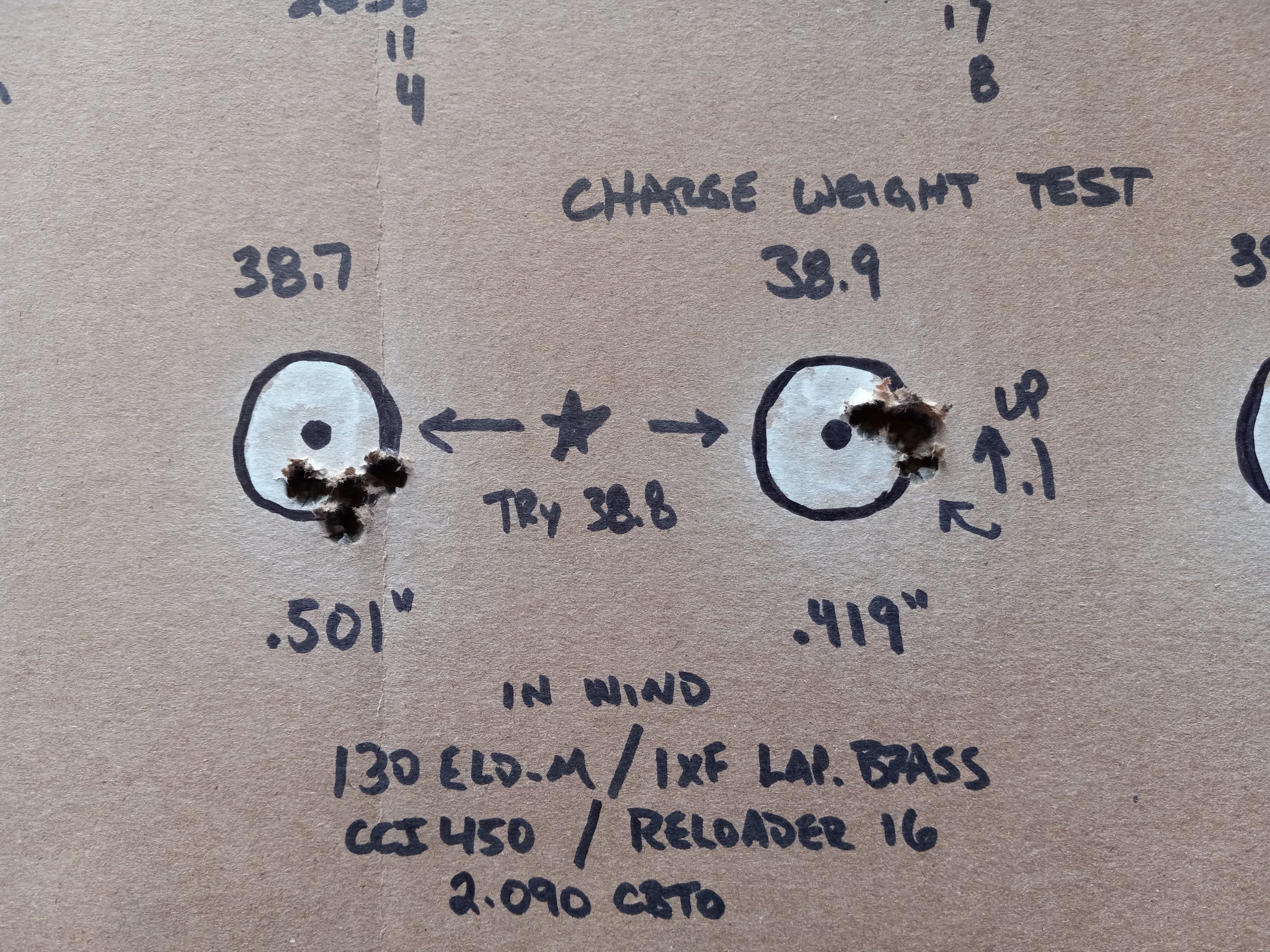

I don't remember what the jump is, but I think it is in the .025" range IIRC. I ended up with 38.8gr Reloader 16 and I think I tweaked the seating depth about .005 from this example above. The result was a decent window of performance that remained in the .4s for five shots, and maintained that as I increased distance.

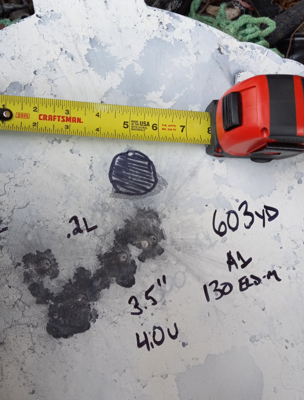

The downside to this load is that it is slow, and that is exacerbated by my slower Brux (my Krieger is always 30 FPS faster with the same load. My velocity out of a 26" barrel is 2,715. I'd care more if it didn't shoot so consistently. It is a half-minute shooter out to as far as I've taken it.
This load straight up hammers coyotes out to the limits that I've tested it (250 - 260 multiple times). It also does well on larger critters...so much so that I've started believing in match bullets for hunting again after having had several poor results with various OTMs.
