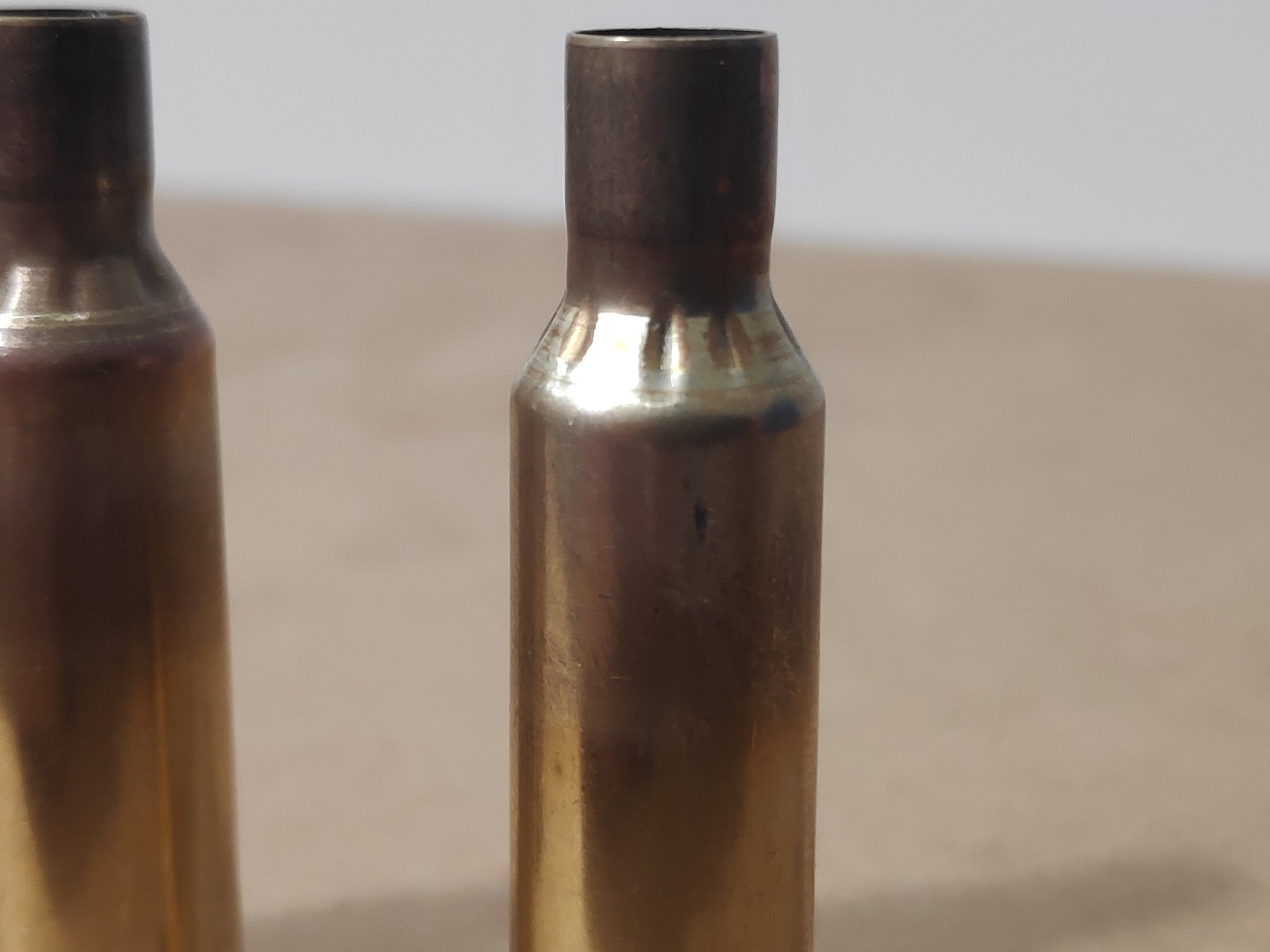

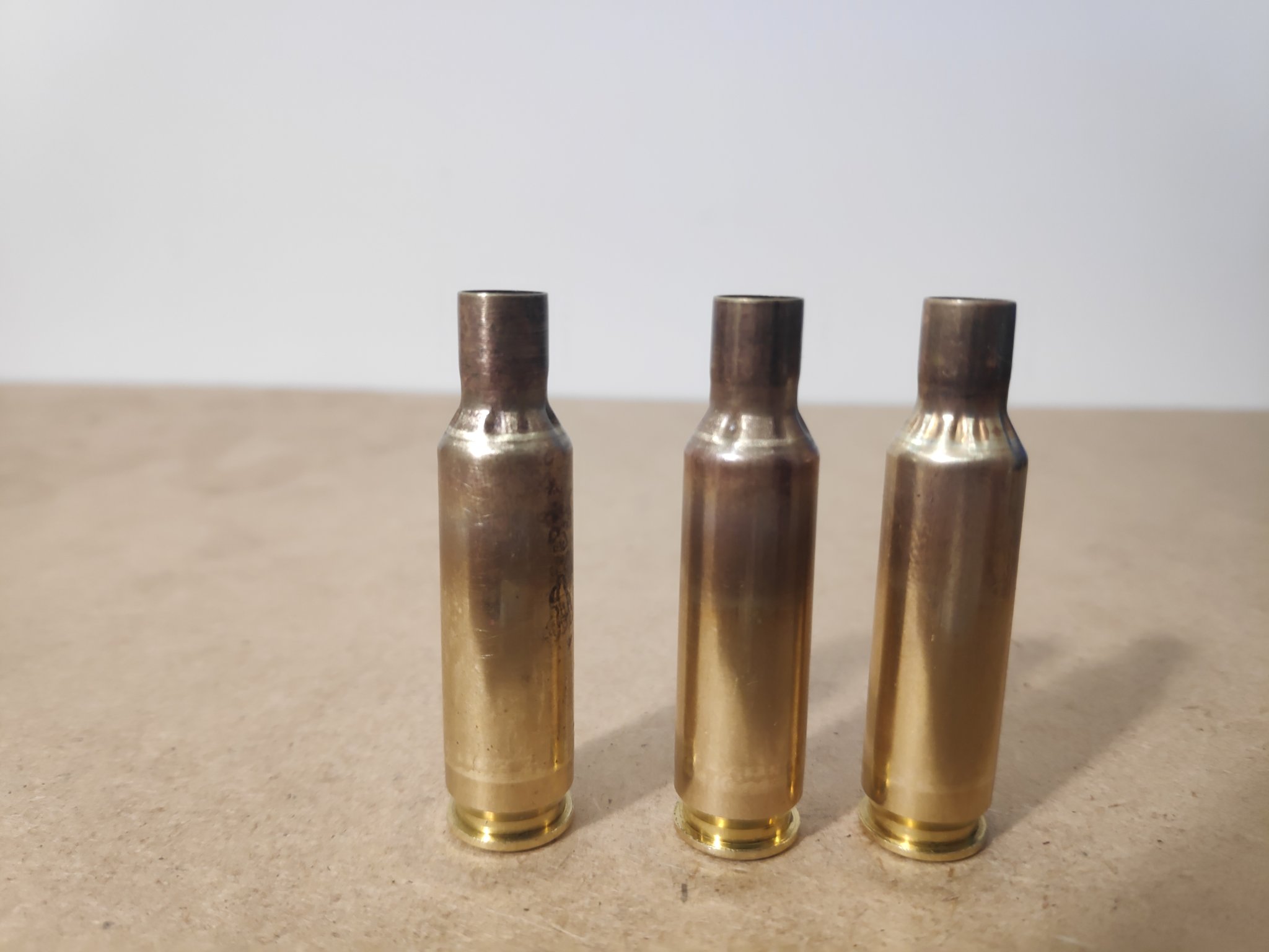

Hello, today I made some test with Hornady 6,5 Creedmoor brass.
I have annealed the brass before forming with 6,5x47 Lapua Redding Body Die.
Started slowly and rotated the case 1/3 every little movement.
But on the shoulder of the case whe ave some wrinkles.
Can someone tell me why?
Thanks, Camillo
