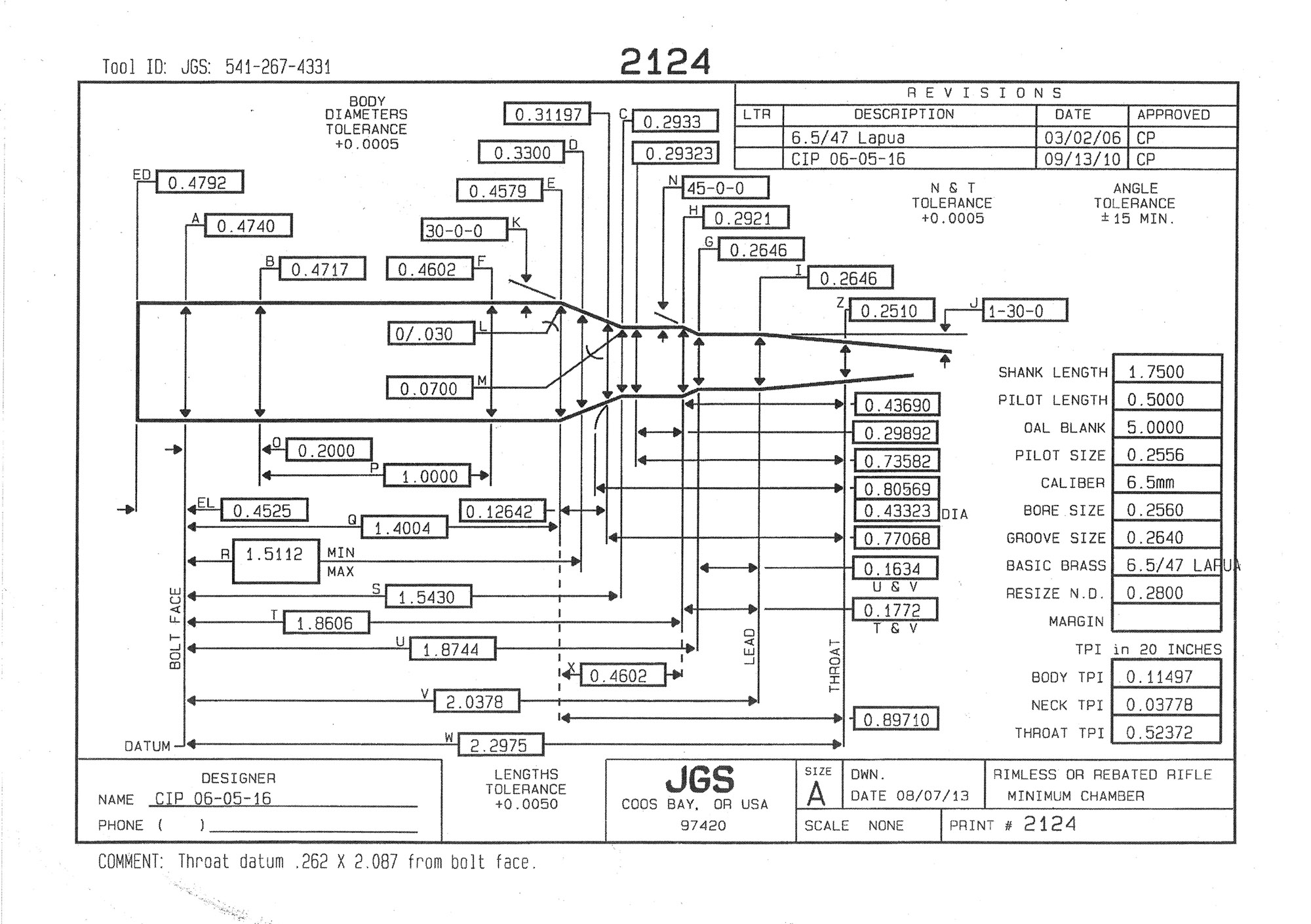

It’s funny, I was just searching them and you’re right, they’re tight mostly. Grizzly industrial(which stocks ptg) has their version on sale for 149. It’s a .2944 neck, .167 freebore. From memory the rest of the body dimensions look standard.
It’s good you’re sticking with it, as it’s a real peach of a cartridge. Why not just buy your own reamer, then never worry again? JGS or Manson will send you everything they have on it if you ask. If you have more questions, post the ones you think are right to this thread and let the peanut gallery give you the yay or nay.
Some of these reamers have a .293ish dimension at the neck/shoulder junction, tapered down to a .292 at the mouth. Which is a .292 neck, not a .293ish neck.

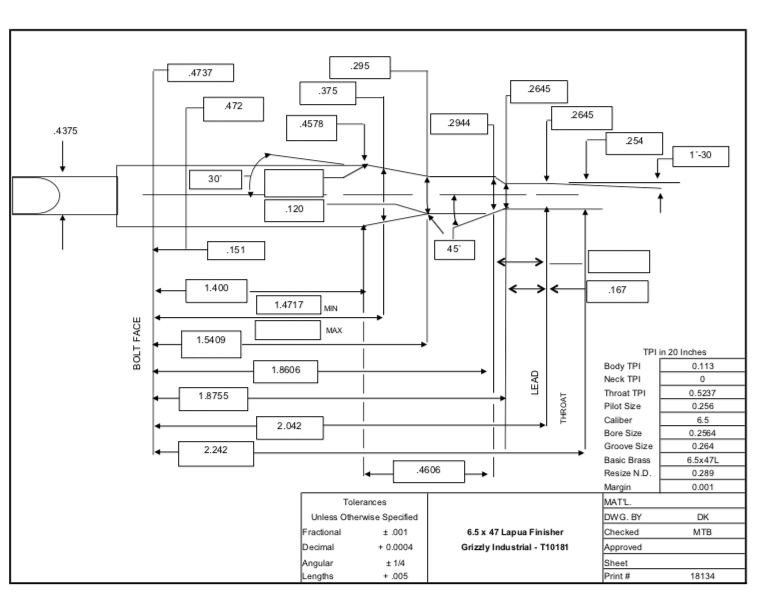

I looked at my print. PTG print number 18124. It’s dated 6/09. Body dimensions are identical to the grizzly PTG reamer I mentioned above, but my neck is .295 vs their .2944. Their’s also has .167 freebore vs my .123, so it would be better suited for 140 gr bullets.
  • t10181_as.pdf

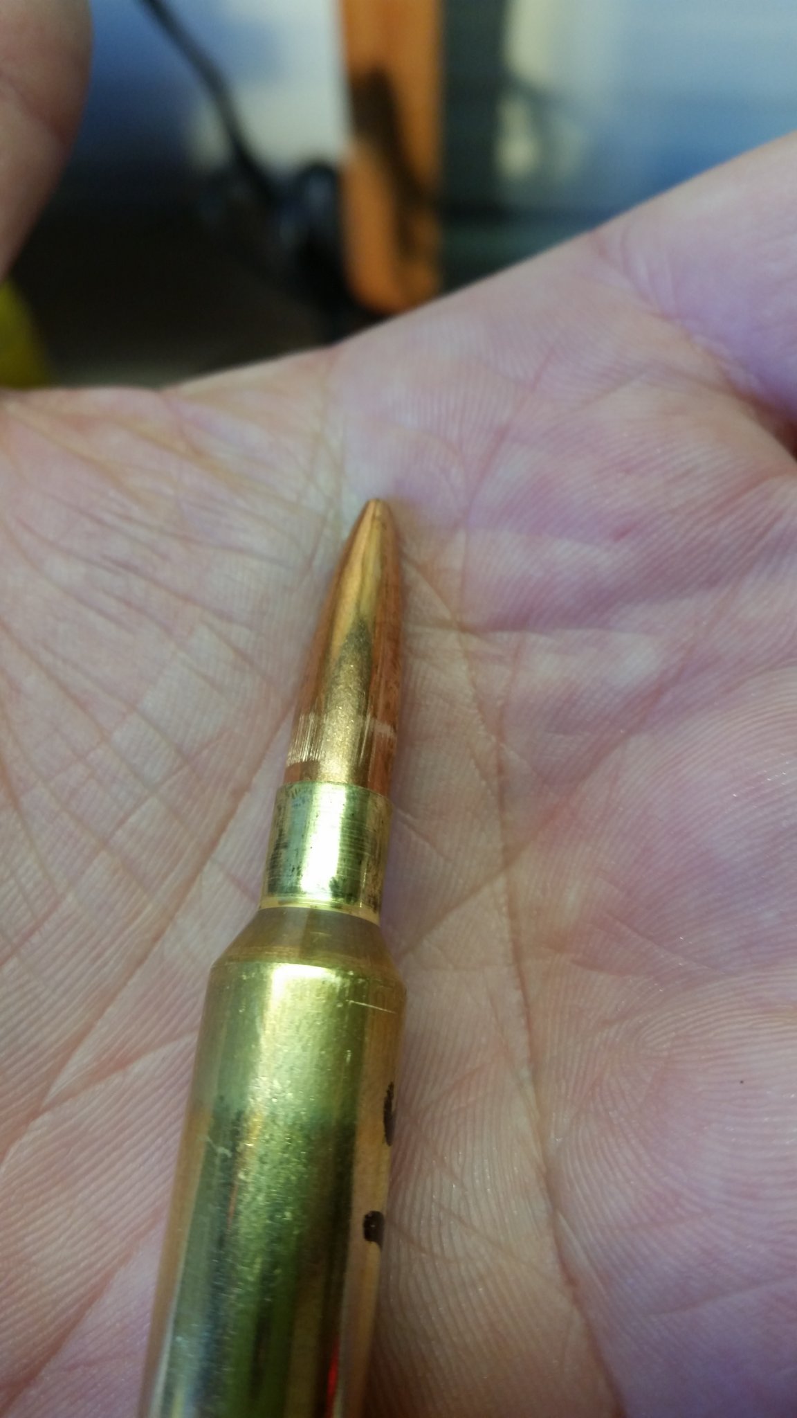

Here is a pic of the gouge from the carbon ring in the last barrel:
Is that completely around the bullet?
If your freebore is tight, you CAN get those from a bullet out of concentricity...though that's quite a bit.
