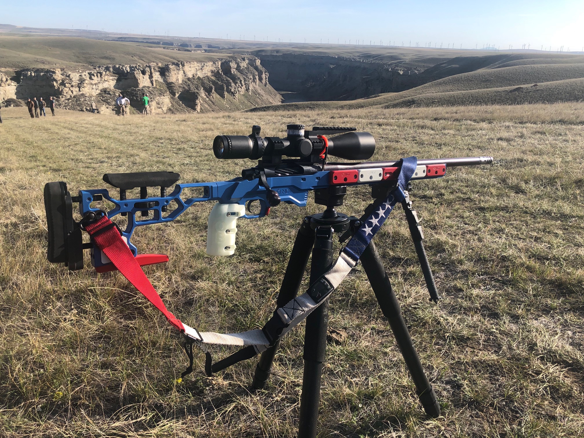

Just had a 6.5x47 barreled this year for some team matches - more LR shots and wanted a heavier bullet to see misses better. Really surprised at the ease of accuracy in this cartridge. Literally put my friends load in and under 1/2".
In 3 team matches we have a 4th, 6th and 2nd.

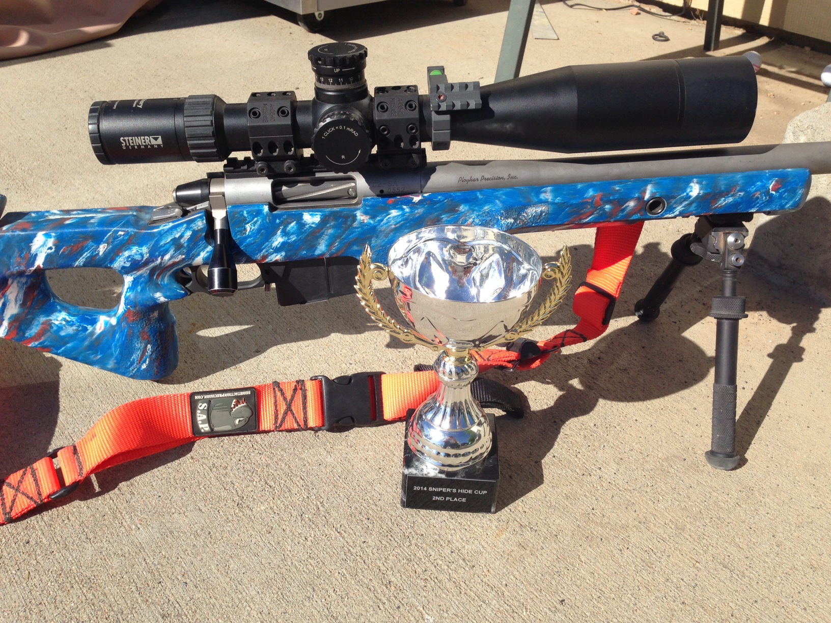

Ive shot the 6x47 for 5 years and during that time have several top finishes including a 2nd place at snipers hide cup. My transgression after the 6x47 was to 6.5GWI, then 6BRX, and now 6BR/6.5X47.
