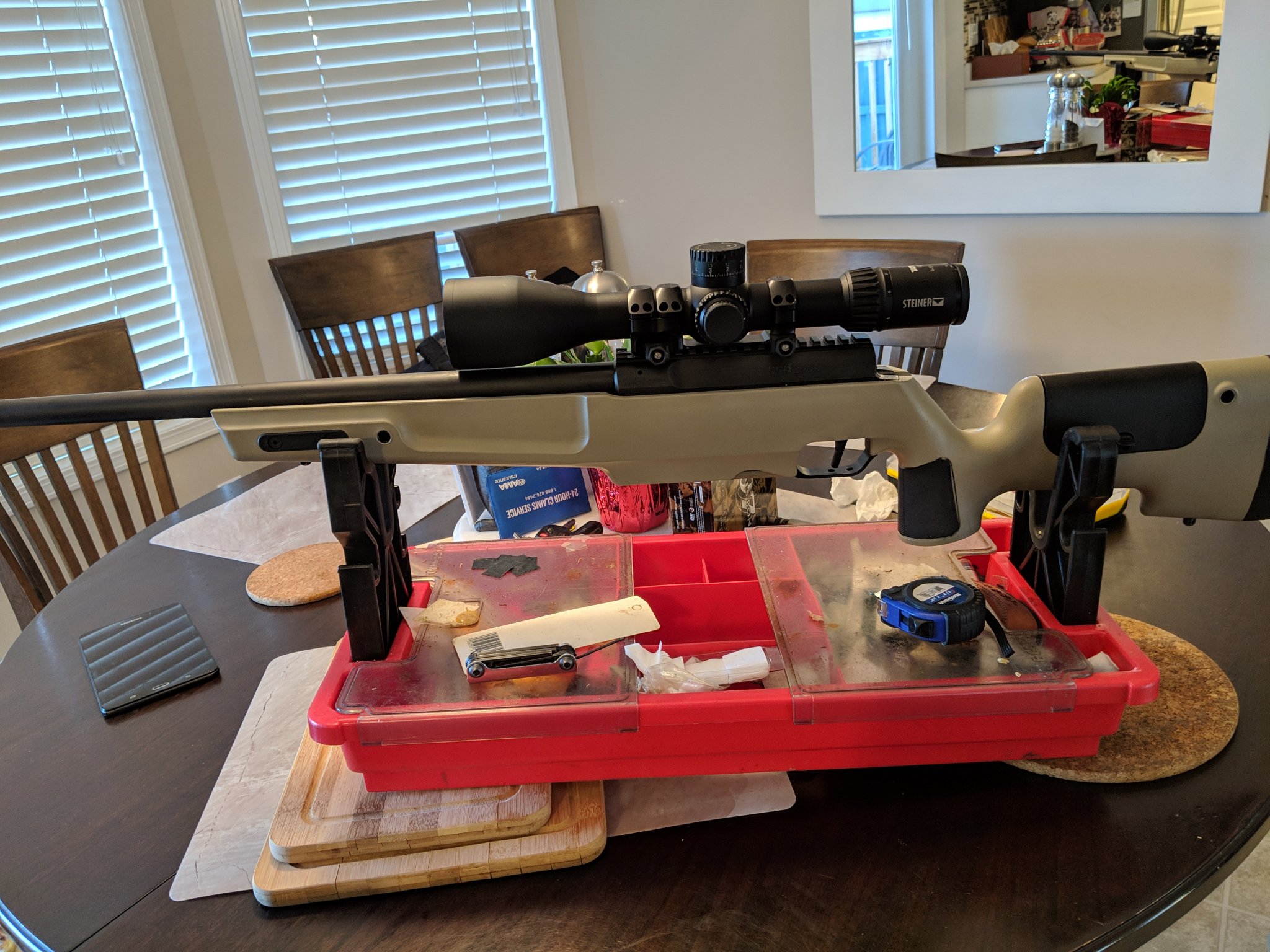

I got a US version of the sig sauer SSG 3000, and had a 27” benchmark barrel made for it in 6.5x55. It shoots one bughole groups with RL26 and 147 ELDM. I believe that benchmark uses PTG match chamber reamer with the standard SAMMI throat, not the long European throat. I cannot sit the bullet out as long as in Tikka 6.5x55 rifles, but I easily got 2850-2900 FPS without any pressure sign. It was very easy to develop a load for the benchmark barrel. Changing barrel with SSG 3000 is super easy (3 screws). Head spacing is not required because bolt locks into the barrel extension set at factory.
If someone got this rifle and want to try 6.5x55 with it, it’s easy and economical because no smithing work is needed. 6.5x55 is what this rifle was designed around.

I have a sauer str 6.5x55 skan match barrel coming for my ssg3000 this week, and a benchmark 6.5x55 for it later this month. I can't wait to see how it does.
Had a meopta zd 4-16 on it until I started reading the reviews about the Steiner P4Xi 4-16, so now have that on top of the SSG in a Near Alphamount.
