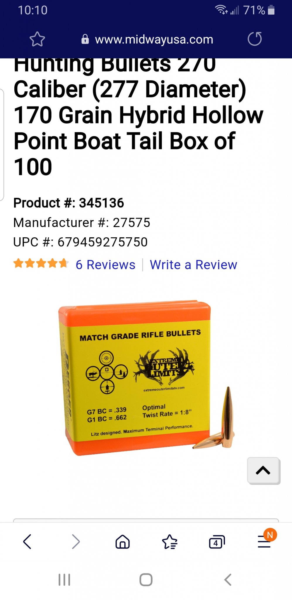

Curious what .277 projectile has a modern high bc profile.
Per this article:
The first factory loads are
165gr ABLR
170gr Accubond (I've read Ballistic Tip elsewhere)
162gr Copper monolithic
170gr OTM
175gr Sierra TGK
The 165gr ABLR came out with the fast twist 27 Nosler, but I think the170gr AB/BT, 162gr and 175gr TGK are just being introduced.
It's obviously a hunting cartridge, and If you like tipped or bonded bullets, it has ~30gr of bullet weight on any modern tipped or bonded 6.5 PRC bullets I know of.
