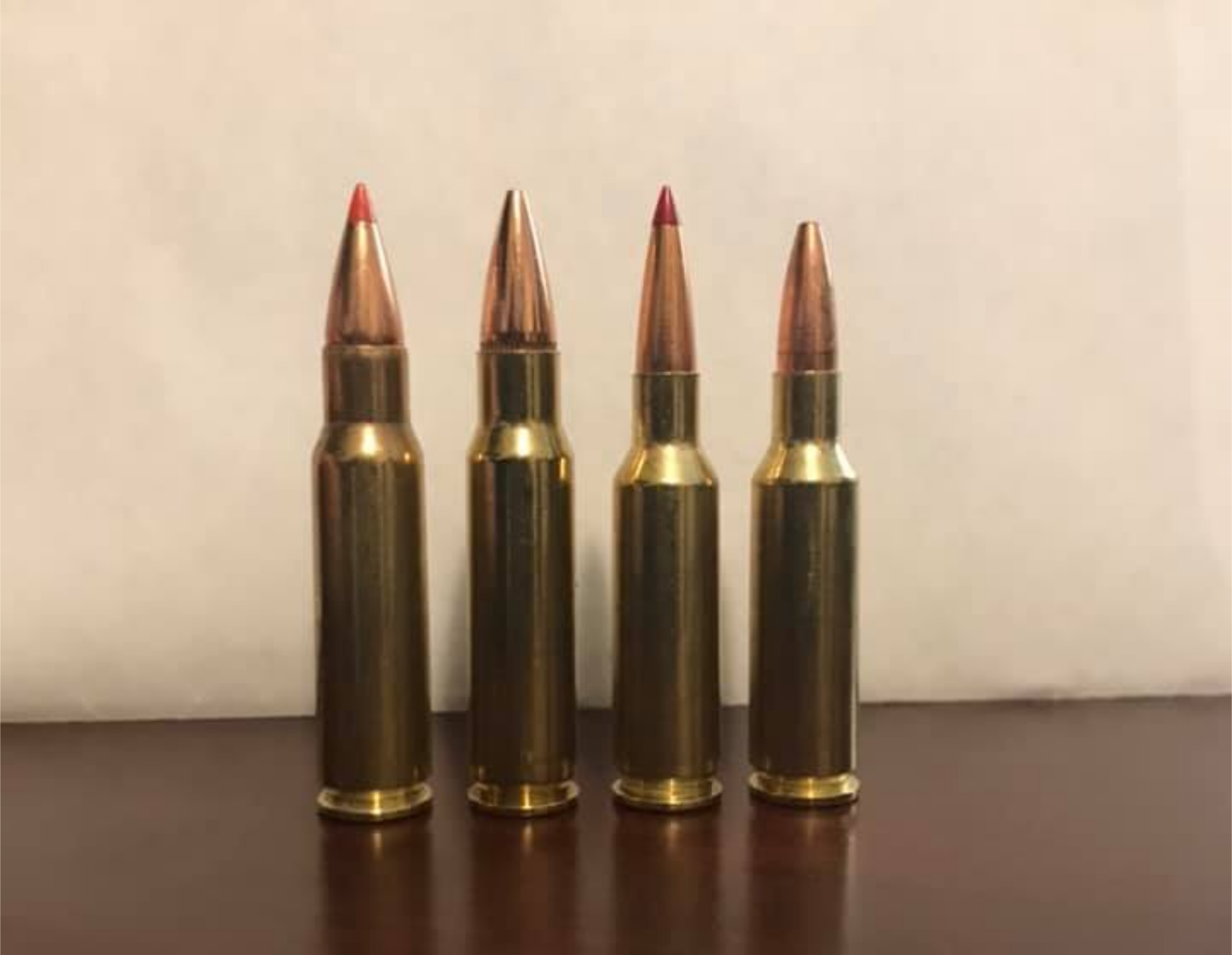

Are you able to get a hold of the 6.8mm Speer Gold Dots? Those seem like the perfect short barreled SPC bullet.
They’re great projectiles.
Second best is 85 TSX or 95 TTSX.
Haven’t tried the Accubonds. Typically staying under 100gr offers best performance envelope, especially in shorter barrels.

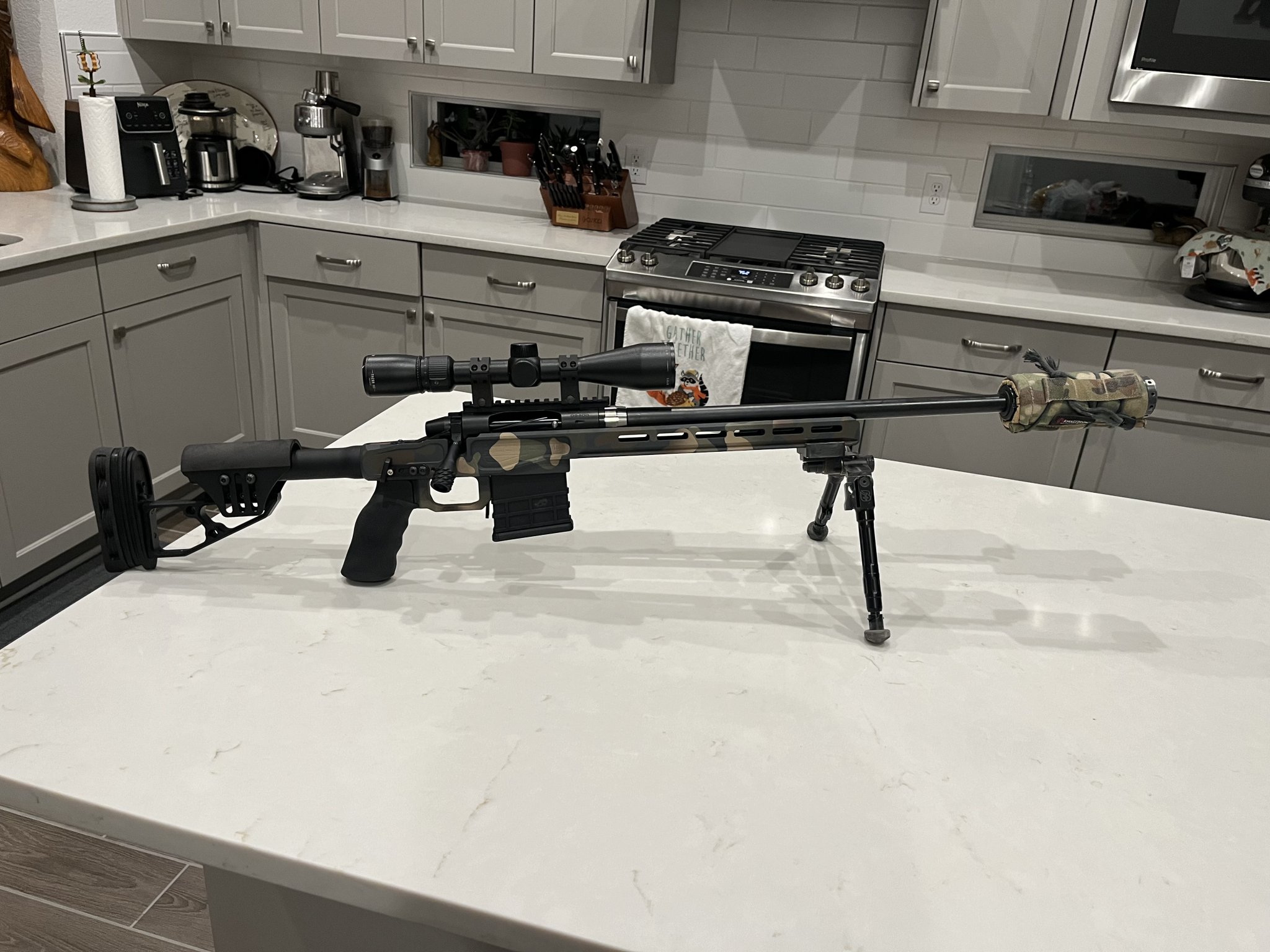

All the parts arrived for the build and tossed them together for photos. Still need to headspace the barrel and play musical triggers to free one up for this rifle
Origin, ARP 18” barrel, XLR Element, KGM R30k, Vortex 2-10 razor LH and will have a folder and TT special 2 stage.
Probably won’t have time to shoot it for a few weeks but will try to report back when I do.
So I’m using the mdt poly Valkyrie magazine and just cycling the ammo through the gun once the mag is roughly 1/2 empty the bullets tilt nose down and stop feeding.tube not enough spring tension? Or second thought is the ribs on the inside of mag are dragging on the front of the case???
Is the Valkyrie shorter or thinner in the front than the 6.8? I have never seen a valkyrie case up close.
