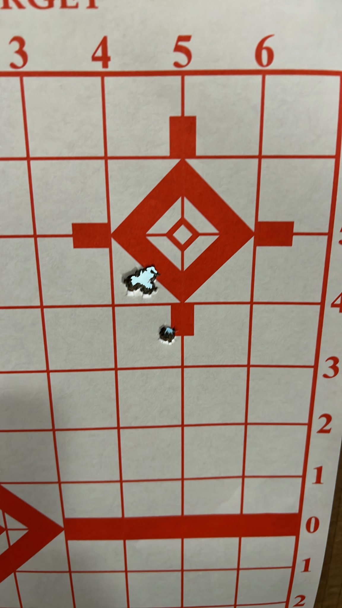

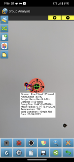

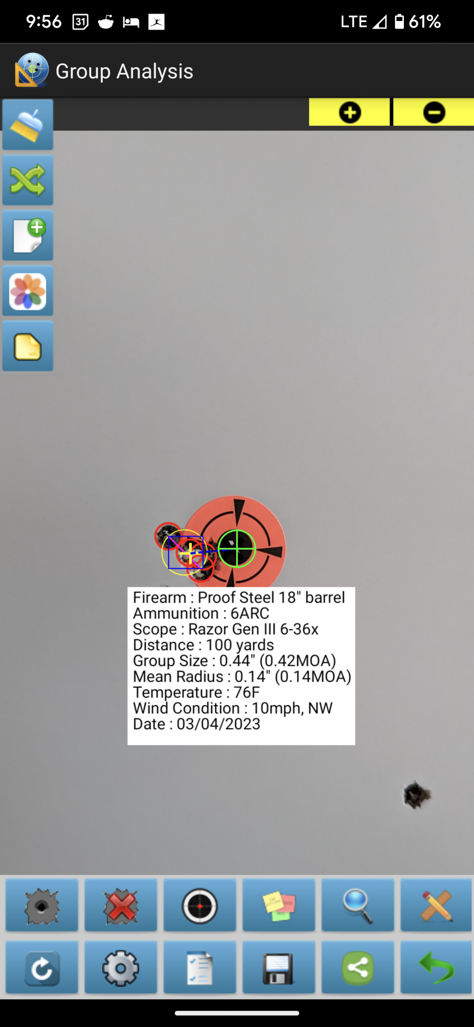

Highly recommend proof. Here’s a 18” stainless group. 21-25 rounds fired through barrel. 5 shot group at 100 yards to test zero before going to 1k.

What ammo was that with? A buddy of mine is having a hell of a time getting his proof to shoot factory 105's.
The Hornady 105 bthp ammo is very good as well, if your buddy is trying to use 105 Berger VLD’s I can see why he’s having issues. Those need touching or in some cases jam against the lands to work well and the SAAMI chamber for 6mm ARC doesn’t have a short enough freebore to allow this, plus touching or jamming a bullet in a gas-gun isn’t a great idea.

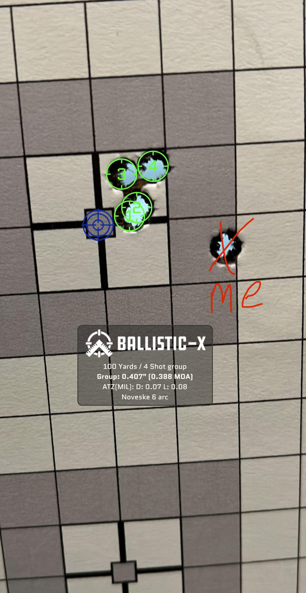

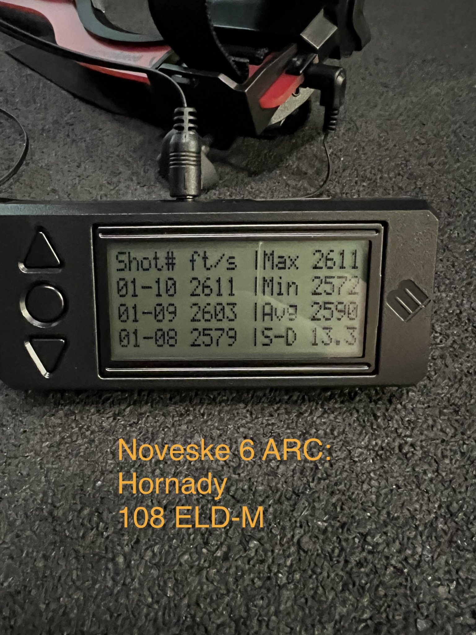

Update, shot the Noveske 6 arc again today after a cleanup with boretech carbon remover followed up by boretech copper remover. Shot a couple groups at 100 with FACTORY 105’s and 108’s just to make sure the Z hadn’t shifted. same size for both .6-.7 range although the 105’s were 1mil low and .5 mil left of the zero for the 108’s wheird. Got too excited and left the paper up at 100 so no pics.👎 took it to a UKD range and walked it out to 940 yards. In the process the barrel sped up 24 fps it now has 220 rounds through it MV now 2614 (and I harvested all the brass!). It was 45 degrees with wind from 2:00 at 8 gusting to 22. Pleased with this barrel. Next time I’ll get some target pics! Gonna shoot a match with some factory ammunition and start a load development with lever and Berger 108 bt’s.

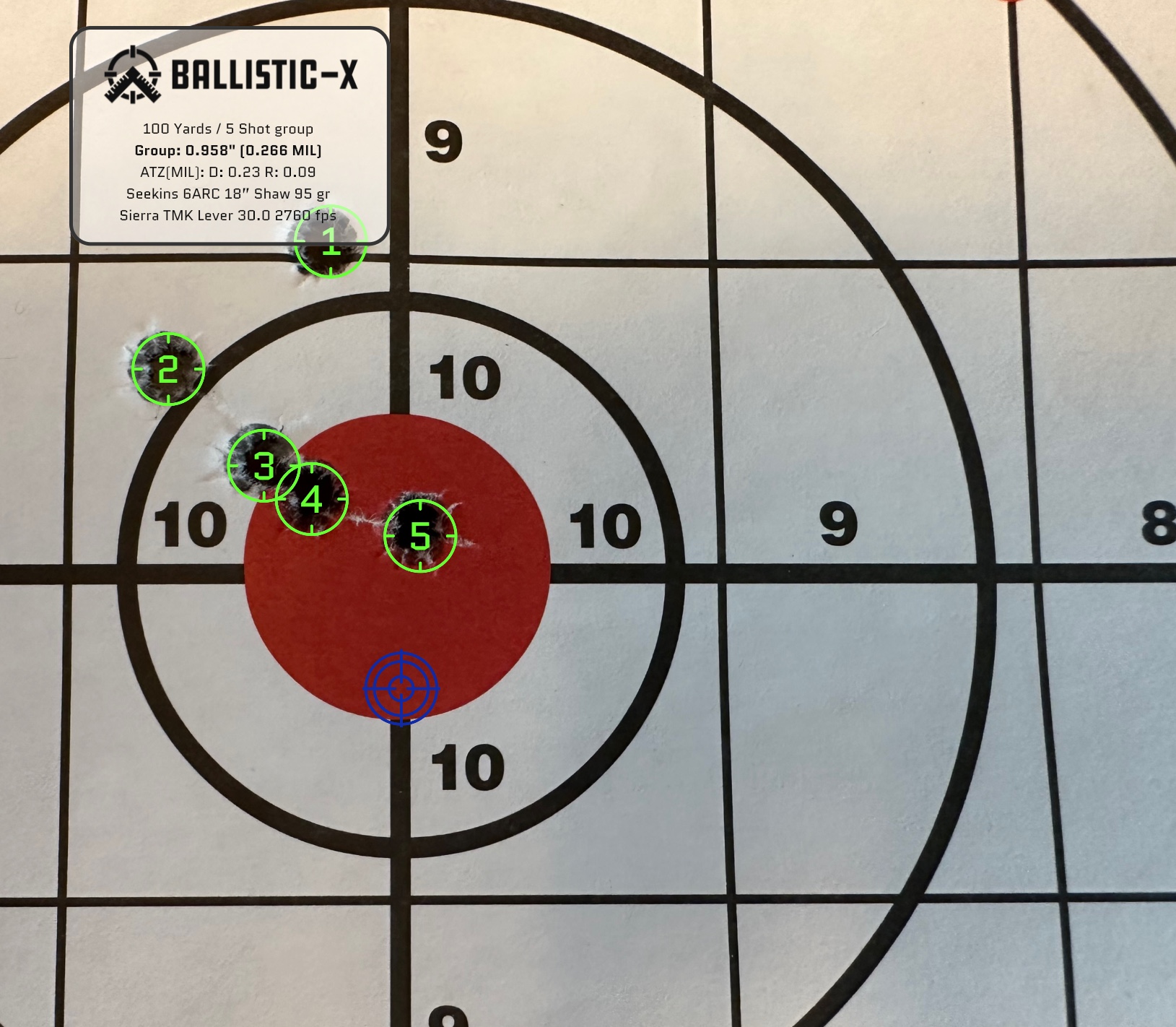

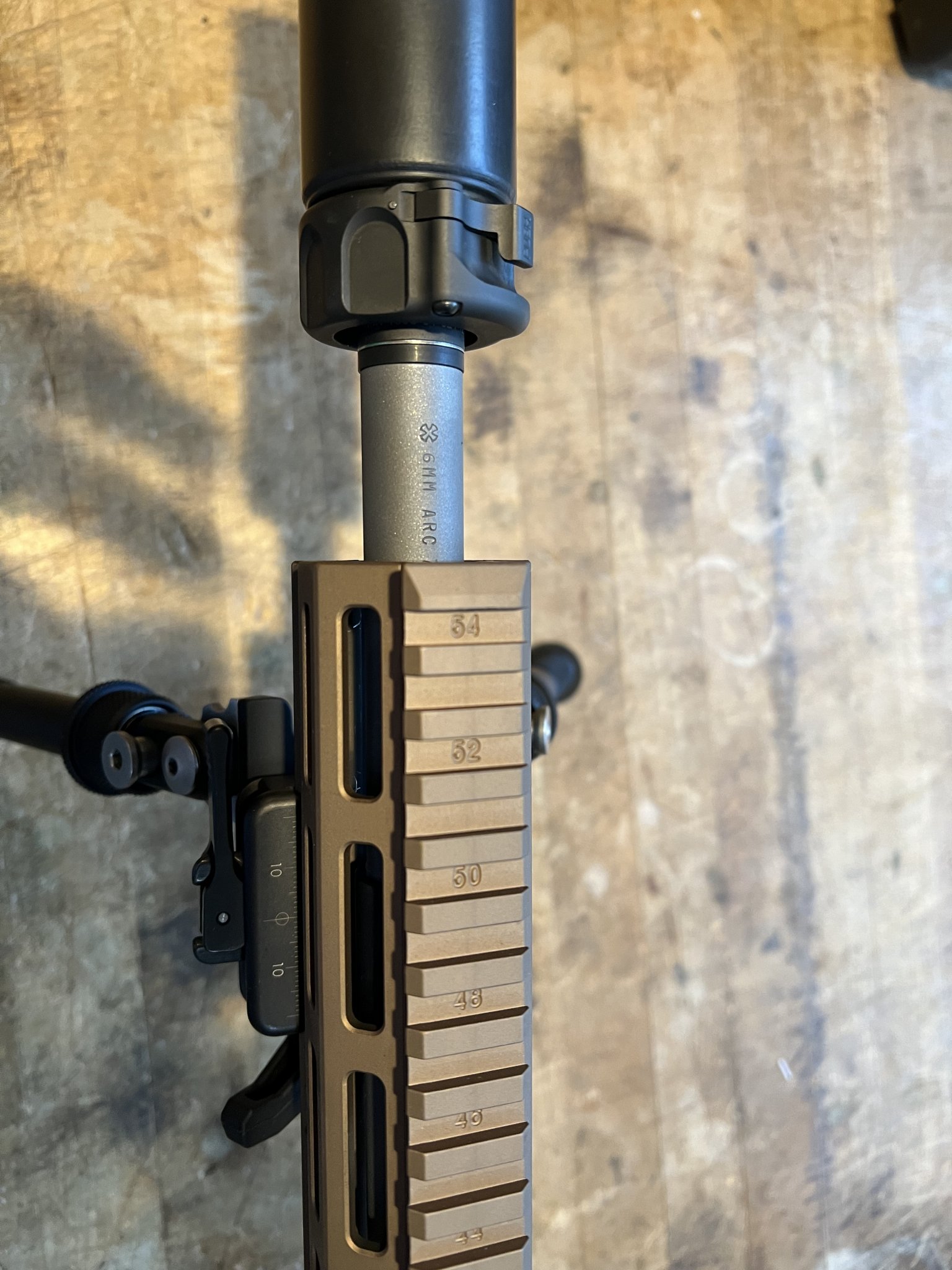

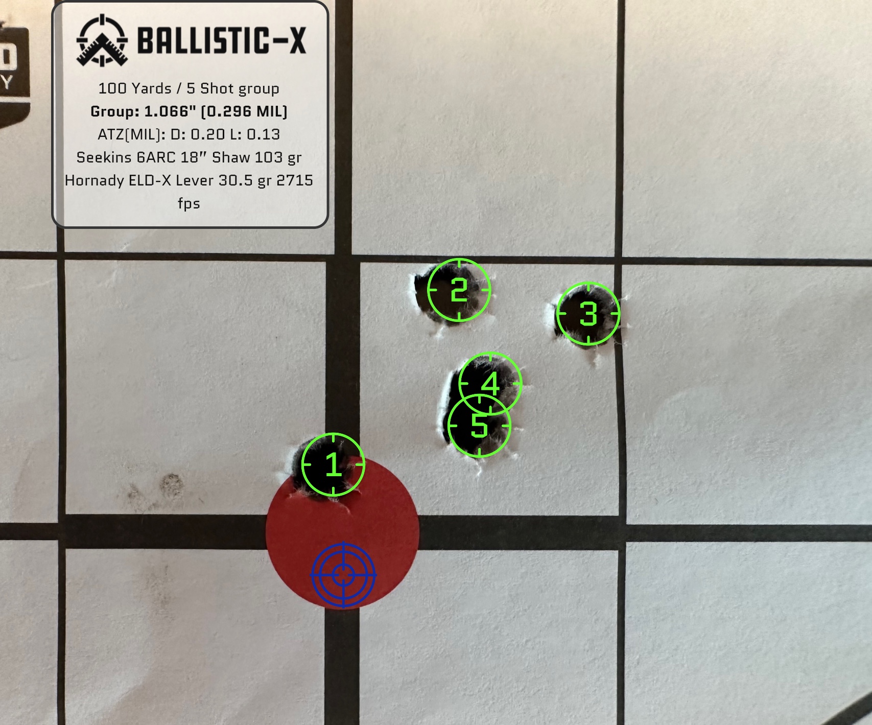

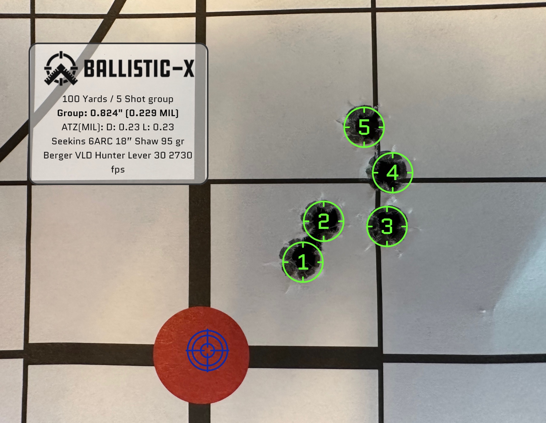

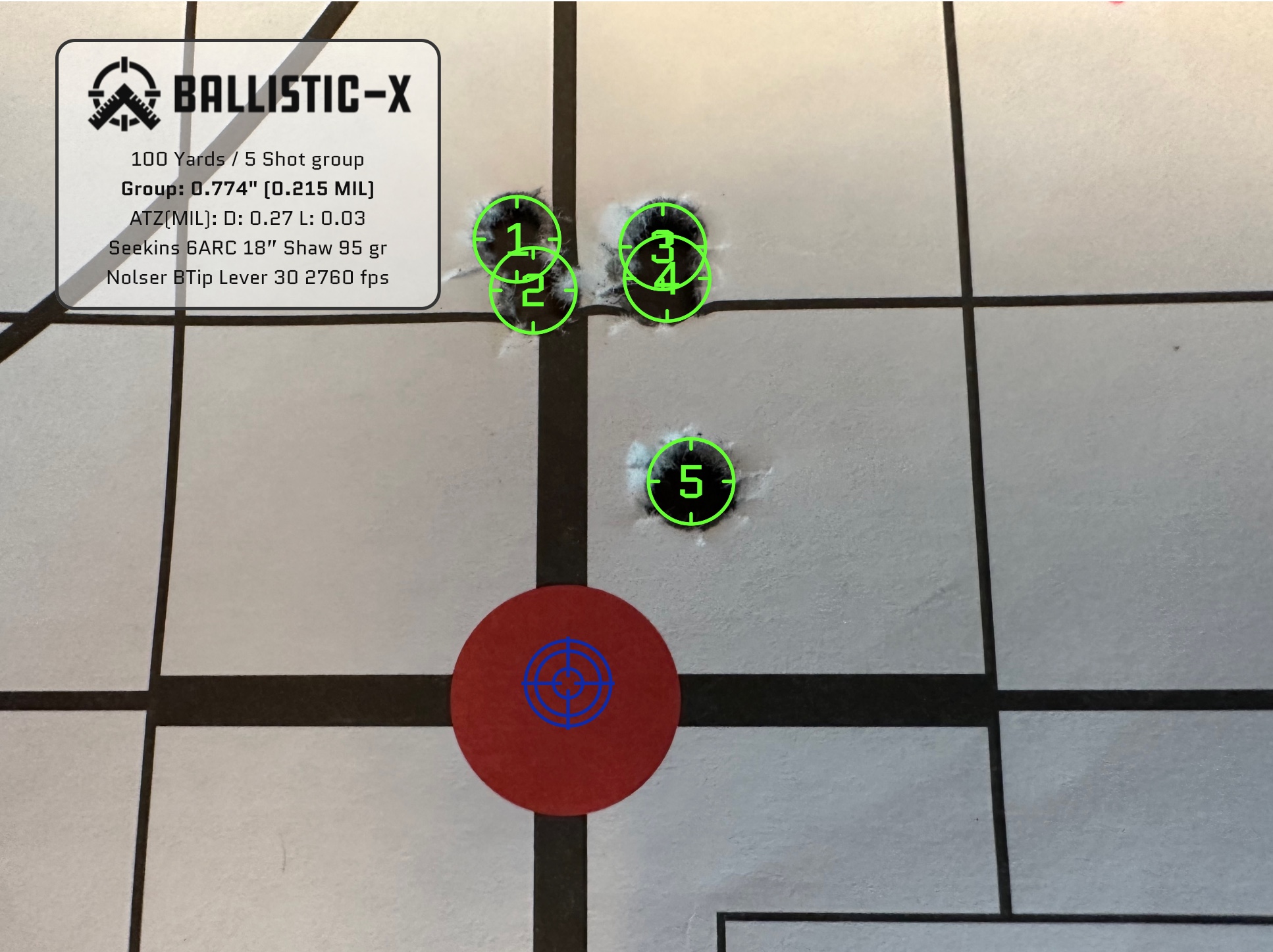

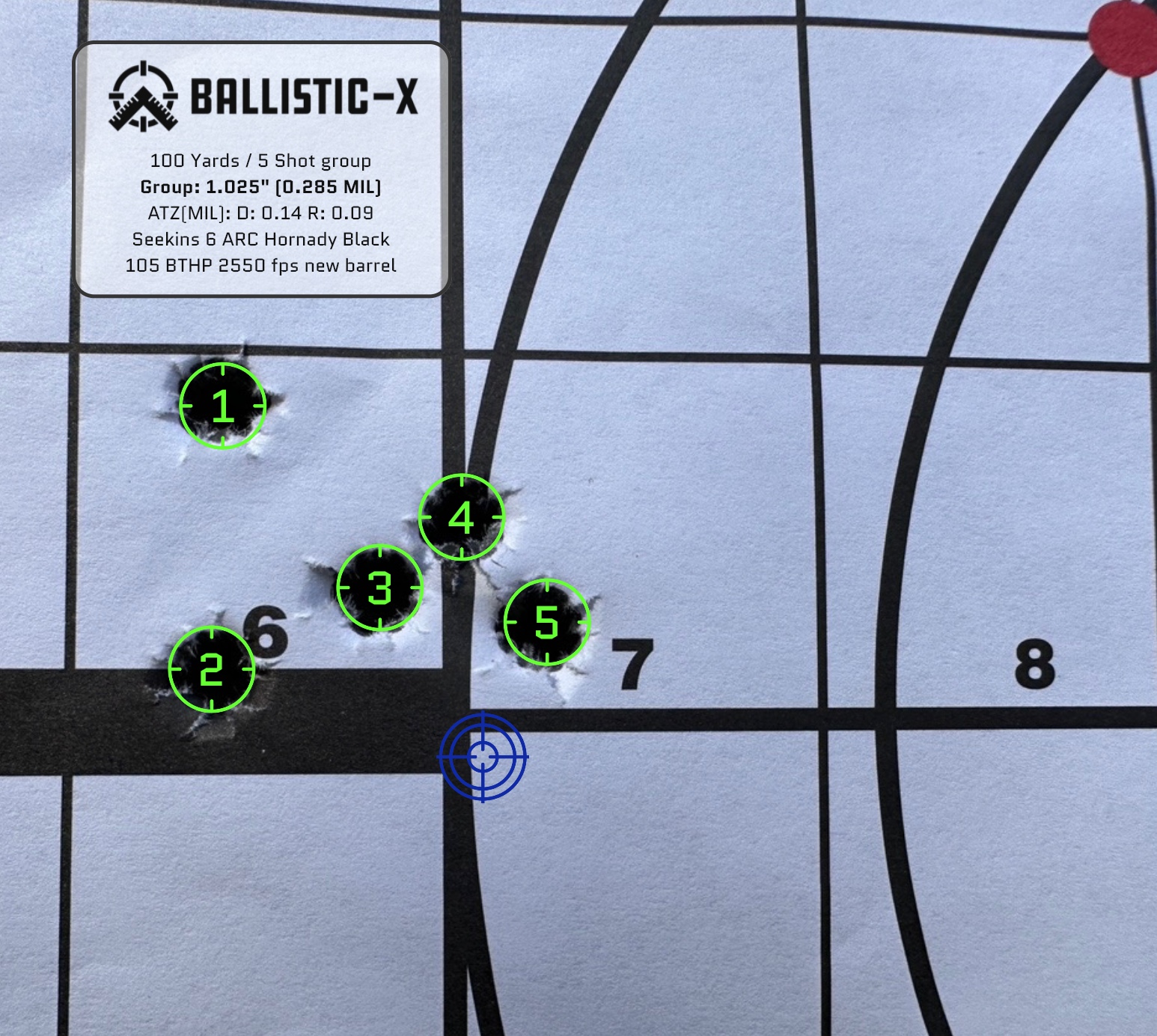

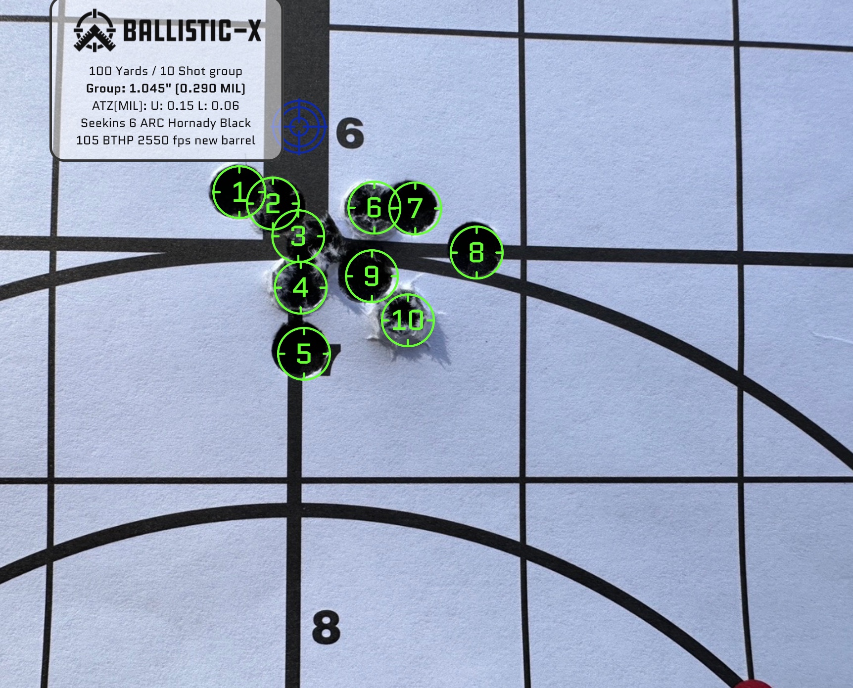

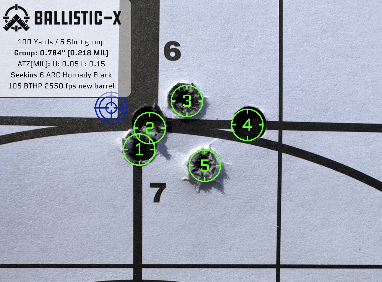

I picked up a Shaw SS 1:7.5” 18” long.
Seekins upper. Omega can. Magnetospeed V3 after 60 rds “break in”
3/21/23
60F 20% 30.34 in
Hornady Black 105 BTHP
2512, 2554, 2559, 2558, 2532,
2556, 2536, 2545, 2547, 2550
SD 13.9
(Pics below)

Sierra 95 gr TMK
Lever 30.0
Hornady brass x 1
BTO 1.6580
COL 1.4900
2705, 2011

Berger 95 gr VLD Hunter
Lever 30.0
Hornady brass x 1
BTO 1.6600
COL 1.4900
2740, 2689
Hornady 103 gr ELD-X
Lever 30.0
Hornady brass x 1
BTO 1.6730
COL 1.4900
2677

I bought a couple of 22" Shaw 6 ARC barrels for $210 each. I've only built one up so far and it's a great shooter with handloads. I've had quite a few 5 shot 100 yard groups in the .4 to .6 MOA range using Berger 109s. Factory ELD-M has run .7 to 1.5 and ELD-X is a bit worse. It's grouped at a bit over an MOA at 1000 yards with handloads. They also sell an 18".
18” Shaw SS rifle length gas
Ballistic-X-Export-2023-04-23 12:54:57.522064.jpg
Ballistic-X-Export-2023-04-23 12:52:47.132137.jpg
Ballistic-X-Export-2023-04-23 12:50:09.236533.jpg
Ballistic-X-Export-2023-04-23 12:47:27.638764.jpg
Reactions: TripleBull and JFR
Finally settled on a load of 29.4gr of lever, 2.245 COAL. Up to 2660 fps. My SD was between 3-6 fps and consistent .5 moa groups. Took it out to 700 yards and had consistent hits. The almost non existent recoil is a joy.

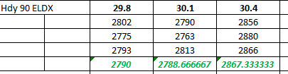

Has anyone messed with the 90gr ELD-X in the 6mm ARC yet? Or just the 103gr?
Caveats: Powder= LVR, brass= virgin Starline 6.5 Grendel converted, primer=CCI 400, CBTO/COAL= 1.655/2.167, barrel= 18" Ballistic Advantage, RLGS. This was pressure testing ONLY. The highest load shown is under Hornady's published MAX. No pressure signs or behavior was noted. These were rounds fired during the barrel break-in, within the first 150-200 rounds down the tube.
